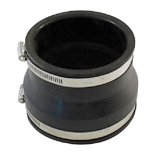

I am having one hell of a time finding an oval to round adapter.
Its a 3" round for sure, but the oval is a 2x4" which apparently just doesn't exist. Anyone find a proper adapter? Link to it?
erasedhammer
843
56
Maryland
Try the plumbing department at a hardware store. They have the rubber adapters that will fit.
You and I have very different hardware stores around us. Home depot and lowes around here have the crappiest selection of rubber adapters. Could barely find a normal circular one.
cucvrus
11,274
9,603
Jonestown Pennsylvania
Fernco makes all sorts of rubber reduction connections. I have ACE the friendly hardware place right down the road from me. They get me whatever I need. Keep in mind a cheap repair is just that. CHEAP. Good Luck.
