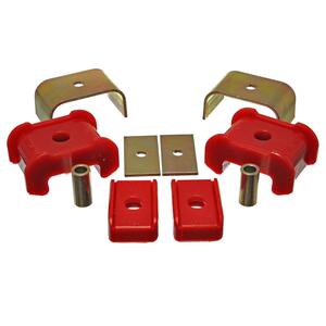

I think the mounts are similar to that of a 350 block if I remember correctly? I bought the Energy Suspension 31116R mounts. 31106R for the transmission and 34116R for the body.
Please note, I did not use them yet, but I came up with these part numbers after intensive research on this forum. The R in the partnumber stand for red, they also have B for black. I figured using the red ones it's easier to see and visually inspect them once mounted.

The truth be told the correct Energy Suspension motor mount inserts for all GM CUCV's are for a 1983 350 gas motor on the pick up and K5. 3.116G is the Energy Suspension part number.
OK that this as a word of advise. If you needed to bend the fitting on the fuel pump to get the hose on. That vehicle needs motor mounts or Energy Suspension motor mount inserts. Take my word for it. You can probably see where the fuel line was laying on the frame and it made a mark in the paint. Change the motor mounts. If the motor flexes it will cut the fuel line. It will wear a small hole in it and suck air. I learned this last April while wheeling at Rausch Creek. I changed the motor mounts before I went and the night before the truck shut off while idling in the parking lot. it seemed strange but I ignored it. The next day the trouble got worse and worse. I have used the Energy Suspension Autozone part number 353700. 3.116G is the Energy Suspension part number. Get 2 short 5/16" bolts and nuts. It beats the wire ties they give you to use to install the inserts. They work but the short bolts are 99% easier and better. Good Luck. Do as you wish. I just put a pair in a plow truck last week. The Jersey Indian. Thanks for looking.
