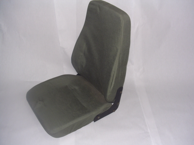

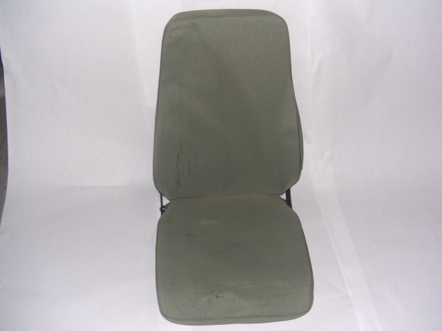

So I just drove my M35a2 250 miles to drop it off at its destination. 6 hours in the saddle. During the last hour or two of the drive, my thoughts were primarily clouded with ways to make the truck more comfortable.
The springer seat isn't horrible really, but it also is not what I would call comfortable. I equate it to driving a truck from a park bench. I'd like to keep the springer base, and put a HMMWV or A3 seat right on it. Has anyone done this, and can report back on improved comfort level or space to move around?
I'd like to put one of these right on the spring base....
I would also like to cut the spring, so it drops the seat down an inch or so, so I am not staring at the wiper motor the whole time.

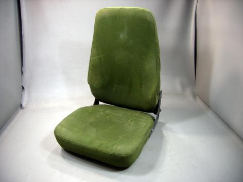

I am about to do it-I have a complete M44A3 drivers seat in mine and I really like it. I moved the spring ride over to the passenger side and I am about to replace it with an A3 seat on the spring ride base.
Will have to build a sub-mount to adapt the A3/HMMWV seat to the spring ride base tracks.

I did this on mine awhile back and besides putting 11X20's on it was the best mod I have done. The truck no longer leaves me bowed-up on long drives. I used the HMMWV driver seat and mount on drivers side and mounted the commanders seat on a springer base on Pass side. #21 seatmod 003.jpg The HMMWV drivers base is not a springer but as a lot of adjustment, up & down fore & aft, started with the springer base on driver side but like the ride better with HMMWV base so moved it to pass side as shown.
