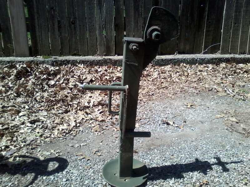

Hi All,
The screw jack on my M116A3 trailer’s front landing leg has recently gotten harder to turn. I’m betting it needs some grease.
The technical manual says to remove the top plate and fill with grease.
What kind of grease works well for applications like this? Any tips on maintaining these?
Thanks!

grease type doesn't matter as much as just having grease in it.
Pretty much any decently thick grease that will stay in the gearing is good, such as any NLGI 2 grease.

Got some of this Lucas Red “N” Tacky grease that matches our specs.
This thread has good photos of the inner workings of the landing leg jack.
https://www.steelsoldiers.com/threads/m116a3-jack-leg-repair.194814/
By packing grease in the top, it’s easy to see how the gears get lubricated. But will the grease make its way to the threads on the main screw, and the square “nut” that moves the leg up and down? I suspect that’s where the friction is.

It was a beautiful 65°F day so I decided to spend a couple hours doing trailer maintenance.
Today’s job: grease the tongue jack!
The jack had a few solidified clumps of former grease, but otherwise was completely devoid of lubrication. Probably the last time it was greased was at the factory or when it was in use by the military. I learned how to disassemble the unit and filled it with Lucas’ Red & Tacky. That grease is compatible with what was in there originally.
It works flawlessly now. Raising the trailer tongue up is incredibly easy now.
