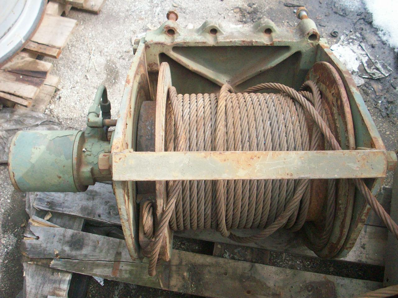

i wanna put a hydraulic winch on my m35 any ideas where i can get a pto that i can mount a hydraulic pump to

i have two 20,000 lb hydraulic winches one on the front and one on the rear just trying to figure out the easiest way to run a hydraulic pump off of a pto

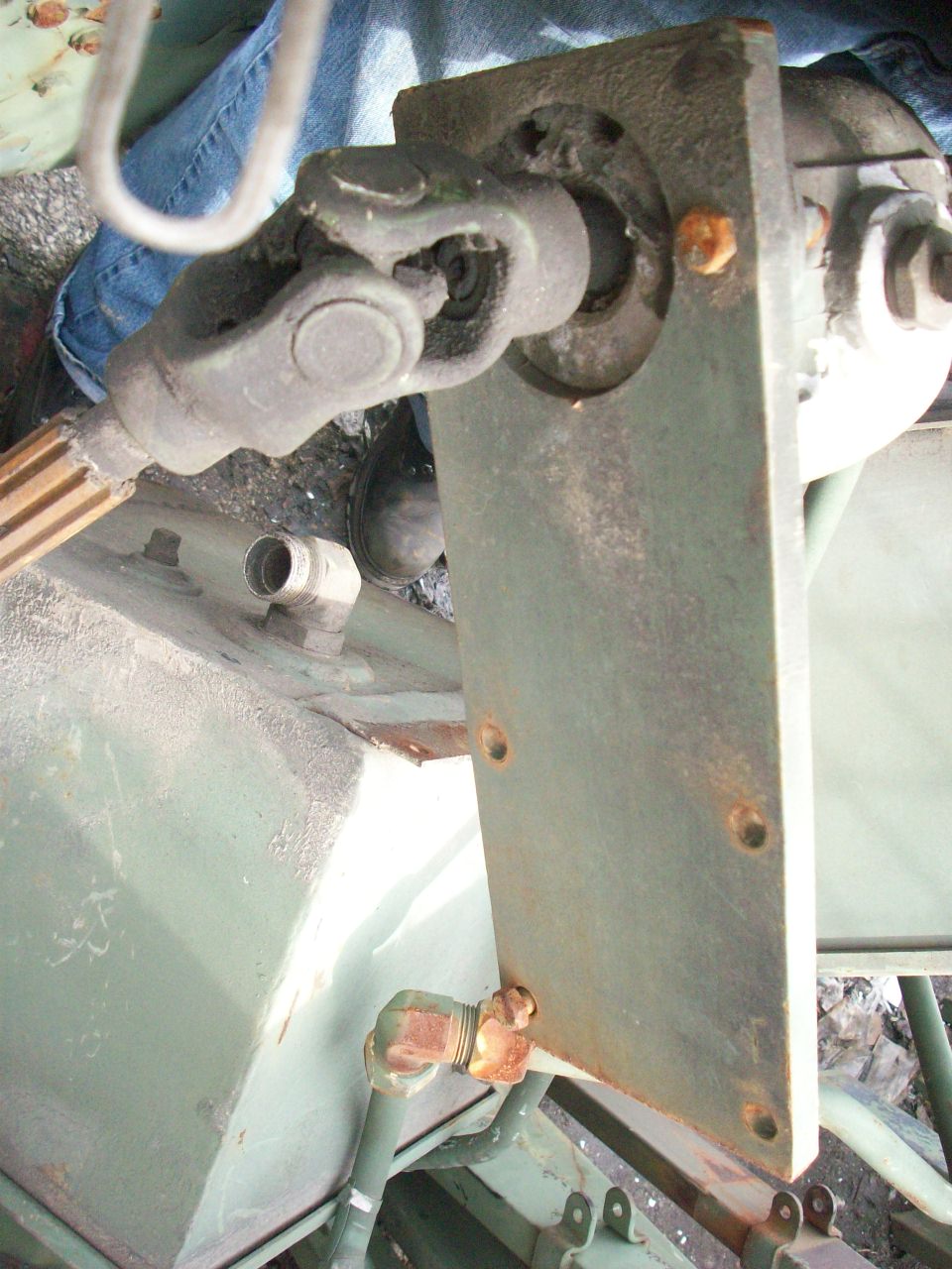

Here's some pics of my hyd pump running off of a transfer case PTO.
I'm getting ready to install a hyd pump off of a trans PTO for my uncle. The problem is, the output is facing the wrong way. To get around this (and not wanting to buy a dual output), I'm going to use a chain driving a jackshaft that will send the output beside the PTO and toward the back.
