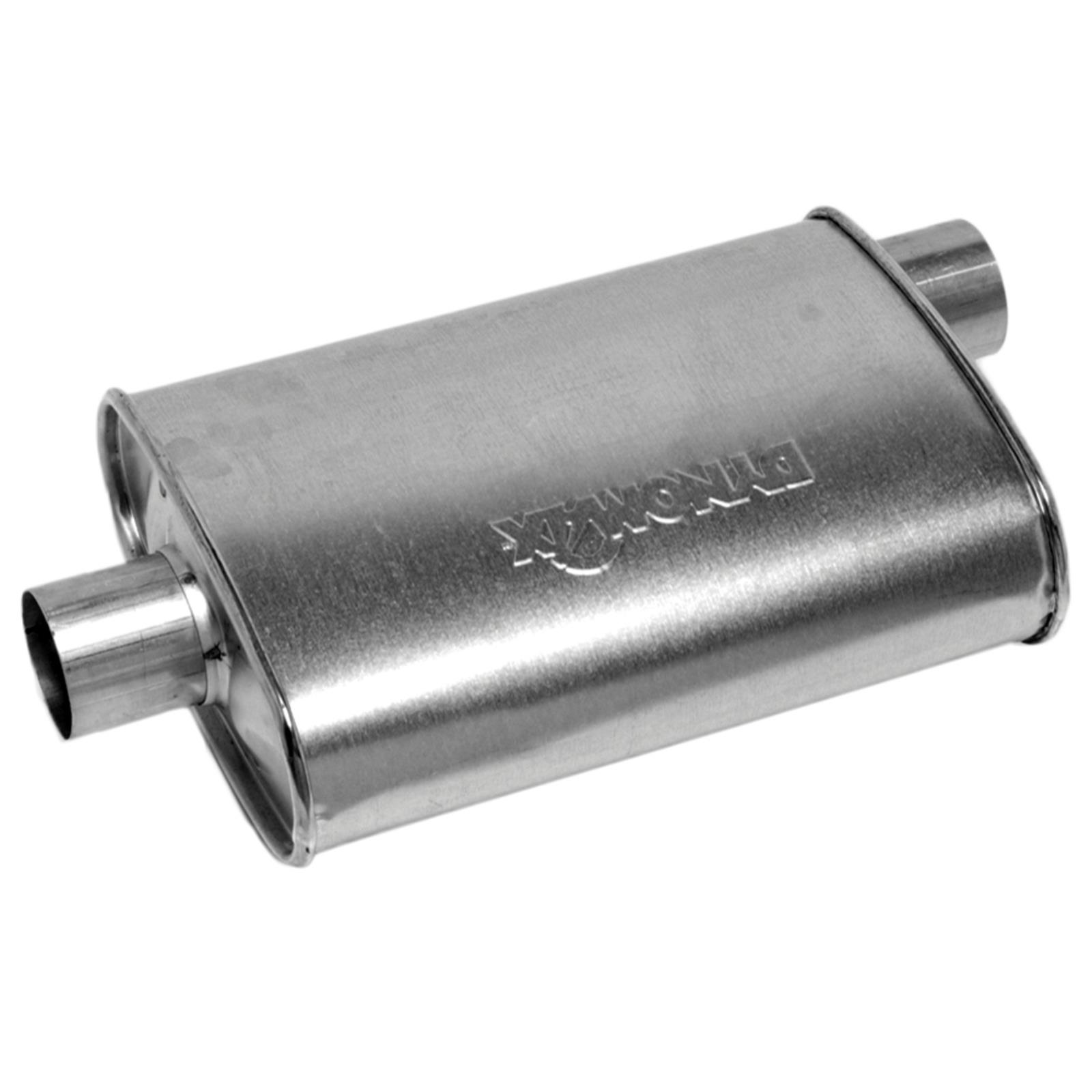

The exhaust system on my M1009 is rotten and I've been exploring options.
I see Summit do what looks like a good kit [WLK-89005], thinking to pair with a couple of Dynomax Super Turbo Mufflers [WLK-17731].
Anyone fitted an 89005 kit? How good a match for the headers/collectors?
I don't mind a bit of fine tuning as long as its not way out! Its gonna be shipped over to the UK.

One issue I see with the system you have shown is it's for header back. If you have the 6.2 with stock manifolds you want a manifold back system.
