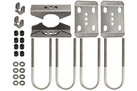

First thing I'm working on is replacing the axle with another axle that has a similar load capacity using the 8x6.5 lug pattern. I decided to go with a 14 bolt full float axle. It has an 8k lb capacity and was cheap, $100. I plan on removing the carrier, ring and pinion and welding on new spring perches to match the width of the m105 leafs. The overall weight gutted, is going to be a whole lot less than the Rockwell axle that the trailer was fitted with. Tires will be 35" BFG all terrains wrapped around H2 alloy wheels. These are also a lot lighter than the military wheels and tires, plus helps lower the trailer several inches.

Here it is bolted to the leafs/trailer. I purchased the 14 bolt simple swap kit from ruffstuff specialites and requested to have the 13" long ubolts. Rather than the 10" that comes standard with the kit. Again, I wanted to keep the leafs and overload spring to retain the load capacity. Hoping to have it back on the ground with wheels tomorrow. After that, I'll deal with the trailer harness and integrate a 7 pin setup.
