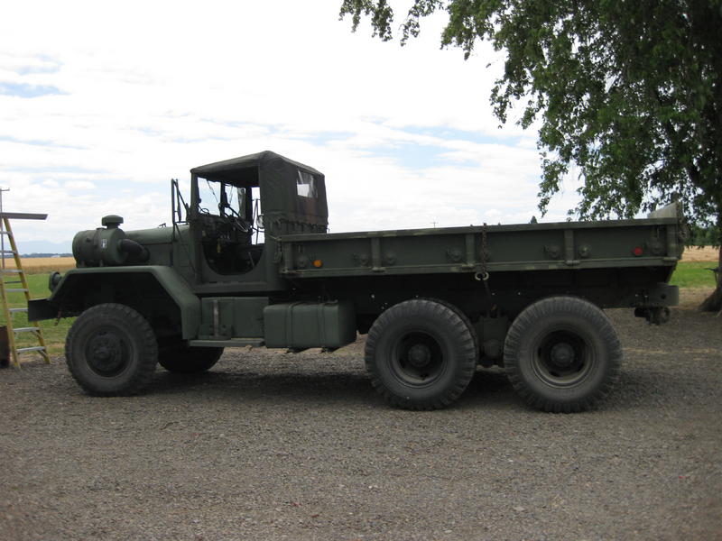

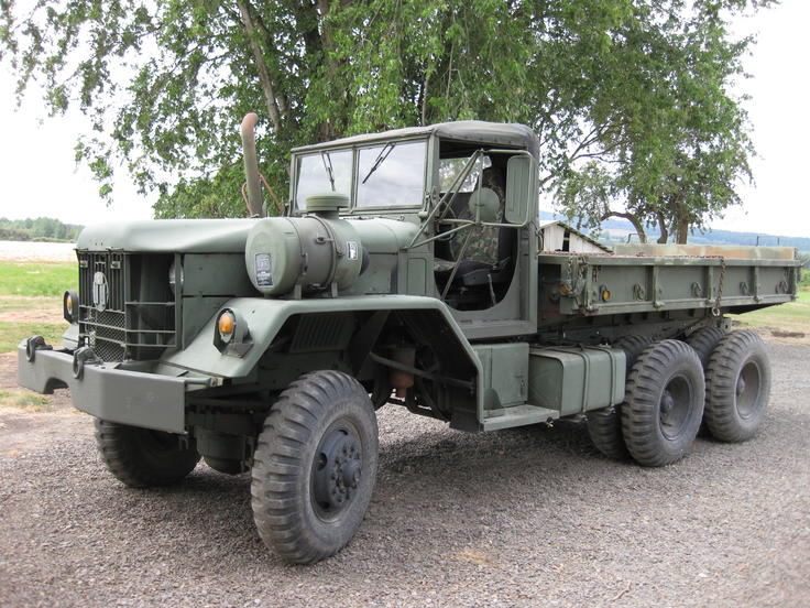

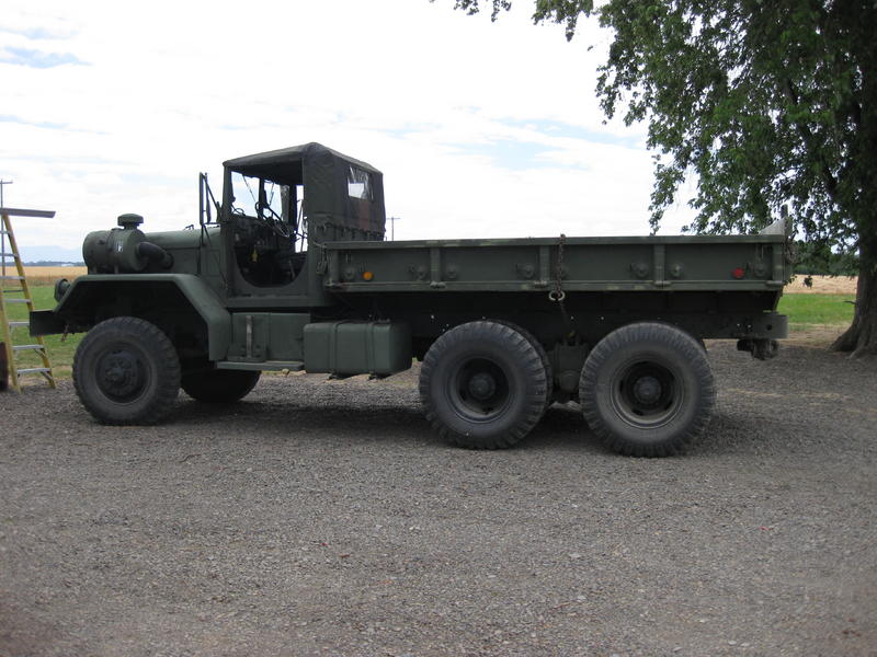

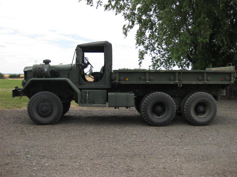

I have been in the process of putting a Deuce C bed on my M818. It is on and I have a few bolts in it, but I still need to move the rear bed mounts on the frame forward. Also I still have to mount the mud flaps. Then she is ready to be painted.

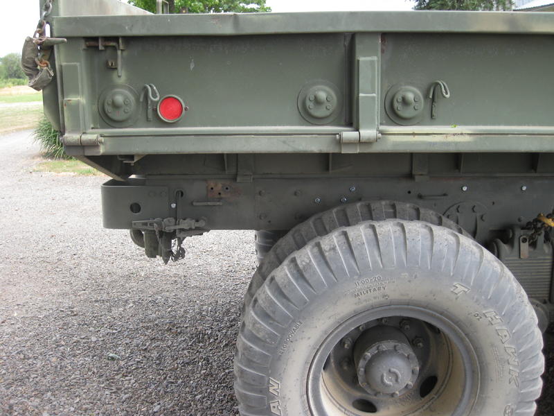

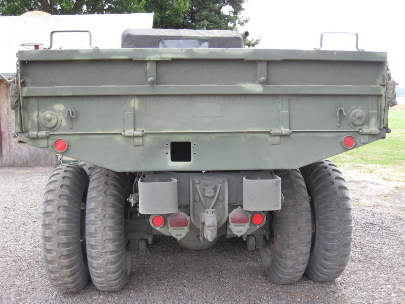

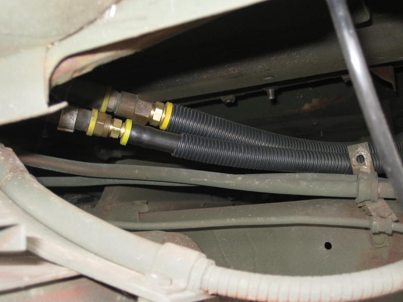

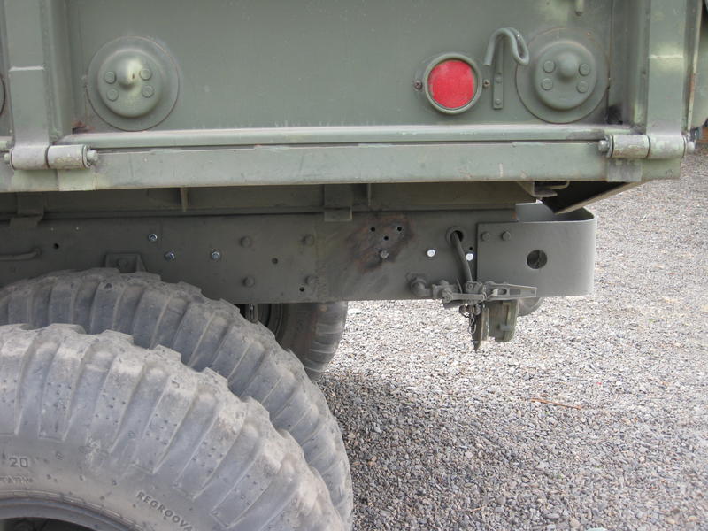

I did not want to cut the bed down, so I extended my frame 27.5 inches. I actually wanted the bumperetts to stick out more than the factory ones did from the bed. I also wanted to keep the distance between the cab and the bed rail to a minimum. I used our deuce for reference. I used the back frame section from a M813 that was being scrapped. I extended my air lines and lights to look original. Here are some pics

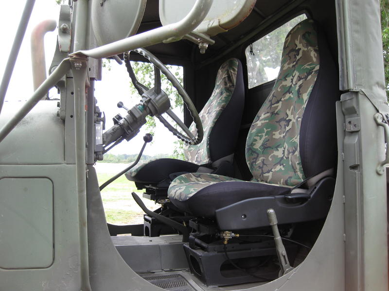

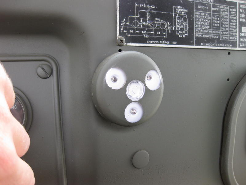

I installed dual Bostrom air ride seat bases. The seats are out of a Saturn sedan and the seat covers are from the internet. I also installed a 12v dome light and accessory outlet. I will post pics of the dome light next.

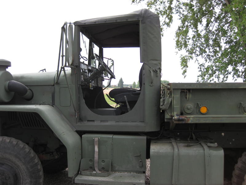

Thanks! I also just remembered that I had to re route the fuel lines for the passenger fule tank too. I will try to get a pic of what I did.

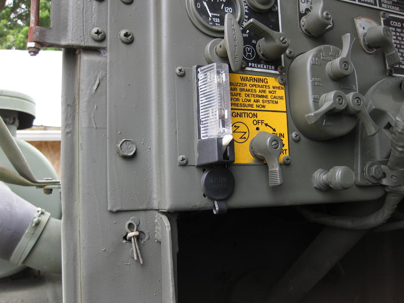

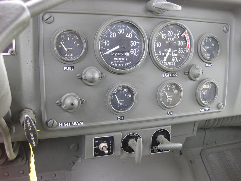

The light on the drivers side is the 12v one with the 12v outlet under it. The other one is just a batt. operated blue led light.
The third pic is just to show off the paint job of the dash. The original fuel lines were copper and were in the way. So I went to fuel hose and re routed them so that they were out of the way and wrapped them in hose loom to make them last even longer.

Thanks I took my time and did this right. I do not plan on towing much with the pintle so I did not cope the frames at a 45 or anything, I just butt welded with 100% penetration. Plus cover pass. Fish plated the inside and still used the original inner frame supports and bolted them to the actual truck frame. It should hold just fine. I try hard to do good quality work. Its nice to hear something like this.
Once the mud flaps are on I was thinking to move the tail lights to them, or a support somewhere out there. I cannot put them on the side of the frame like a cargo because they hit the glad hands. Was thinking of moving them only to install a under frame hitch.
