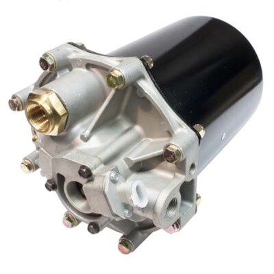

The rear drive shaft snapped and took out my air dryer with it. Being the ADHD, ready to fix it now kind of guy, I jumped on purchasing one on ebay before doing my due diligence... I bought the HORTON 19324 995017. I am curious if anyone knows if this will be a somewhat direct replacement without needing to modify a bunch of stuff or having to purchase more parts to install it? Thank you in Advance.

Armada AD9 is common commercial replacement with only having to drill holes in the plate. They are around $200 new
Some folks use the purest air system from haldex since they were surplus units.
The dryer you bought isn't a common replacement regardless of what the ebay listing says.

Here is pictures of both but from the previous reply it sounds like the one I got is a no go.

Thank you for the insight! So I basically bought a big paper weight huh? Well that’s a bummer. I wish I would have posted here first before buying.
Yes pretty much. Return it. Especially for what you paid for it.

Not sure if they will accept a return or not as it was my screw up. Luckily I only paid $90 for it and that why I think I felt the need to jump on buying it because it was like $350 less than the other listings. But I did use the link you posted and I purchased that AD-9. Once again, thank you for your help.
