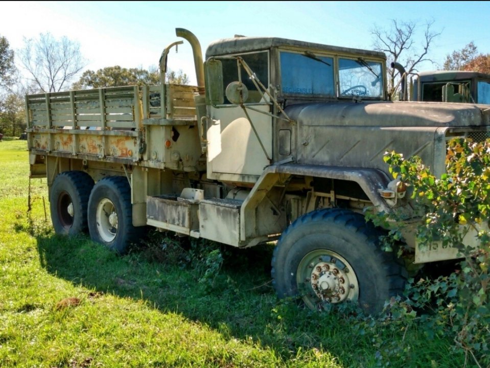

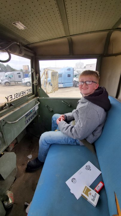

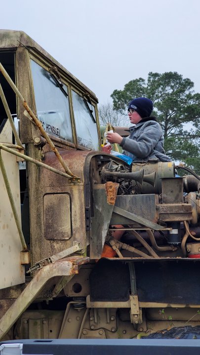

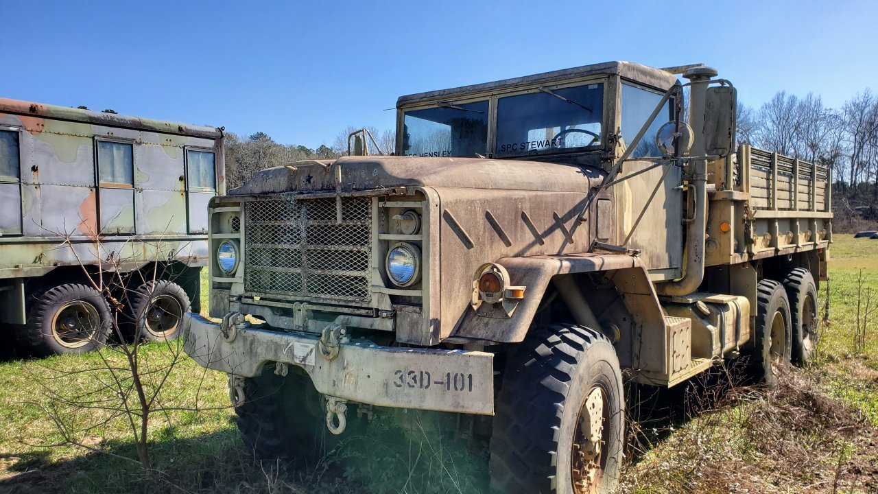

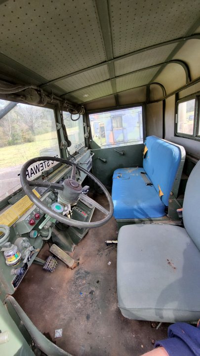

When I went to look at her, this is the shape she was in:
Kind of rough, but after my initial "Holy crap I've never messed with anything that big!" I saw her potential, took some photos and went home to discuss it with my sweet lady.
After showing her the pics, she said "LETS #*&$ING DO THAT!" (I'm paraphrasing).
So after negotiating a price for everything, I had to wait until I came in from offshore to pull the trigger on recovery.
Because I have the patience of a seven year old, we went to recover her the first available day I had when I came in... which was February 13, 2021... a day that had a HIGH temp of 30°. One of my best friends, my sweet lady and my son all loaded up in my truck with tools, antifreeze, towstraps and other necessities (like a thermos full of hot coffee) at 0500 in the morning I order to be at the truck by daylight.

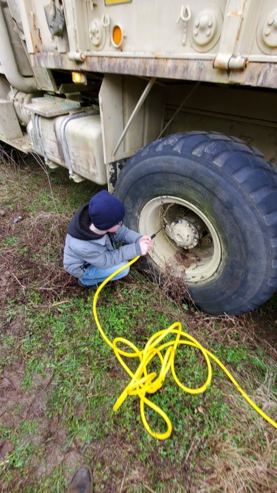

Once there, we got busy cleaning windows, installing batteries and airing up tires...
Next came the moment of truth... the fuel had been sitting as long as the truck had, I bought 2 new type 31 batteries.... will she start and get home under her own power or am I gonna shell out for a wrecker?

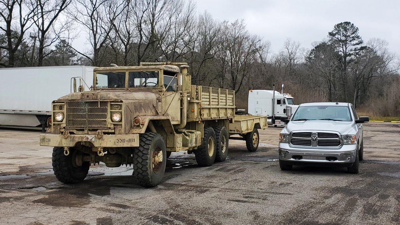

After getting her started, pre-tripping send ensuring everything was good, it was time to head home...

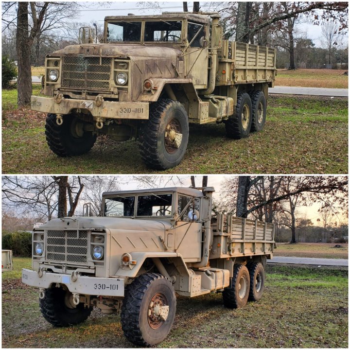

Once home, I **needed** to wash her..

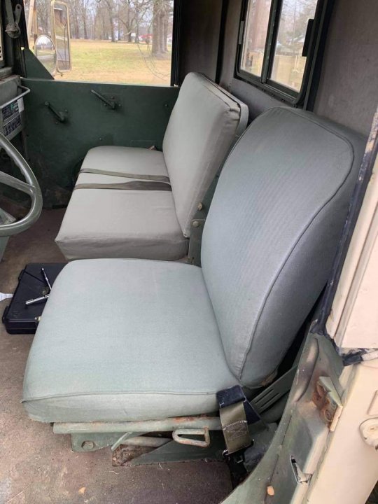

The first item of business was re-covering the seats. My sweet lady took the lead on this and bought the material, used the old fabric and created patterns and worked her magic..

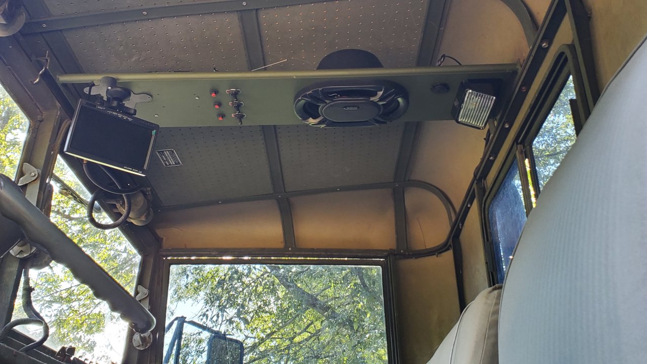

Then for my birthday/father's day, she bought me the overhead console from Those Military Guys... running all of the camera cable, drilling holes and installation took about 6 hours...
Overhead console

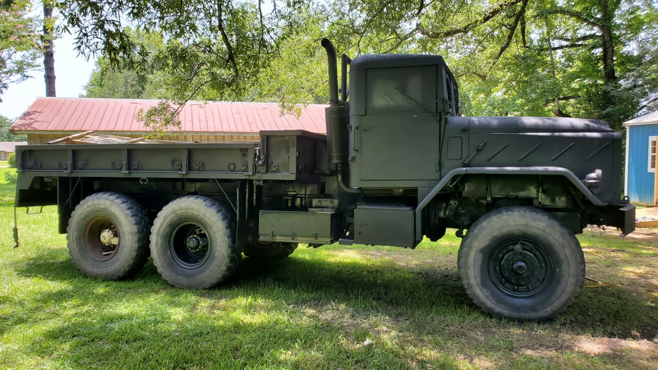

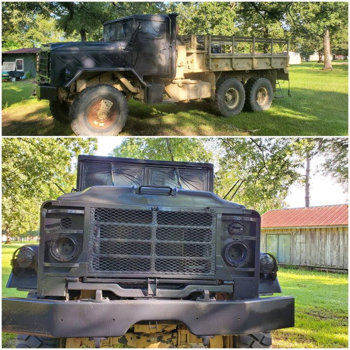

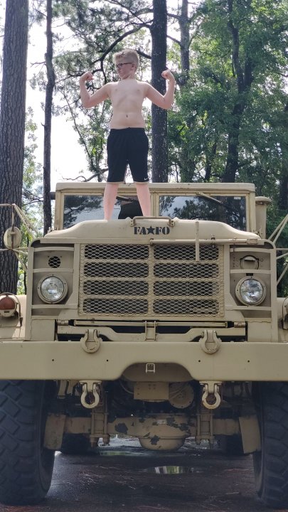

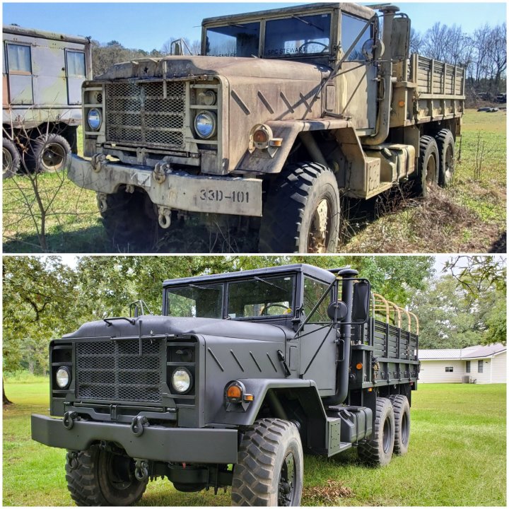

About a month later, we decided to paint her matte black...
Cleaning, prep and paint took about three 10 hour days...
Before and after paint:

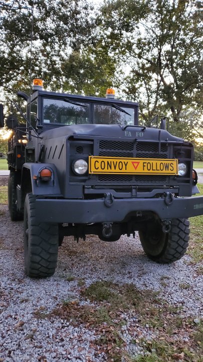

At this point, I realized I needed to cool the cab a little, so I tinted the windows just a *smidge*

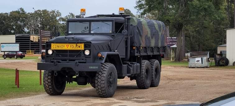

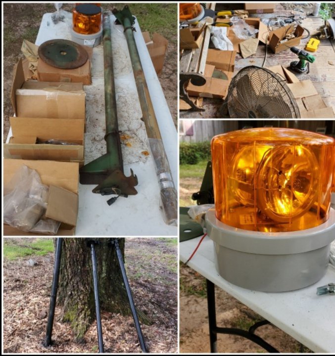

Convoy lights... whew... where do I begin!
I got the convoy lights and of course there were no directions..... so after fighting it for a while, I decided to wire it my own way.... (which means a lot of phone calls and cussing...)
I took the third 12vdc toggle on the overhead console and rewired it to the batteries so that it was now 24vdc. I then ran the relay for the lights and lights off of it behind the breaker so it was surge proteced.
After installation...

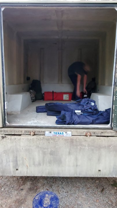

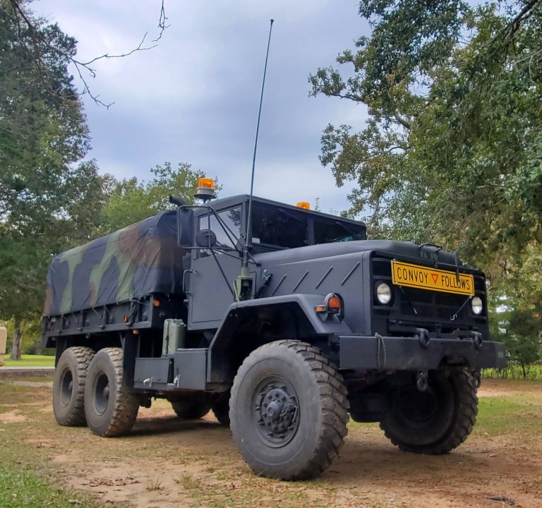

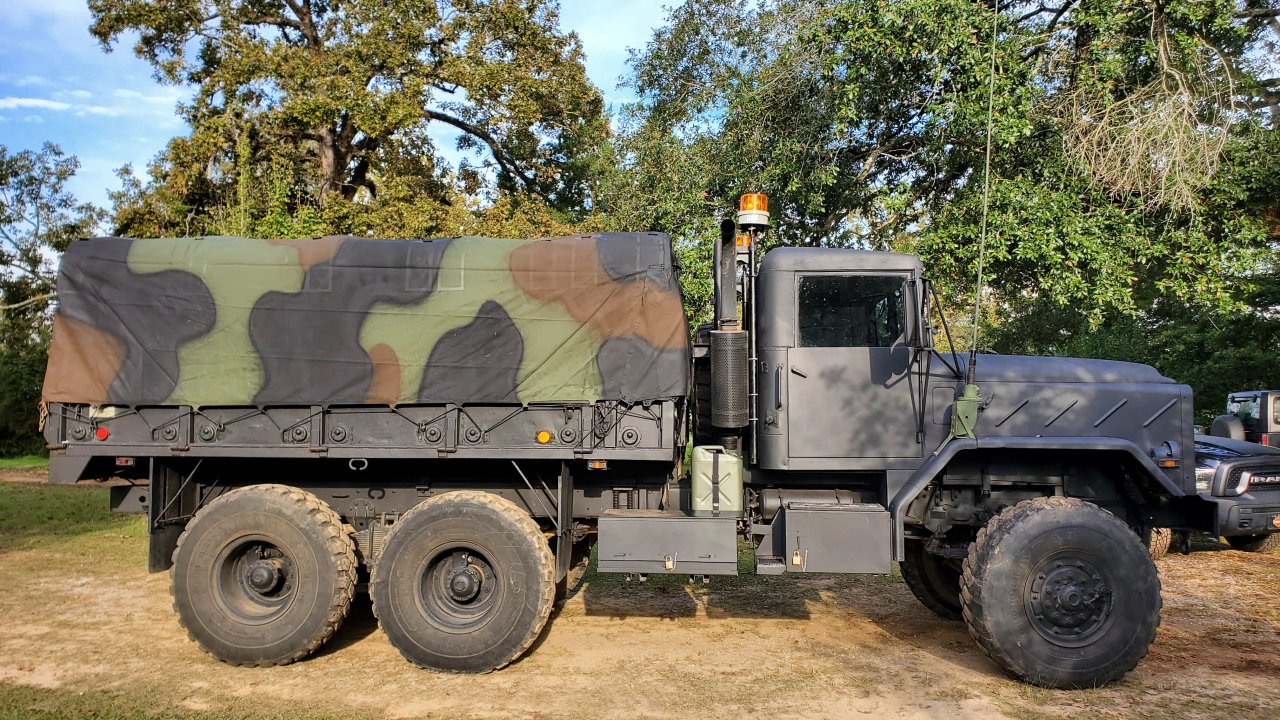

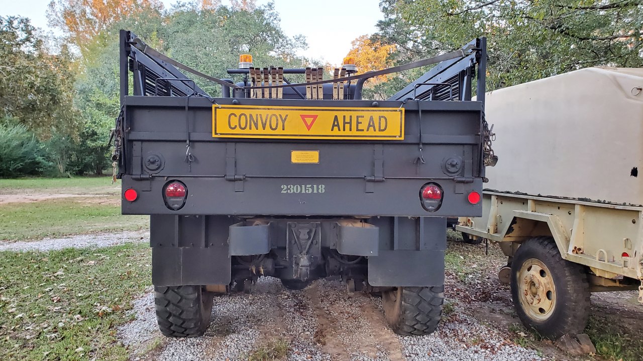

In the meantime, I was looking for a canvas top for my M105 trailer when I found out @fuzzytoaster had something called a "CBC" shelter... a short trip to Dallas later....
Shortly thereafter, one of our members was moving and had a set of "CONVOY" banners available so....
After which I was alerted that I could get a NOS cargo cover and bows for a reasonable price from @Csm Davis so I made a quick trip to Mississippi...

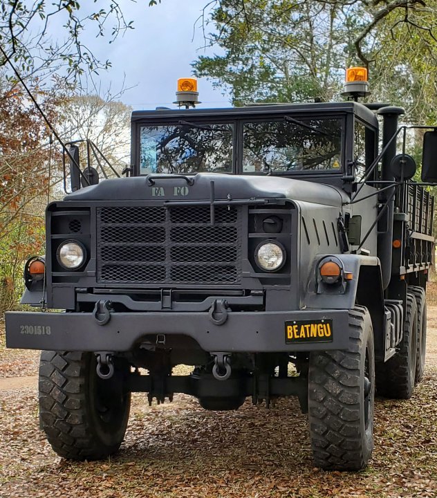

So..... here she is; it took about 10 months of work to change her from a standard tan M923A2 to "Big Bertha"...... while not "done".... I'm happy with where she is...

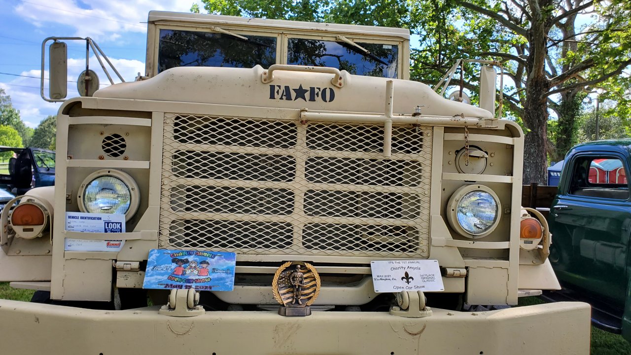

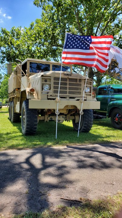

Various camping trips and car shows...
This was the "Charity Angel's" car show to benefit children with autism.
Bertha picked up "Best Original", "Best Military" and "Top 25"

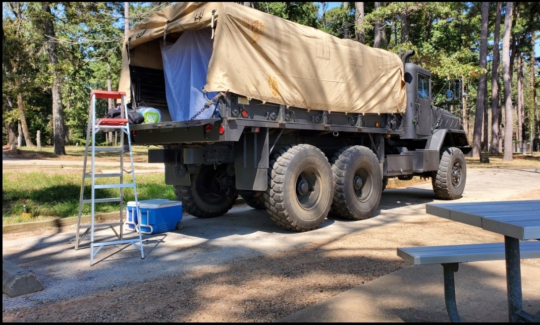

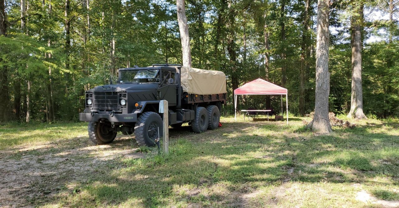

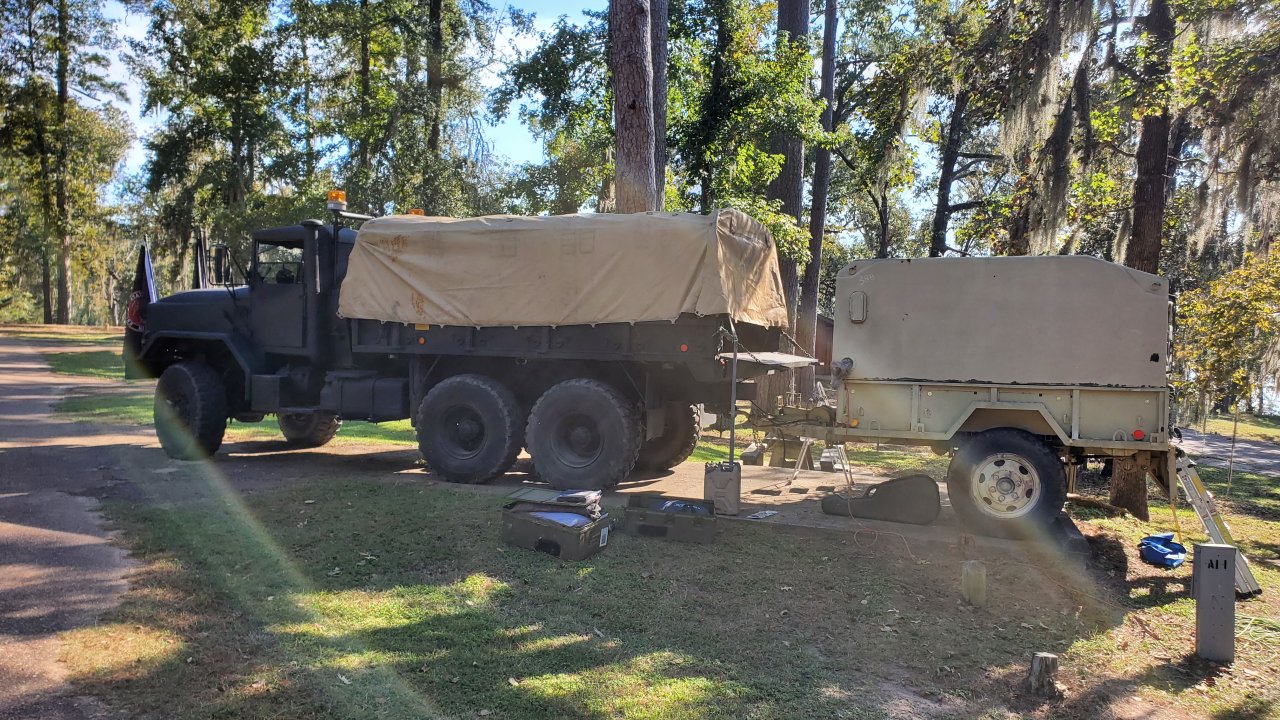

Camping:

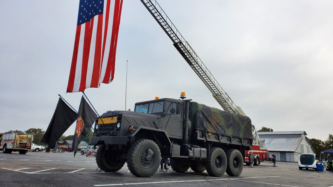

Vets helping Vets car show... Bertha picked up the people's choice award!

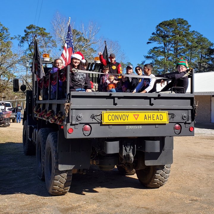

The Deville, La Christmas parade...

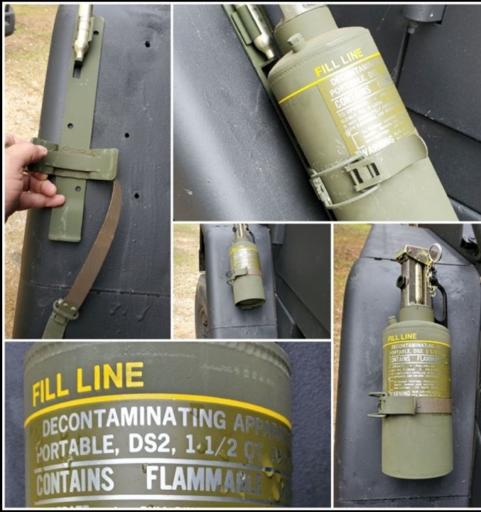

A decontamination unit on the front left fender.

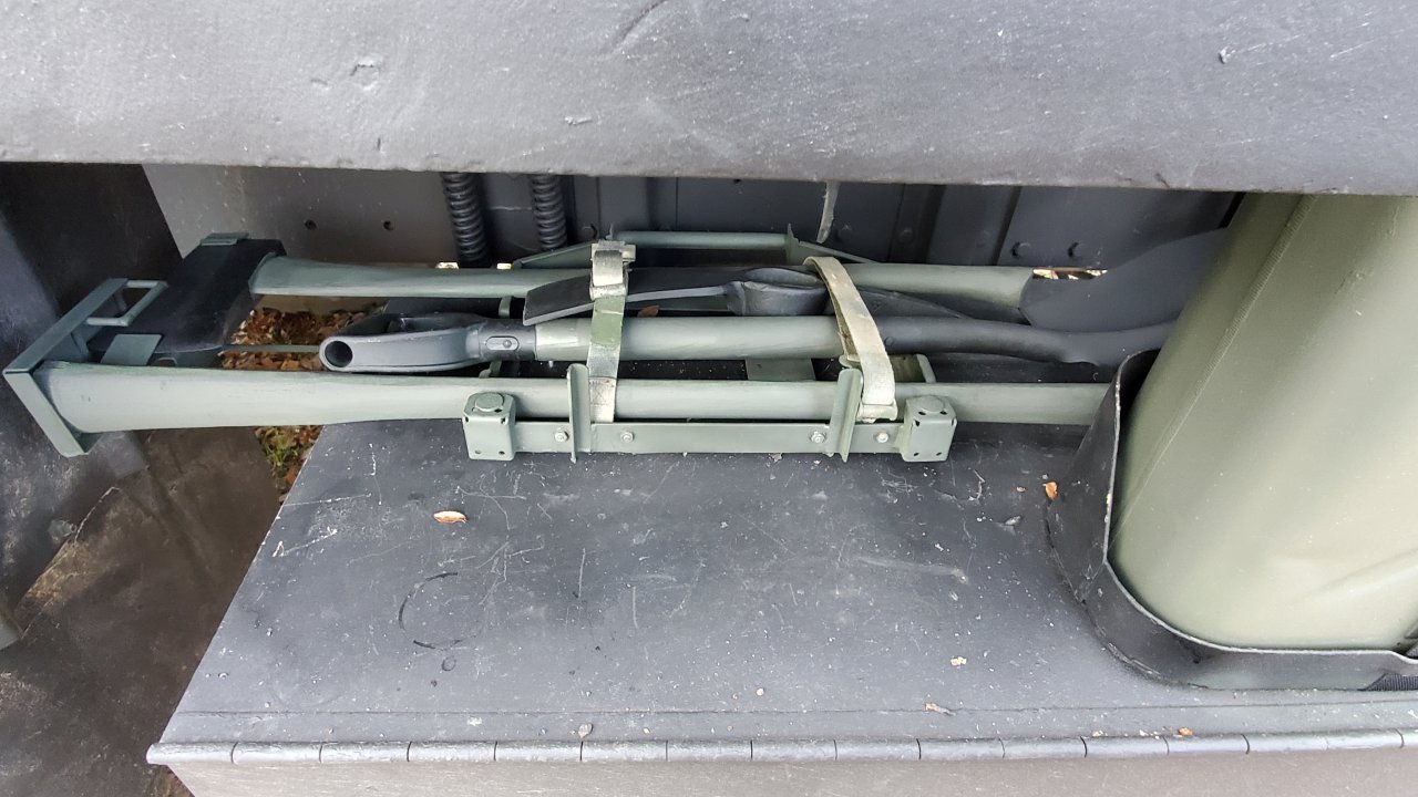

A pioneer tool kit mounted behind the Jerry can

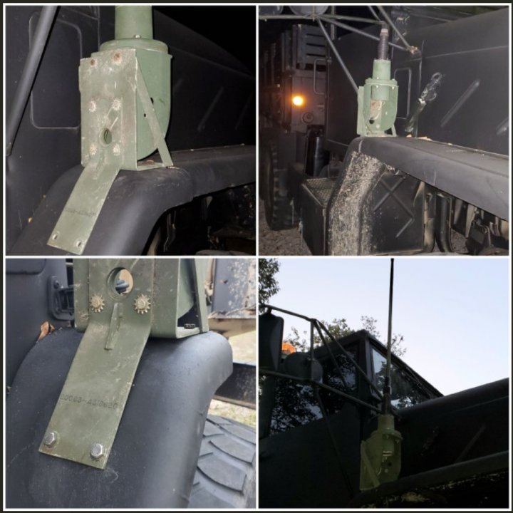

Of course she needed an antenna!
And looking all beautiful!

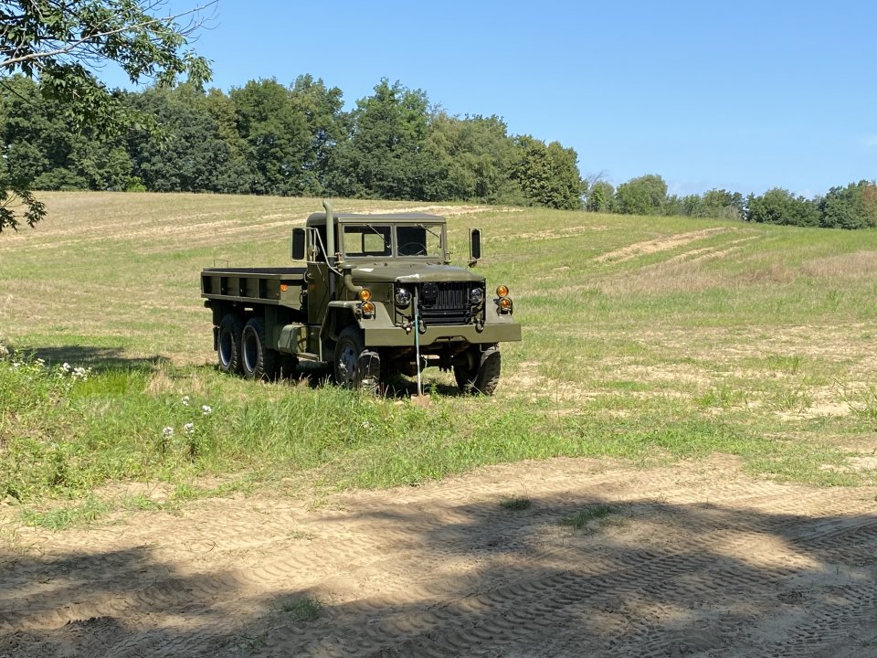

Here's my old girl when I laid on eyes on her. Looking sad and forgotten, tires sinking in the sand, lichen-covered and badly peeling paint. But even with all that I could see she had a lot of potential...
Having grown up in Lansing, Michigan I was ecstatic when I climbed into the cab and discovered she was actually a REO built in my hometown, just down the street from where my family lived. I took that to be a sign and immediately decided she would be joining the farm motor pool.
She's an early Deuce, built in 1952, and a great old girl who turns 70 years young this year!
She was procured by the "Navy Dept" according to the stamping on her dash plate so it would appear she was either a Navy or Marine truck originally. She was OD at birth and various shades of green since so probably not a Navy Deuce...but you never know.
She now has a 1986 D Turbo LDT under the hood and during my inspection I found the remains of the gasser exhaust bracket where it was torched off when she was converted from her original Gold Comet engine...
Amazingly, after a full mechanical inspection and fluid checks and some fresh diesel in her tank she fired right up and ran VERY well even after sitting for years since she was last run. No major leaks or other noticeable mechanical issues noted. Even her tires were in great shape and were all dated '03 or '04 so someone had shown the old girl some love in the previous few years before she was auctioned. She was in such good condition and all her systems were working so well that I had no concerns driving her the 200 miles back to the farm (of course with my well-stocked chase truck close behind - just in case). No drama of any kind on the recovery drive.
First order of business once she was at the farm was full filter and fluid changes all around, and a drain and clean of her fuel system. Even though she was running good and she easily made it home, I knew the fuel system was still a mess and I was not disappointed by the filters at the first change...Multi Fuel engines are amazingly capable at dealing with poor-quality fuels...

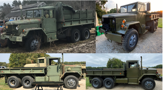

Here are some additional things that I've accomplished so far on my old girl...with some before and after pics.

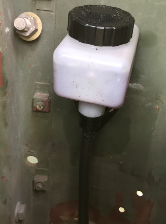

Remote brake reservoir - installed before the recovery drive to the farm:

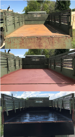

Bed is solid but had a lot of normal surface rust from good use over the years. Prep, red oxide primer and some coats of black low-gloss enamel (just painted in the pic so looks very glossy). Very durable combination:

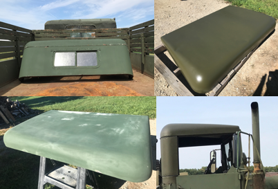

I picked up a hardtop in pretty good shape as well when I bought her to replace the worn-out soft top. Disassembled it, prepped it, knocked out a couple of the bigger dents, primed, painted and reassembled on the truck with new gaskets:

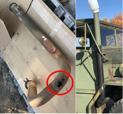

Typical Deuce J-pipe rust-out at the elbow. Replaced:

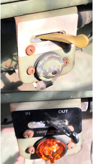

The air shift switch housing cracked and the whole assembly needed a refurb. So I replaced the switch, the unreadable plate and installed an amber lens that can be easily seen in full sun:

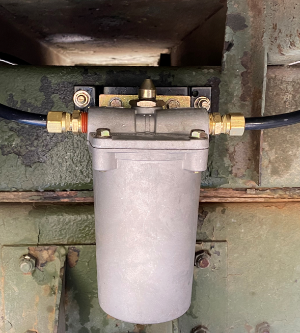

Alcohol air dryer plumbed in above the spare location as she is a Michigan girl and needs to be drivable in below freezing temps (Pioneer tool rack was removed):

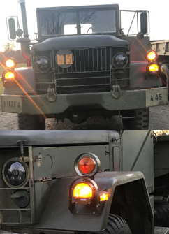

Lollipop front amber/rear red lights were added as turn signals and for better visibility to other drivers to the sides and rear. I converted the original marker lights to be constant-on parking lamps along with the headlights. I also added side marker lights at the same time as the lollipops:

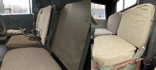

Combination of NOS and new-production seat covers all-around. I found some NOS driver and passenger backrest cushions:

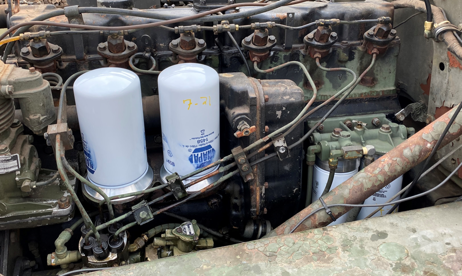

Spin-on conversions done for fuel and oil:
And, obviously, lots of time addressing the peeling paint and surface rust, prep, primer and coats of 23070 semi-gloss. It was her original color when she left the plant a few miles away from where she resides now. I added a little contrast by painting her grille and tow hooks black. She's not done yet, but I'm getting to it as time and weather allow:
