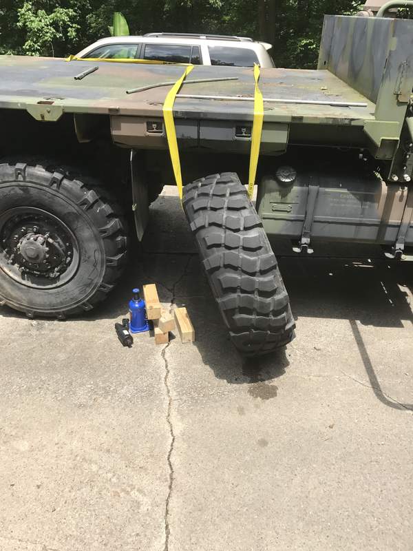

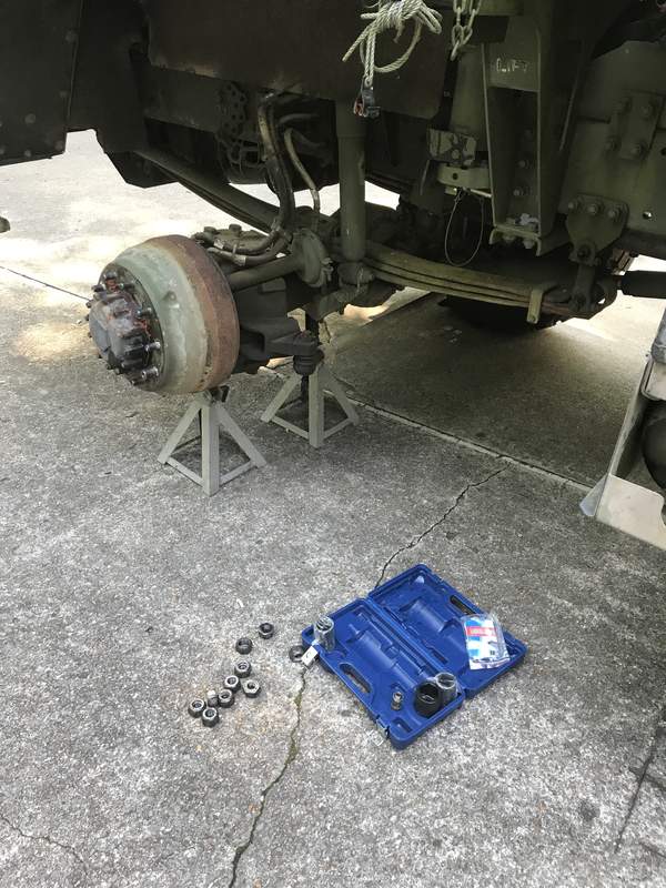

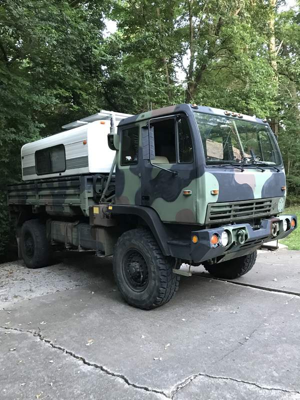

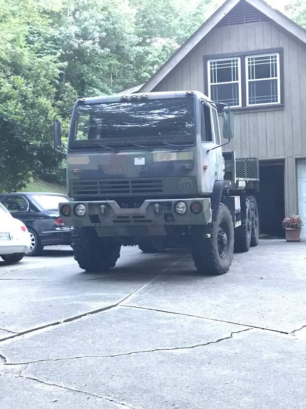

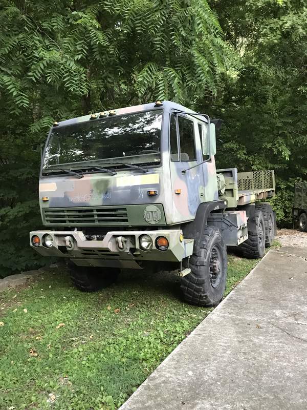

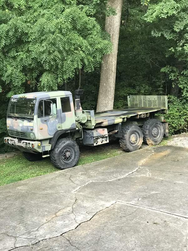

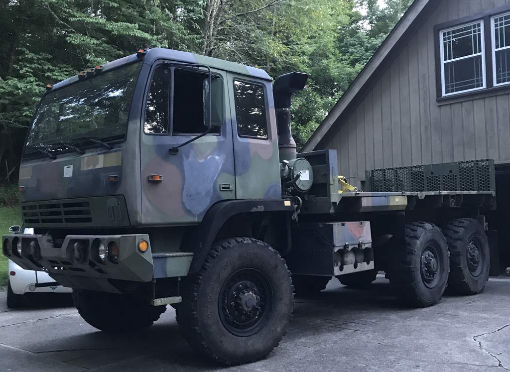

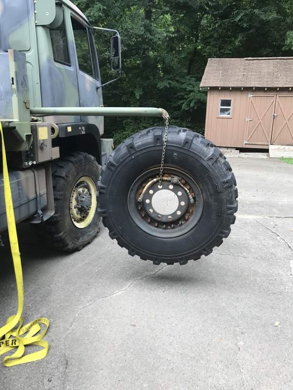

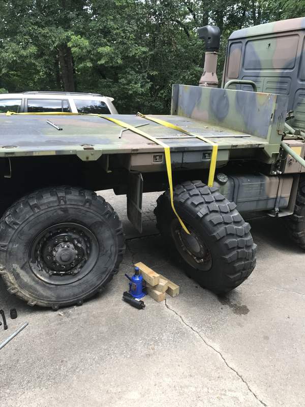

Success! We made it home safe this evening after a 60 mile recovery from a rural county Sheriffs Dept. I was assisted by our own tnmogger who drove over from the Knoxville area yesterday and camped overnight. He was a great asset in helping me check over the truck and change out a dry rotted tire. We had to use the spare from his M-1078 as my newly acquired M-1083 had a flat spare. The truck was running when we arrived, but we had to shut it down while checking over items like fluids, hubs, lights etc. and change tires. It would not restart on its own, but the Houston Co Sheriffs Dept kindly allowed us to use their HMMWV and slave cable. It was an enjoyable 45mph convoy home once we had everything ready.

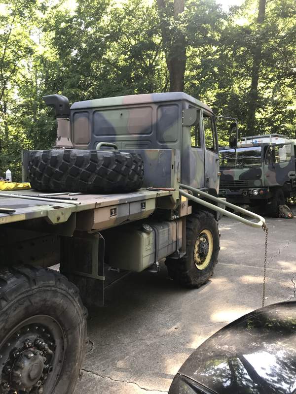

M-1083 home at last
And tnmogger's M-1078 with the assist.
We are planning to swap tires back again in the morning and maybe fix my flat spare. I will post a few more "post-recovery" updates tomorrow.

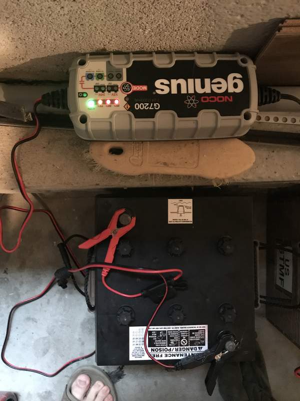

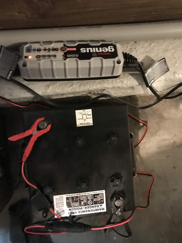

The NOCO Genius charger is on the batteries now via slave port, so hopefully it will start on its own in the morning.

Howdy,
I would suggest you use the NOCO Genius on each battery by itself. This way the battery will get whatever it will need to recover. After all batteries have been charged to green light individually, then use the 24 volt slave port to maintain them.

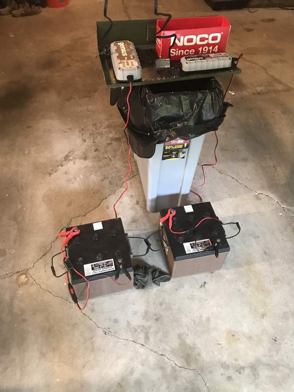

I'm going to wrap up this "recovery" thread with a few more updates. I will then move over to the FMTV section and start a thread on repairs, mods, updates, etc.
Battery update:

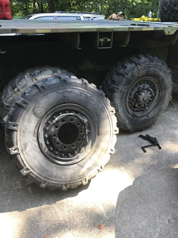

Noco through slave port was not a success. tnmogger helped me diagnose the two bats on the 24V (high) side were dead. We took them out and put them separately on NOCO chargers. One is "reviving" and one is apparently not repairable. I have them on the chargers still and will leave them overnight.
We then installed the two good batteries with one 12v and one behind to get 24v. The truck starts and runs well on these two as a temporary fix until I can get the others repaired or replaced.
Also I gave Bob back his spare before he had to leave.

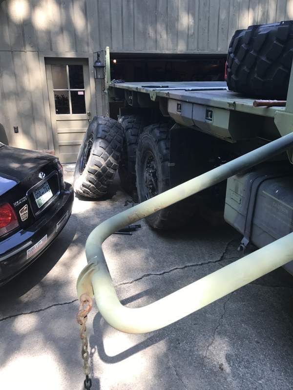

Then moved several tires around to put the best two on the front. Put the worst on the intermediate (middle) axle. And load the completely useless flat spare back into the spare rack.

As an update, one of the batteries came up and the other didn't make it...
Daybreak
2 Star Admiral
1,521
740
Va
Howdy,
Don't give up on the battery not coming back. Make sure you water levels are up and use the G7200 to go at it again.
and, if it really is low low on volts, you can leave it on the repair 13.6v setting for 2-3 hours and then go to the auto charge mode.
