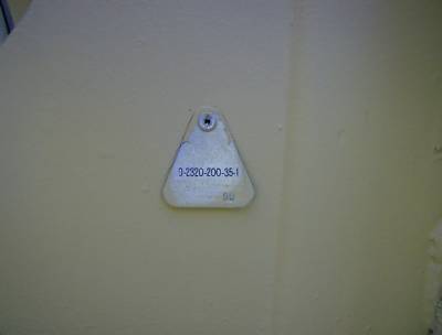

Riveted Triangular tag?
Wondering if anyone could tell me what this tag is for, I have been told that the M35A2 was redone in Utah in 1990 by the military its self and then a private company did an overhaul in 2009. Curious if this tag validates these statements any or if it has anything to do with that at all?

That is the MWO tag showing the truck has the seat belt upgrade.

I wondered about that but it didn't say MWO on it so I thought it might have been something to do with the rebuild. Thanks for the explanation.

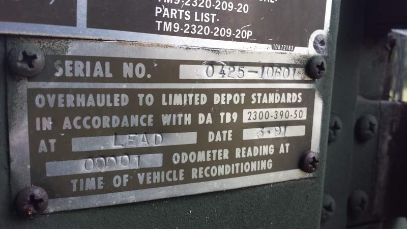

If a vehicle has really had a full blown "rebuild"* there will be a tag something like this on it somewhere:
*There are a lot of people who either erroneously believe or have an ulterior motive to proclaim; that their trucks have been "depot" rebuilt and a lot of times with nothing more to show for it than a truck with a "new" in 1987-1989 engine.
Unless they have documentation (i.e. paperwork) or some data tags (lie what I posted), I'd take it with a wheelbarrow of salt.
