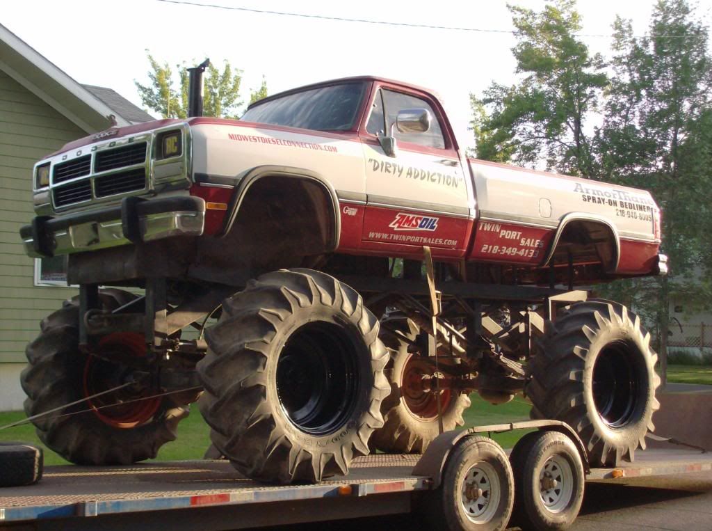

I run Rocks on the truck in my avatar and the main reason for not running them is the weight. The drum is 40 lbs and the backing plate with the shoes is 40 lbs, that's 160 lbs per axle! And yes they fill up with mud and that mud NEVER comes back out. If you are trying yo keep street legal it may be a godd idea to keep them but on a mud truck/trail truck a pinion brake setup is the best way to go.
I sell a bunch of Rockwells and I strip the brakes off before I even sell them, nobody wants them and it makes for a nice scrap pile for me :-D
