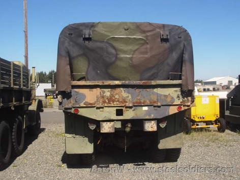

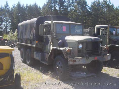

I used to feel cheated because I didn't have one that looked perfect then I realized I would be afraid to scratch it if were that purdy.
Now I just keep some rattle cans around with 383 OD.
AaronW
870
Napavine,WA USA
Re: RE:
Boatcarpenter said:
A little rough around the edges maybe, but otherwise a fine piece of equipment. Good going and good luck with the recovery :driver:
BC
I think this one looks more than a little rough. A little elbow grease and Krylon might go along way. I might even find a few spare parts on it.

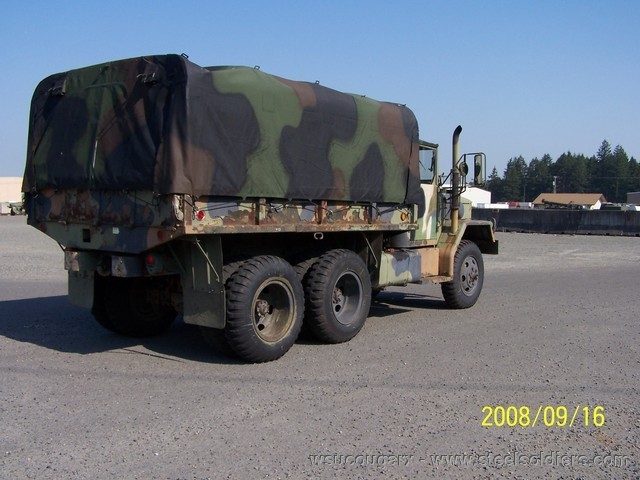

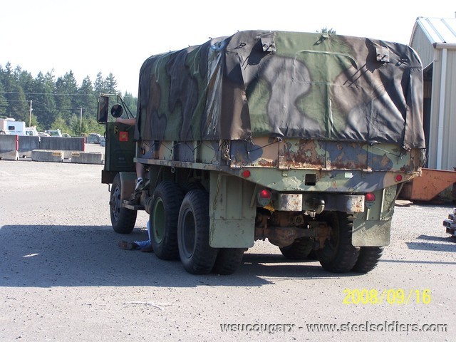

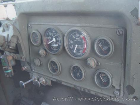

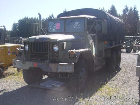

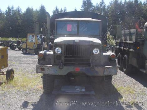

Inspection report (Good, the bad, the ugly)
Hey Aaron,
I spent just a little under an hour inspecting your truck for you. I've broken down my observations under The Good, The Bad, The Ugly. Albeit more good than the other two :D
What you have is a LDT465-1D engine w/turbo :D replaced 6/87 The entire truck was overhauled 7/89.
The Good:
First off my friend you can knock $250 off what you paid b/c you have a overflowing full tank of diesel. Ok it wasn't overflowing...but full tank it was.
Your engine compartment is immaculant!!!! I don't think I saw rust, if there was it was very very minimal.
Coolant looks new, no rust inside of radiator filler. Good color :D
Engine oil is new, looks like they just changed it :D
Newer hoses all around
Windshield frame and windows are brand spankin' new
Front tires appear to have very minimal use-look brand new
Rear tires look great
Cargo cover and cab cover look newer-good color
Batteries look like they were just replaced
Newer airpack and newer master brake cylinder
Tranny looked newer than the other components underneath.
Doors all opened/closed good, windows roll up/down great
Seatbelts work
In tank fuel pump working
Headlights good to go, turn signals work
Tools include 8-ton jack w/handle, lug nut tool, and 1/2" drive for plug holes only.
No leaky axles or hubs :D :D :D
Fire extinguisher in cab
Wood troop seats
Newer mirrors both sides
The bad:
The paint has much to be desired. Apparently the first coat of CARC wasn't prepped correctly. your paint is chipping and pealing down to the original OD green. It's pretty extensive over the entire truck including the instrument panel.Most of the paint is bubbled and just falling off :eek:
Driver seat cushion new, however driver back cushion is hashed. Feels like needles poking you. Bring two pillows, one for your bottom and one for your back. It has the older seat w/out a spring. Only cushion is the 1/2" foam under you
Rust pretty bad b/w hood and windshield-mostly surface
Rust spots all over rear-wire brush ought to clean it up.
E-brake handles releases but cable appears to be frozen. I didn't check the pads on the driveshaft.
Truck has heater controls but no heater.
No pioneer tools
The ugly:
The paint as described and driver seat. But nothing a few cans of Krylon won't cover :lol:
I'm not sure what kind of front axle. I didn't see a air switch in the cab for the front axles.
I didn't start your truck as there were several inspectors in the yard and for some reason FT Lewis GL do not allow the starting of trucks unless you're pickin up. The volts look great on your batteries.
I hope this helps you out.

Sounds like a good truck. Probably has the sprague transfer so the front axle will engage automatically if its still working. Glad you got the truck. Good luck on the recovery.

Nice truck and the good far out weigh the bad. In fact the paint may be a blessing it will be easy to get off the old stuff with one of those multi pad sanding discs they really work well.
