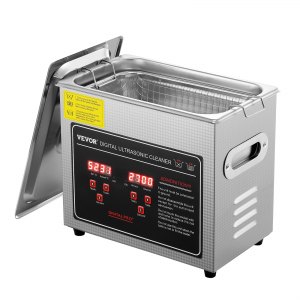

I am here to get some ridicule! Company coming this weekend so I figured I better empty the ultrasonic carb cleaner and put it away as it gets used on my kitchen counter. The liquid was black from cleaning the carb of course.
Low and behold the plate I was missing was in there stuck to the bottom in goo. Also one other part as well. Now the carb is complete. Starts better and runs crappy but that is a big improvement.

What ultrasonic cleaner do you have? I have to clean up my 885 and was thinking the other day of an ultra sonic cleaner.
Glad you found all your parts.

I use it a lot for carbs and absolutely love it with simply green. It is some generic brand off amazon and just make sure you get one with a big enough tub to hold a carb.

@Barrman , Look at the ones VEVOR has, they are inexpensive, last WAY longer than the HF one. Try running Evap o rust in it, it does wonders!
