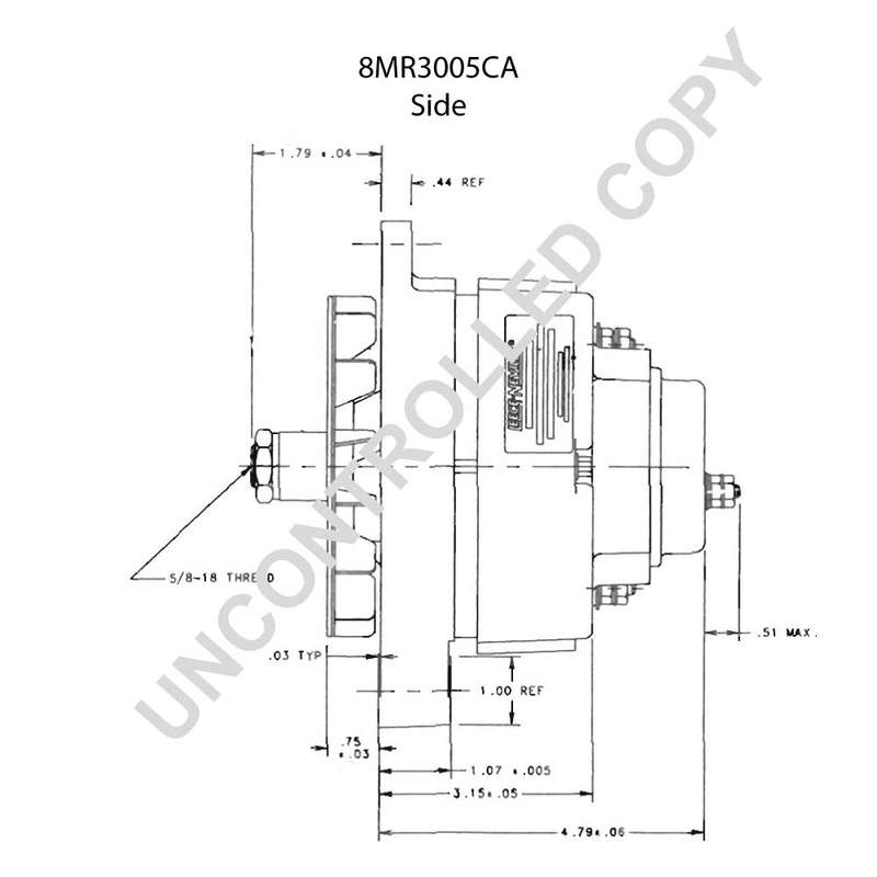

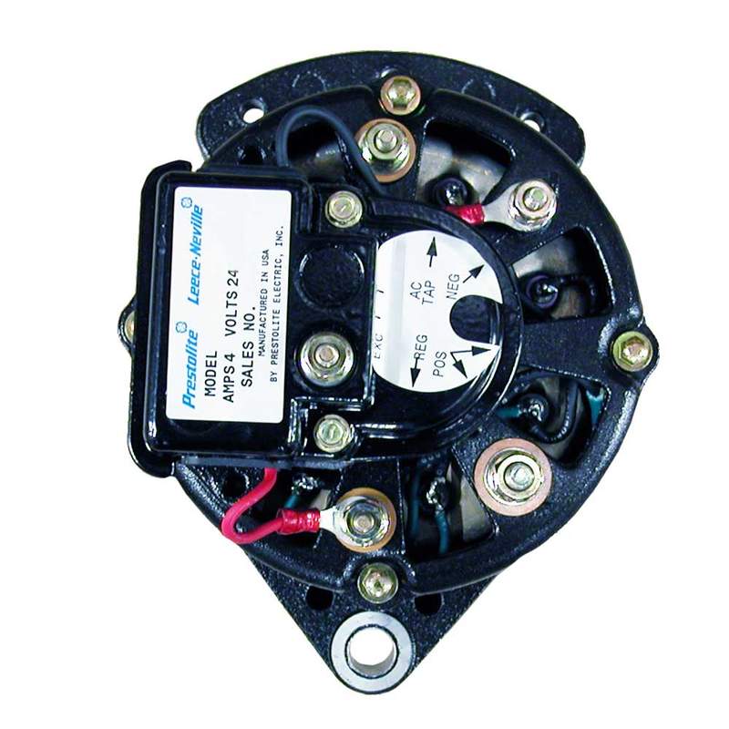

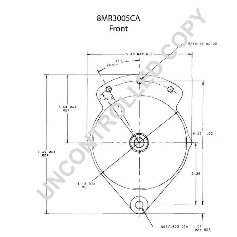

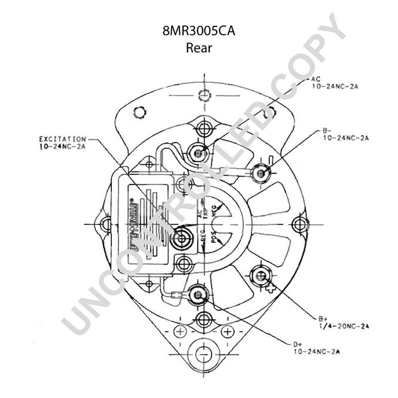

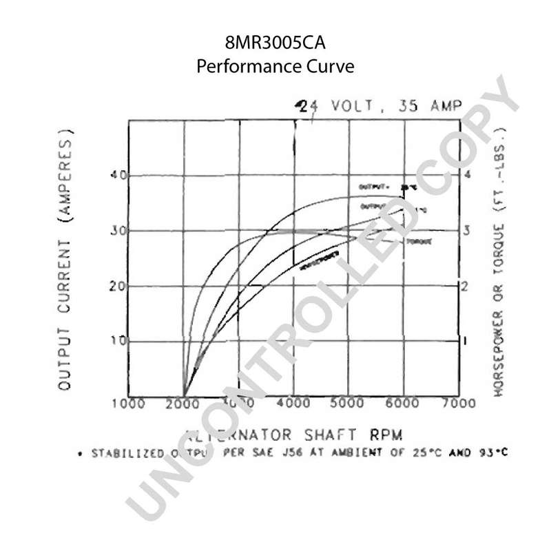

I brought home a new MEP-802A last week and was having trouble determining the exact terminal post layout for the alternator from the TM's. I found this data on the Prestolite web page and thought I would share.
