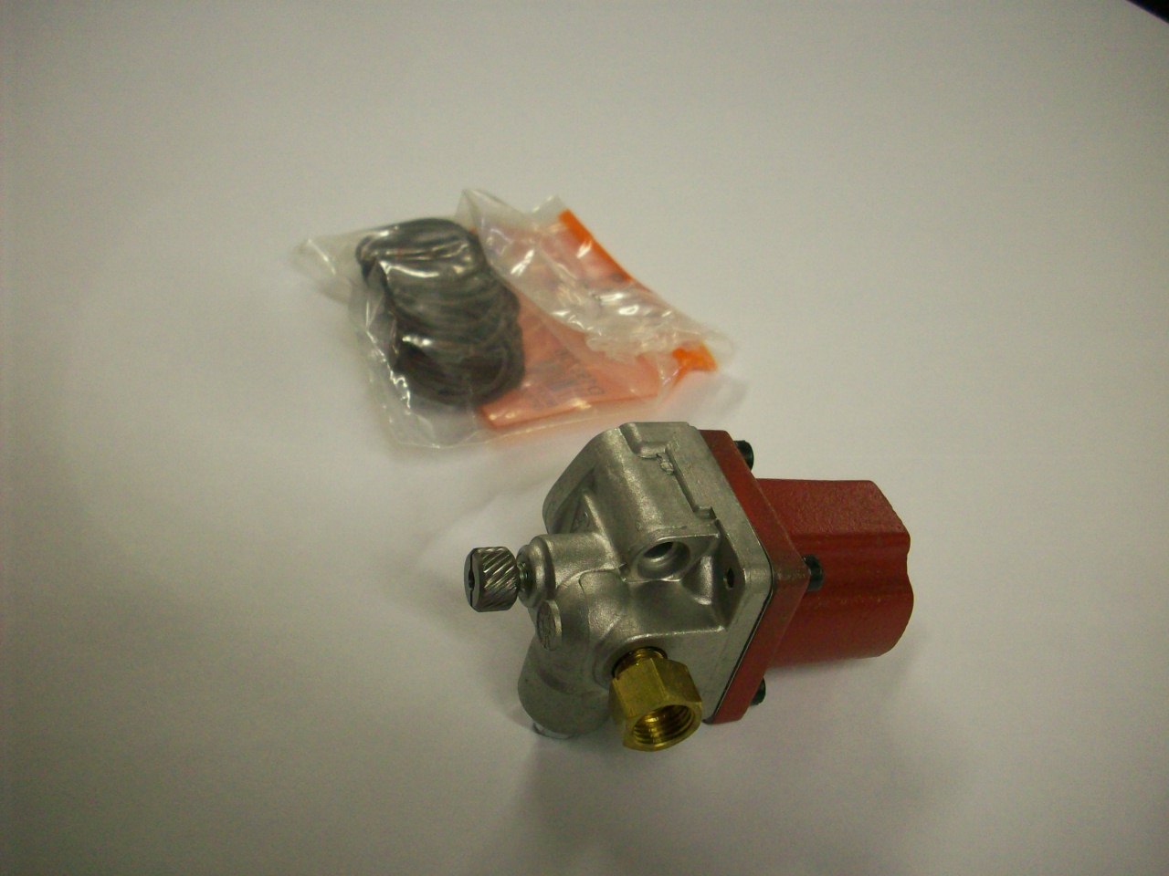

I was looking at TM 9-2320-260-34-1 in an attempt to identify this part but I cant find it anywhere. Anybody know what its for or where it gets hooked up to? (Its the silver part with the unplugged wire harness that says "KULITE") I think it must be a pressure sensor but Im not sure.
I also cant shut the engine off with the starter switch...I turn the switch to off but the engine "keeps on a runnin" and I have to use the Emergency Stop cable to shut her down.
Is this "KULITE" sensor related to my problem or is it maybe a bad fuel shut off solenoid causing this, maybe something else? Any help is greatly appreciated
Thanks
Mike

see if the bypass screw on the back of the fuel shut off valve is turned in, if it is this will cause the problem, if it is turn it out. if it is turned, WHY????

I second doublechecking the fuel screw. The GL guys love screwing it in if the batteries are dead, my 816 was like that when I got it. Nothing else was wrong with the truck, just the screw was turned in.

Hey Joe...If you were looking at the picture I took, would the fuel screw be on the left, right, top, bottom or face (front) of the fuel shut off valve. I dont want to mess with the wrong thing.

Follow the fuel line into the IP, in your picture its at the top, right behind the "mystery" sensor.
Your emergency stop cable pulls a valve that sits on top of the electric shut off solenoid, the screw they are talking about is in the front of that solenoid. Make sure the wires are hooked up to it also, does not look like it from that picture.

If you have a 900 not an A2 then yes the engine is the same and should have the same solenoid, but I have not worked on them so I am just guessing.
The emergency shut down lever does not have a spring return so you have to crawl under the hood to reset it every time you pull it. You can put a spring on it to make it easier.

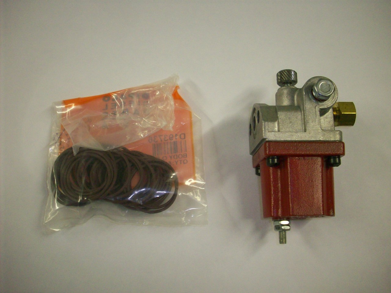

In the first pic the screw is behind the pipe above the silver valve with the wires in the shadow. It's really obvious when you look at the solenoid, there are wires on one end and the screw on the other (towards the front of the truck). When the screw is turned in, it pushes the solenoid into the engaged position without power so that the truck will start and run. Just turn the screw counter-clockwise until it stops, no need to crank on it hard.
As far as the emergency stop cable, it is designed to have to be reset from under the hood because it is for 'emergency stop'. It is not like a deuce where you have to pull the stop switch every time. Check the position of the above referenced screw, it's probably turned in.

Well, Just wanted to let you all know, you guys were right! I got in there, rolled the screw out and now it shuts off GREAT!! Thanks for the info everyone and Im sure Ill be back with more questions...Thanks again
Mike
