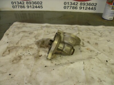

I don't care about the equipment, but I would love to find the -24P on this unit, to find out the part number of this right angle adapter - should be readily adaptable to the 802/803 machines (and get rid of some of the oil change stupidity!)

With the preamble that I know nothing about DRASH units;
I don't have a TM for that unit, but I do have some related information.
The LPW4 takes, I think, a 3/4-16 thread, with a 2.75" gasket diameter.
Lister lists an oil bracket part number 751-15490. There's one for sale on eBay (UK) at the moment;
www.ebay.com
Oil filter housing - X Lister LPWS4 engine ..SNF / 15490 / 751..........£40+VAT | eBay
Removed in working order, from a starting, running Lister LPWS4 engine, 4 cylinder, non turbo diesel, year 1990, fitted in a Beaver T24 (rebadged hayter T224 ) mower, showing 2712 working hours that had suffered bottom end/ crank failure.
www.ebay.com
Ford made one as well, F4UE6884BA, shown here
forum.ih8mud.com
Installation of 90 degree oil filter adapter on 1FZFE
Installed a Ford Racing 90 degree oil filter adapter (M-6880-A50) today on my 96 FZJ-80. Debated between a remote filter and this adapter but went with this one to keep it simple; the threads for the 1FZFE oil filter pipe are 3/4x16 inch, same as the Ford adapter. Due to the adapter being...
forum.ih8mud.com
forum.ih8mud.com
I think it has been replaced with this M-6880-B50, which goes from 3/4-16 to 22mm metric threads, I.e, different filter, e.g. Fl-500A, or FL-820
performanceparts.ford.com
BILLET 90 DEGREE OIL FILTER ADAPTOR FOR PUSHROD V8 ENGINES
BILLET 90 DEGREE OIL FILTER ADAPTOR FOR PUSHROD V8 ENGINES|Ford Performance Parts
What I don't know for the non-Lister parts, is whether the filter diameters match, and would fit on the LPW4/LPW2 engine block.
Trick with these is to look at the engine and the power panel. If it has all 60amp connectors start to look towards the 18kW or 20kW. Now the engine, 18kw has an Isuzu, the 20kW is Lister Petter.
If it has 60 and 100 amp connectors or all 100 amp connectors it is a 33kW or a 35kW. 33kW was Isuzu and the 35kW had the yellow John Deere.
There may be a couple oddballs outside of this but that is 98% of what was fielded...
As for a -24P, your unit was one of the early ones. Drash and PSI used to work together in those days. PSI spun off the trailer and used the Base-X tent and both companies were purchased by HDT.
DRASH went it alone and made their own trailer and with that they won the TMSS contract which meant they got a mil spec manual. As far as I know there was not a mil spec manual for the ones that early, only a commercial industrial manual but there was a drawing pack.
After all that, it is a Lister Petter and they used to use the LPWT4 engine....Summit racing was where I thought they got the right-angle adapter but it has been a while:
Scott Drake C8AZ-6881-A Scott Drake Oil Filter Adapters | Summit Racing
