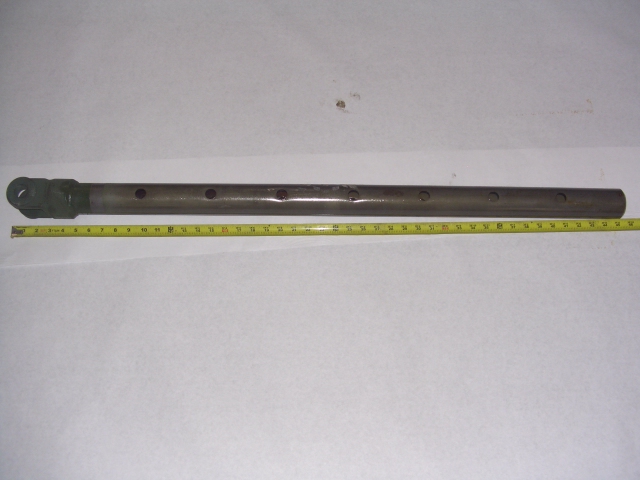

I took a chance a couple of years ago and bought a damaged med duty tow bar w/ 3/4" feet for $150 including delivery. I am finally getting around to try fixing them, as you can see in pic the ears are bent out far enough that the pin won't go through., I'm thinking that they'll need to have some heat put on them before attempting to press them back straight ...??...

When our tow bar shaft got bent we had it straightend after heating , then tempering at an engineering shop. You MUST be 100% carefull around damaged and or bent recovery equiptment. ANY doubt dont use it.

I might fix it but I would not use it until after having it magnafluxed (Zyglo) for micro cracks or metal fatigue.

I would guess that after looking at it, that there is a very good chance of a crack in one if not both ears, right at the base, I would not use no matter what, it would not be worth the risk.

I'm not saying I wouldn't try and straighten but you need to be careful. If I'm not mistaken, they are forged. Strange things can happen to the grain structure of forged material when heated.

So am I wrong to think that drilling it so the pin fits is a better idea than heating or bending it?
I don't mean drilling it much. Just enough to get a straight shot for the pin.

Then you're going to have a oblong hole and the ears are still going to be too wide. I don't think this would be what I'd do.

I have scrapped several towbars for less. It's always painful to let them go.
If they ever looked like they were jacknifed, they went to China.

Looks like the one in question here just had the feet installed upside down. Not to take away from what you said Angus, just pointing out what it looked like to me.

The ends ARE cast/machined when cast bends it cracks, pressing the ears back in shape will cause more stress cracks, then welding good root passes inside at the radius and out side in the center of the bend will it self could cause some stress cracks unless the cast part is preheated and a very slow cool down.
You guys that say go ahead and use it just make sure you use safety chains have never had a safety chain event, let me tell you if you ever have one, you will never make that statement again, it is a VERY puckering event till everything comes to a stop, the towed load wants to pull you where it wants you to go, ect. The heavier the towed load the higher the pucker factor. Ask Mr. WM about the time he lost a tow bar pin for pucker factor info.
The ONLY time that section of tow bar should be used, is in the event there is nothing else and even then remember discretion is better then valor. It is not "is it going to break" but "what IF it breaks"., it is just not worth the risk to others, to you, or possible damage to the vehicles.

I would just cut the end off and lay it next to a good tow bar and mention quietly that you bend on me you will suffer the same fate. That will keep the good one in line. ;-)
Or use it as a paper weight. I doubt having it magnafluxed will help.

I'm (now) thinking new insert(s).....why take a chance.

Looks like your towbar is one without reinforcing collars. Inserts WITH reinforcing collars are different length.
