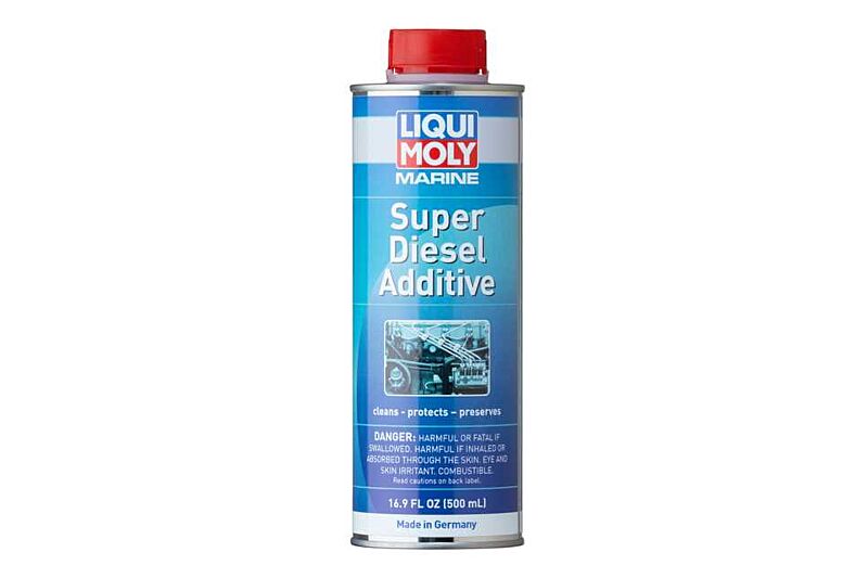

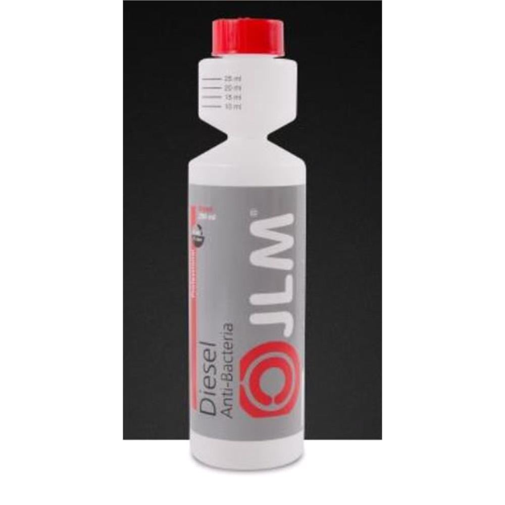

Now I have to decide which substances to add to the diesel and hopefully get rid of the pest.
or
www.liqui-moly.com
Interesting, the product description on the Liqui Moly soup describes a preservative dose
(1:1000) and a shock dose (1:200)
for systems that are already infected. I think I'll go for the shock dose
Marine Super Diesel Additive
A combination of additives that clean and maintain diesel fuel systems. Prevents corrosion and increases lubrication thus reducing fuel pump and injector wear. Increases Cetane value for improved engine performance, easier starting and lower emissions. Regular use keeps the fuel system in...
