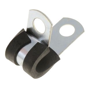

Good points...if the injection lines vibrate due to missing anti-vibration clips, they can fracture and leak. There should be at least 2 clips spanning all lines in two locations. If you are missing some, consider using automotive cable clamps with rubber insert. You can use two and fasten them together with one bolt, thus connecting two injection lines. http://contentinfo.autozone.com/znetcs/product-info/en/US/drm/85605/image/3/
Do this for all injector lines in at least two locations.

It is definitely missing some anti-vibe clips. I had already planned to get all new clips and check for cracked lines. I have not yet made it back to the truck, just trying to gather as much knowledge as I can prior to going to its location.
