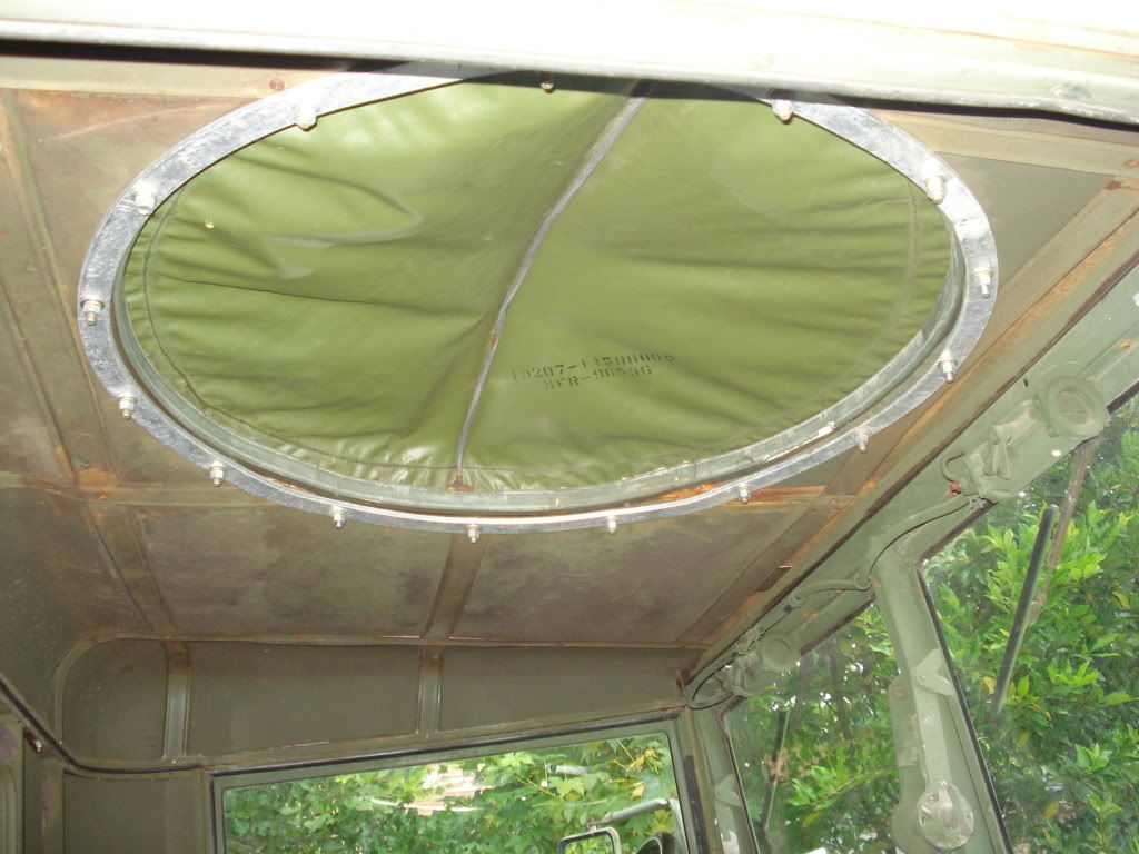

Does anyone have the dimensions on the opening cut in the roof for the gunner to operate his weapon thru when mounted on the Ring Mount? (It is approximately 2 feet according to pictures)
I need to make a Steel Closure or Patch Panel and need the thickness of the top material and the approximate size.
I plan on making it 3/4 inch oversize and then use a English Wheel to roll a joggle or sometimes called a flange around the outside. I will then use steel flush (countersunk) rivets or possible bond it in place using aviation grade adhesive.

I am thinking more in terms of a removable lid that can be kept sealed up unless you need to man the weapon. A hatch that would open and close on a hinge would prob be difficult to manuver under the ring mount and would be in the way unless it would lay flat.

Grab one of the HEMTT covers if you must, but I would suggest making the cover with a hinge (piano type) across from left to right on the center line, you'll have to work a seal out for it, but it should hinge or flip under while the main back panel flips over onto a rest at the rear of the hatch, that way you would clear the .50 or whatever's mounted when your co-driver chooses to open the hatch. The folded cover would be completely out of the way of the ring mount. In California you want a ring mount???? Who do you think you are...... The Groppenfuerher?:twisted: Just ask Ahhnold if you can borrow his M60 tank, solves the whole problem of portable weapons all at once! Chances are you just wanta take the Bunnies for a cruise and you're gonna tell them your SUV has a sun roof!

yeager1
335
Colorado
I have an original turret top and thought of doing a hinge as you suggested, but then relized I could no longer drive with it open (which is nice but loud!) so I'm doing a standard diamond plate cover. Here's an inside pic.
