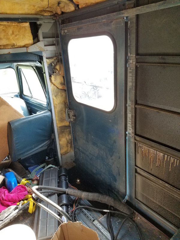

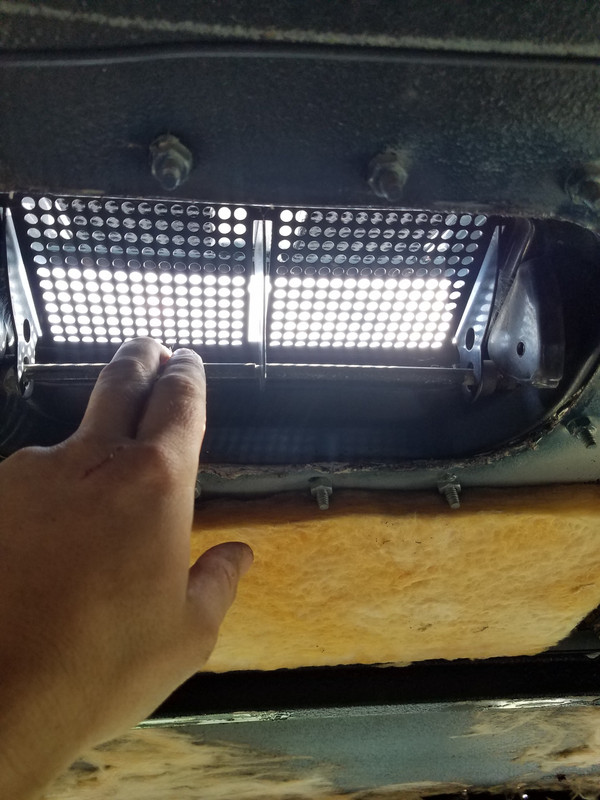

The top side looks to be a very simple unit with nothing more than a radiator and two fans. The motors of the fans could be replaced fairly cheaply so the outside split I'm not worried about- that can be fixed.
The inside split I know nothing about. There seem to be some things missing to my mind. I don't see a pump or drier or any of the other fixings that should go along with an AC. Unless it's all tucked away inside the blower housing.

From the top mounted condenser, it should enter a receiver dryer and finally the thermal expansion valve (saw it on the picture of the evaporator). This device meters liquid refrigerant to prevent evaporator ice.

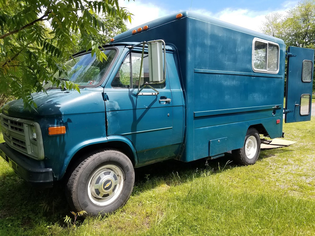

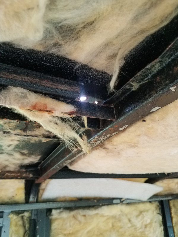

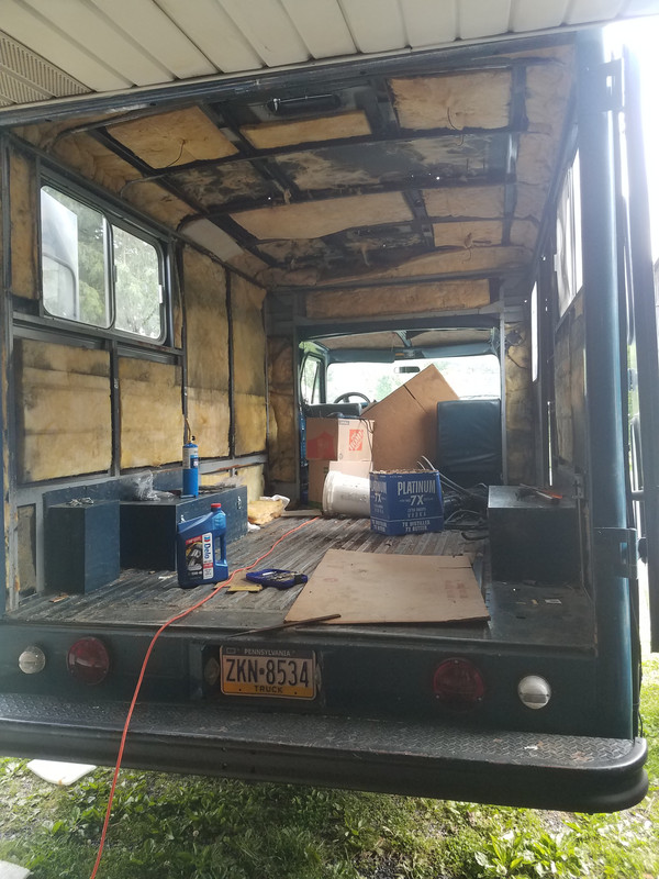

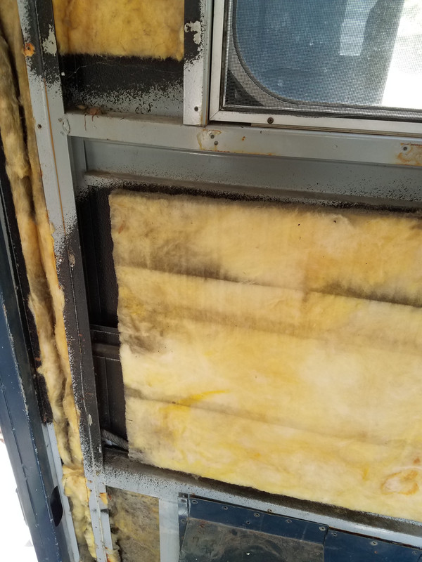

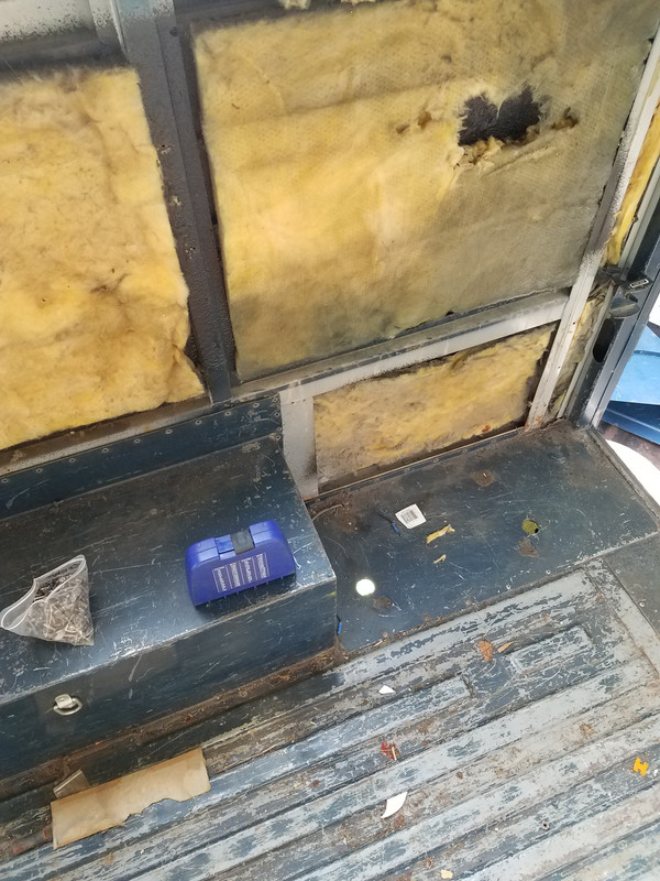

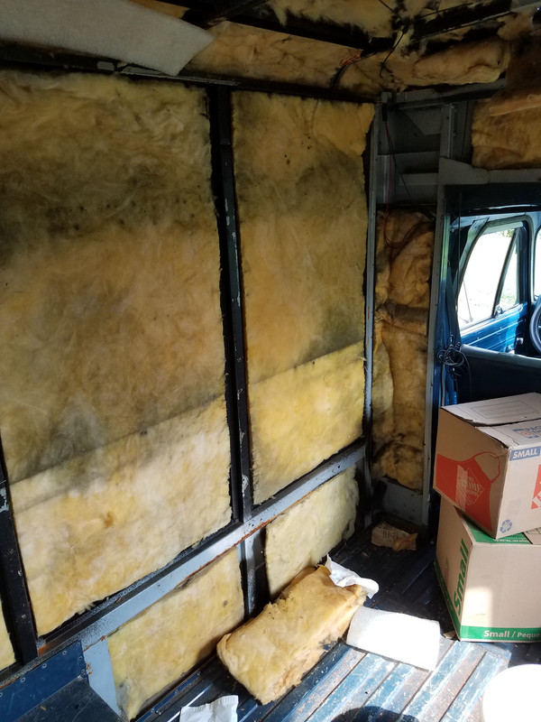

Thanks. Here's some pictures of the work I've been doing to it today. Going to patch all the holes and paint all the rust next week.
