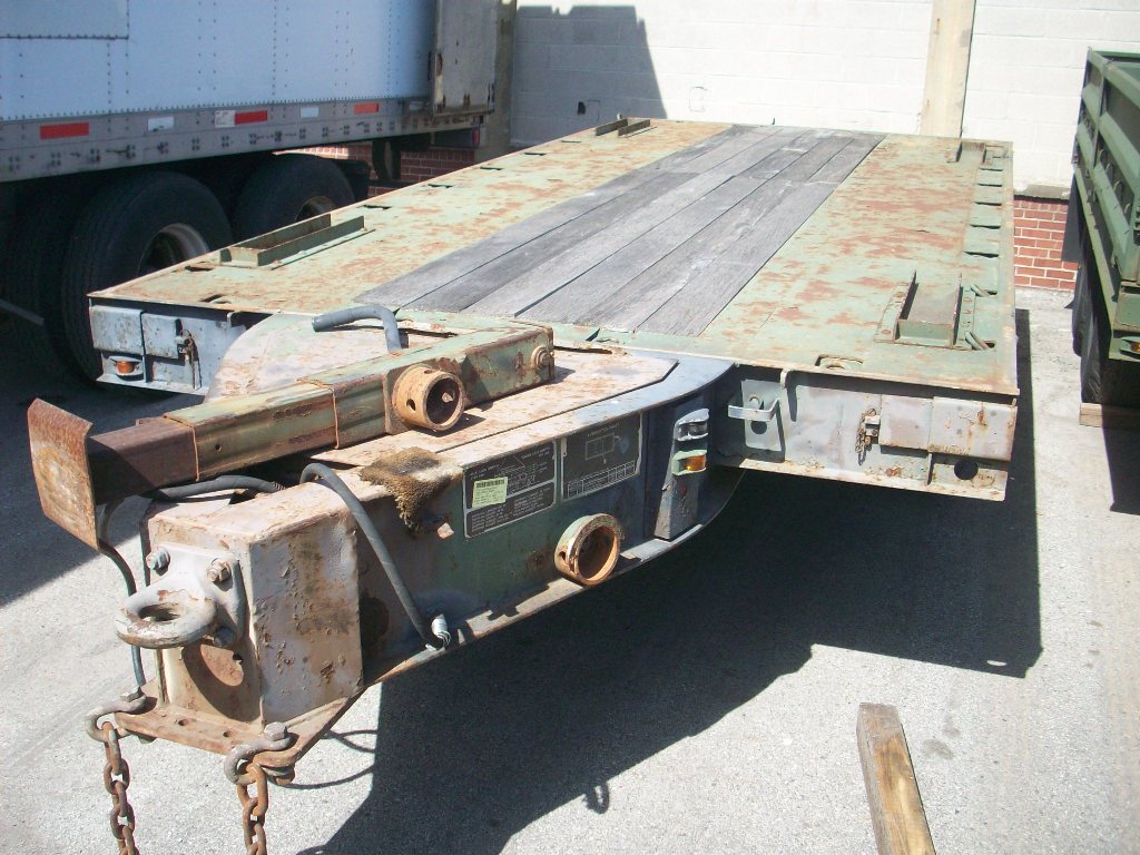

Hmmm,that was not the trailer I was thinking of 11 Echo, I was thinking of a M989 ammo trailer evidently.
http://www.easternsurplus.net/images/538/538b.JPG
The HEMAT M989A1 is an ammo trailer.
The trailer you are referring to is also a M989, not a HEMAT version as mentioned in your post.
The deck is about 17', around 6' shorter than the M345 and About 3k lighter in weight.
Two of those sold on GL back in April. One for $1357 and the other for $1200.
An M345 could be lowered some by changing the stock 1100's to 900's or maybe get some low pro 19.5's for it.

My ... post was to edit a post where I thought you incorrectly stated M1076 in your post with the M345 picture. Or, you edited yours. Either way, I edited mine, but do agree both trailers are too much trailer for a deuce!
