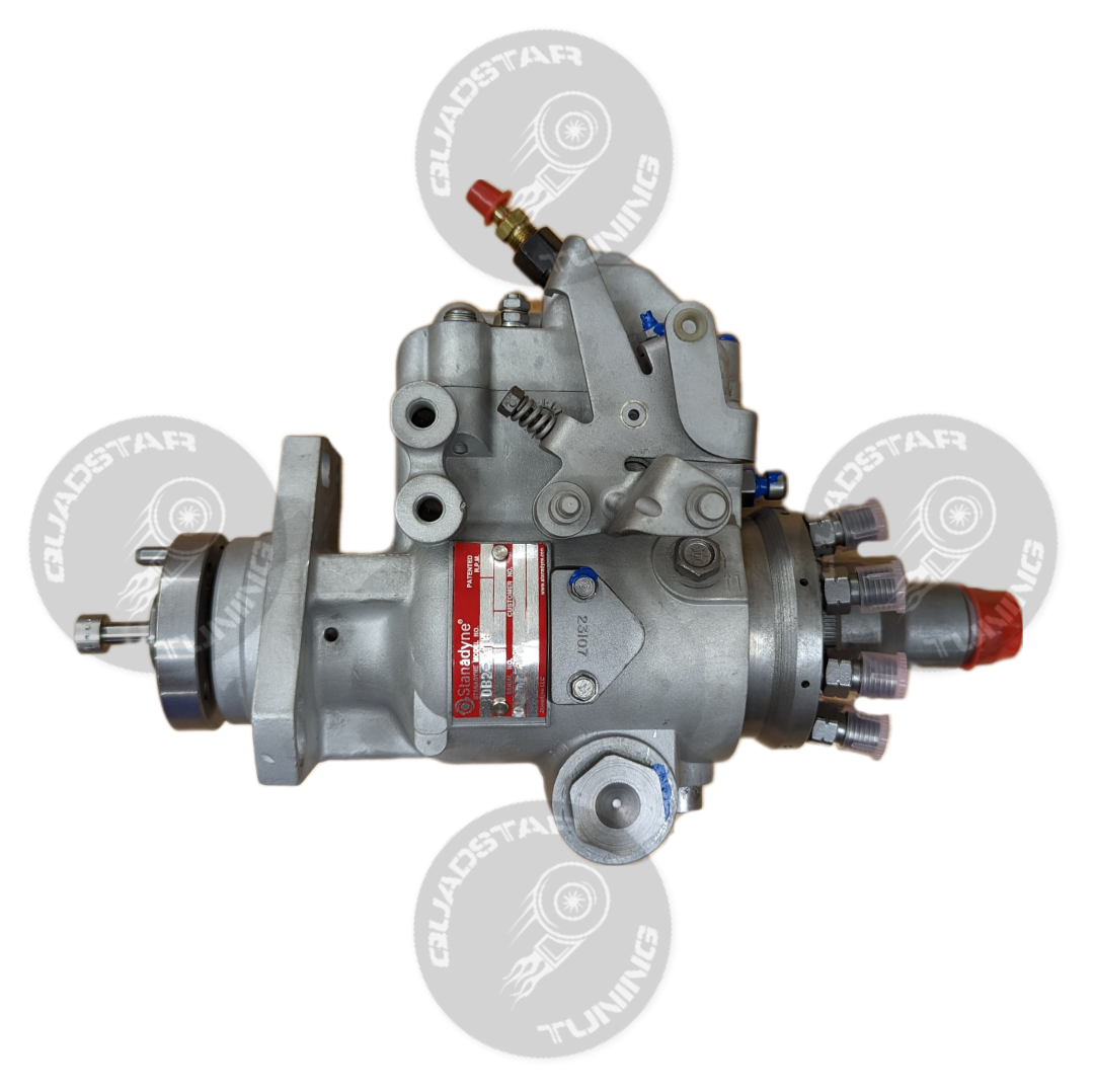

I haven’t purchased the pump from them (but many other parts) but quadstar tuning sells IP pumps as well. They fall in between for the price (I recall $800ish) and from all the other items I’ve purchased from them I would highly recommend them. Probably who I would purchase an IP from if I ever need to again (hopefully not!).
EDIT- looks like quadstar no longer sells the non-turbo DB2 IP, but since you're going with the turbo the 4911 would be better anyways.
