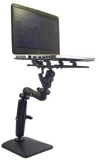

we have computer mount options availabe
Dave
Thanks, Dave. What I'm going to need however is the dock itself that the laptop interfaces with. It is a brand/model specific piece.
If I decide not to make the mount that the dock attaches to I will revisit your links, and maybe PM you for measurements to be sure they would be tall enough.
