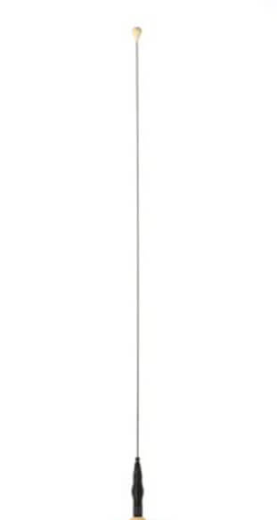

If there is one there are 100 different surplus bases out there none of them to my knowledge that will work for 11 meter (CB radio). The base I am going to direct you to an AN-3916VRC which was developed for the military after they figured out that vehicle fired rockets tend to melt sectional antennas. It is a very cheap base, usually selling for $20-$30 dollars ($40 if you are lazy on Ebay). It uses a plan ole SS whip antenna that can be purchased just about anywhere for $25 and once built can be tuned (SWR) like any other CB whip antenna. The base comes with a BNC connector that can be used “as is” or you can easily swap it out for a PL-259 connector (standard CB coax connector). They dissemble easily and only need basic modification to work like an off the shelf “CB antenna”. Best of all when you are done with it you have a true ¼ wave whip which is about the best mobile antenna one can have and for only about $70.

102” (sometimes 103”) SS whip antenna $18-$30

Larsen Whip tip for a W490 & W450 PN “Ball1” (they sell these on Ebay for $10 each, a bag of 10 is under $7 online if you search for them)

The Larsen Ball1 whip tip is not a “suggestion”… Whips put out eyeballs! Don’t be the douche that sticks a 100+ inch antenna on to his truck and blinds someone!!!!

16. Cut the threaded portion of the SS whip antenna off, file the edges, install into your newly modified base.
