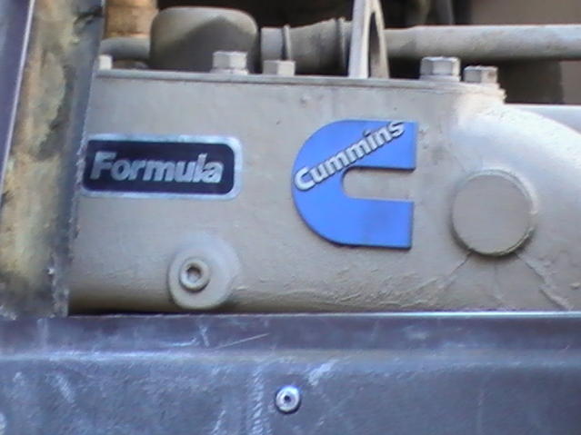

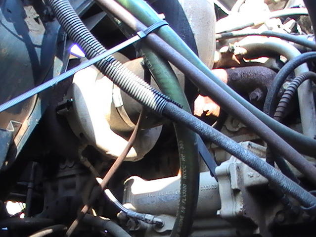

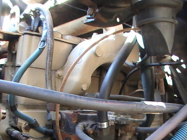

1985 IH. I got this for the motor. Did not even know what was in it when I bid just knew it was a good size Cummins. I posted a pic awhile back and most said it was and 855. 855 240 @1800 Formula. Not a bad motor. It should fit well in a 5 ton bobber as it does not have Jakes or the water manofolds so no hood mods. I believe. I will find out what that motor can relibely put out and leave it at that. I don't know what I will do with the cab from the HI when I done. I might just leave it in the yard as it glows real nice at night.

Cool! Glad to hear the engine is something you can use. The main thing I think it lacks is oil squirters to spray oil at the underside of the pistons to keep them cool. From what I understand that is the main item that limits how much fuel you can add to it to turn up the power. There are several Cummins experts over on the ATHS.org forums that know a lot about turning the fuel up on an old Cummins and someone over there should be able to answer any questions you have about what to or not to do.

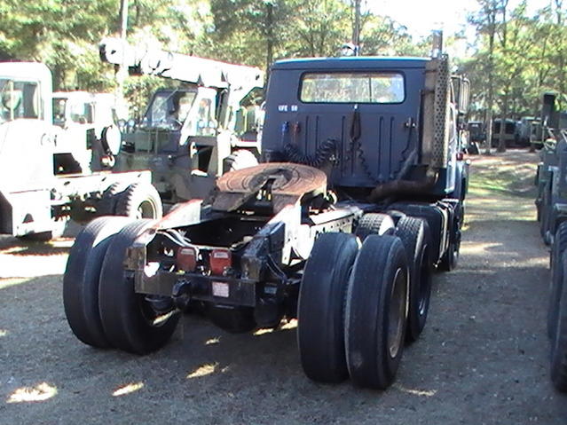

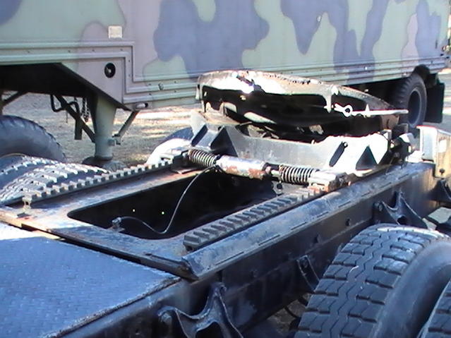

Shoot James, you have plenty of green trucks. Pull the slider kit out of a 5 ton and put up under the binder then add a transfer case and front drive axle out of a 5 tonner. Make you a nice pullout truck or spotter in the yard.

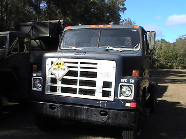

Little paint and yes it could be nice. The nabors are complaining though as the glow keeps them up at night. Don't know why. What does this weird sign mean I never saw it before on any of the outher trucks?
