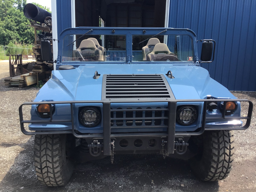

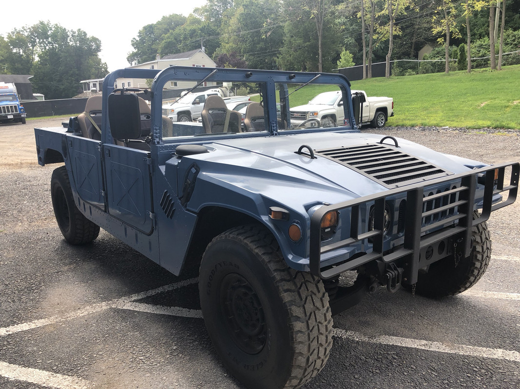

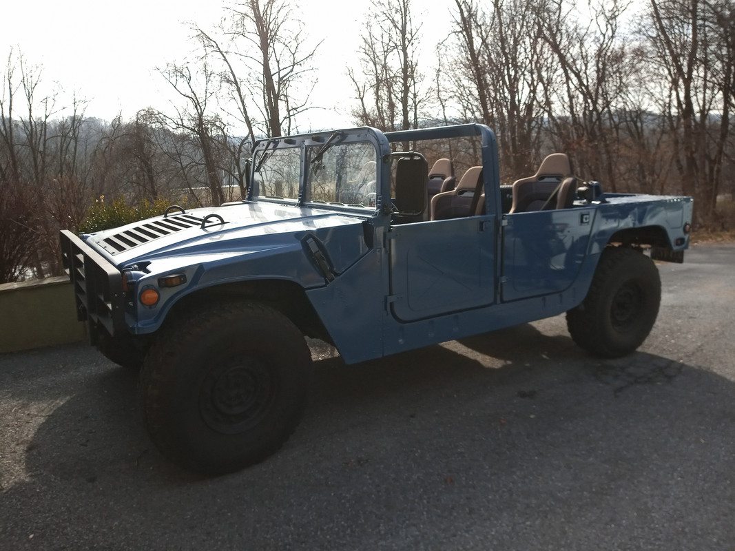

Christmas Eve I was speaking with my girls step brother who happens to mention he has a 90 6.2 hmmwv with 59,000 miles. He's looking for $25,000 but will sell it to me for $20k. He owns a heavy equipment company and has already had his mechanics go over it too to bottom and had it professionally repainted. Four seats installed. Led conversion head and tail lights. SF half doors.
Seeking your professional opinions on value. Given it's mileage, the fact its been delivered, inspected and combed through. This would be used around the family property.

I think you're being taken for a run at that price. Those doors look like they're the aluminum aftermarket doors from Plan B. The seats are legitimately a good addition if they are installed well and have the seatbelts properly secured and you're not looking for original military design. As well, where's the top? That's one of the more expensive parts of a 4-man setup (There's no C-pillar or 4-man handrail in the pictures, so you'd be looking to spend $1200 to go and buy those).
A mechanically sound truck is worth some extra value, so if you trust him on that, it's some nice, extra value. Still, we're looking at an old 6.2L powerplant (can be fine, but a 6.5L or 6.5L turbo can be much better) with a 3-speed transmission. This is the most common drivetrain and for people that want to do highway driving, they commonly look to replace this set with a 6.5L turbo/4-speed combo for more power and an overdrive gear.
Despite the pretty paint, this looks to me like he's peddling a HMMWV at "discount H1" pricing. I'm also hearing nothing about a street title-if it doesn't have that, just walk away and buy something else. I would look to pay between 12-15K, depending on what the market looks like in your area. You can find other HMMWVs in better condition on this board for less money than what he's asking, and the cost to ship or retrieve won't be very high compared to the price of the vehicle.
