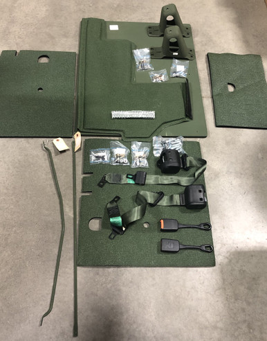

Is this the right seat belt kit to go 2 man to 4 man?

I won an auction for a basic 2 man m1123 last week and I'm starting to research and buy stuff I need to convert it to a 4 man (while wating on EUC, etc.).
I already purchased a 4 man top/door kit and I'm trying to confirm what else I need.
It looks like I need the following kit for rear belts and hardware and it also has some insulation that I assume goes on the tunnel and/or floor near the rear seats.
Is this the right kit for my m1123? If so, is the source linked above a good place to get it from or is there a better source out there someone knows of? I'm still trying to figure out the best places to find OEM parts.
If I have this kit and the top/door kit, am I just left needing seats or is there anyting else I'll need to do the 4 man conversion?
Thanks

I was looking at the same kit from the same place. I don’t want green seat belts. I don’t have any experience with that site but I would’ve ordered it if it had black belts. If you read ad closely it says for the passenger behind the driver. I didn’t really understand if that included everything for the passenger behind the passenger.
Here is another kit that looks different with black belts and some different brackets. Not sure which one is correct.
