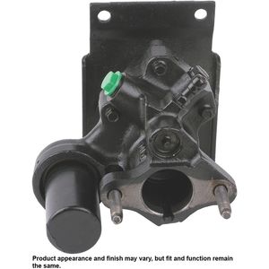

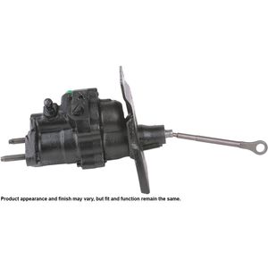

Fits Your Vehicle
IT FITS. This product is a fit for your: 1984 Chevrolet Truck Blazer 4WD 6.2L MFI Diesel OHV 8cyl
Part Number: 52-7248
Alternate Part Number: 62-11271
Warranty: Limited Lifetime
Pick Up In Store:
Order in Store
Ship To Home:
In Stock
Est. Delivery: Nov 18-21
Price: $ 151.99
Core:
$ 49.00
Total: $ 200.99
ADD TO CART

I hope that information helps Pal. I know I can get you one at other places also. That is a great deal. It is re manufactured in USA and has a lifetime warranty. I never returned one for warranty. I do have a few used ones. But I have not been putting anything used on anymore except sheet metal and glass. This stuff is getting old. I just put a re-manufactured steering box on a CUCV truck. I had several used ones on site here. But at less then $200. it was hands down the wisest decision. I don't care how low the mileage is.
Good Luck. I hope that information is helpful.
