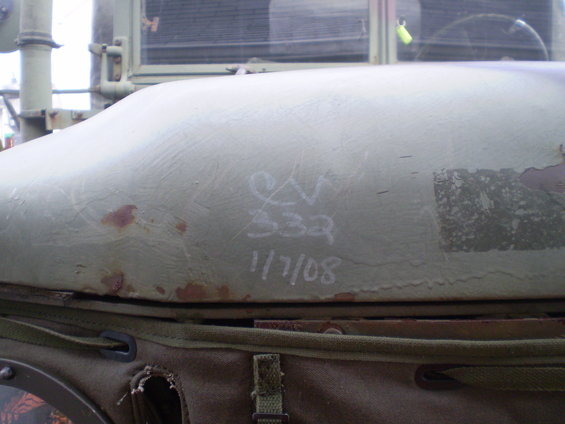

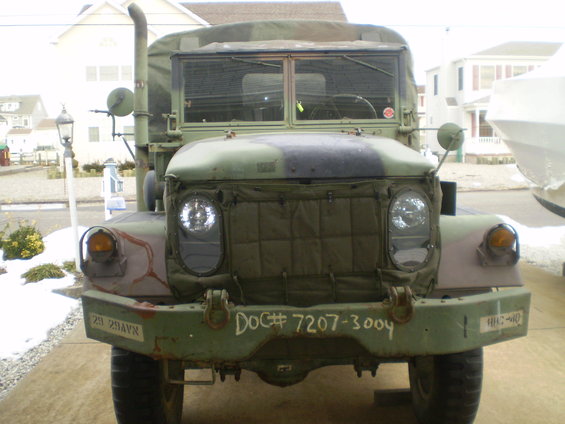

The number on the bumper is the turn in document line item number that was your truck. You can confirm this by the turn in paperwork if they left a clpy in the truck as they are supposed to.
I am speculating on the hodd but the date is more than likely the date of turn in to DRMO.
I can aks when I go make a pick up next week but perhaps someone else here knows or perhaps post this on the GL area that they watch.

I bought the deuce off a friend who took care of all the SF97/title stuff so I didn't get any paperwork on it, other than the new title. I kind of figured it was some kind of inventory number or something like that. Just curious to see if someone knows what it all stands for.

I think the date on the hood is the date DRMO received the truck, they then have to hold it one year to see if any gov. agencies want it if at the end of one year no agency wants it, it goes up for sale. I asked a GL guy about and that was his explanation.

The first pic shows the number it was made absolute for the former unit or decided not to be repairable any more and handed over to DRMO. The second pic shows the number which lists the truck in the sales lists to find it. (All this was said beforehand.)
Without form 97 the truck is just a pile of iron, depending on your athorities. Titles will not be handed over or issued except for civilian vehicles in military use (for they come with a certificate of origin to the Army), except for vehicles issued after 1980 to the Army. For anything else before 1980 to get a form 97 is a lucky issue. The only change in some states is a vintage car registration.
For my M101 A1 I also had no form 97 for it went surplus in 1985, when the form 97 did not exist. However, I got it road registered without big discusion for I had a TUEV inspection report. You can see the trailer in the pic on the left. The truck I registered in 1982. Form 97 was a part of the unknown future!

Second picture 7207-3004 is 207th day of 2007 as the date the turn in document from the unit was prepared. 3004 means it was their 4 action for this day dealing with equipment/property.
From what I can see it came from the 29th Aviation or the 29th Infantry Division Virginia Army National Guard.
