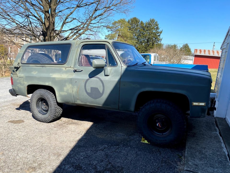

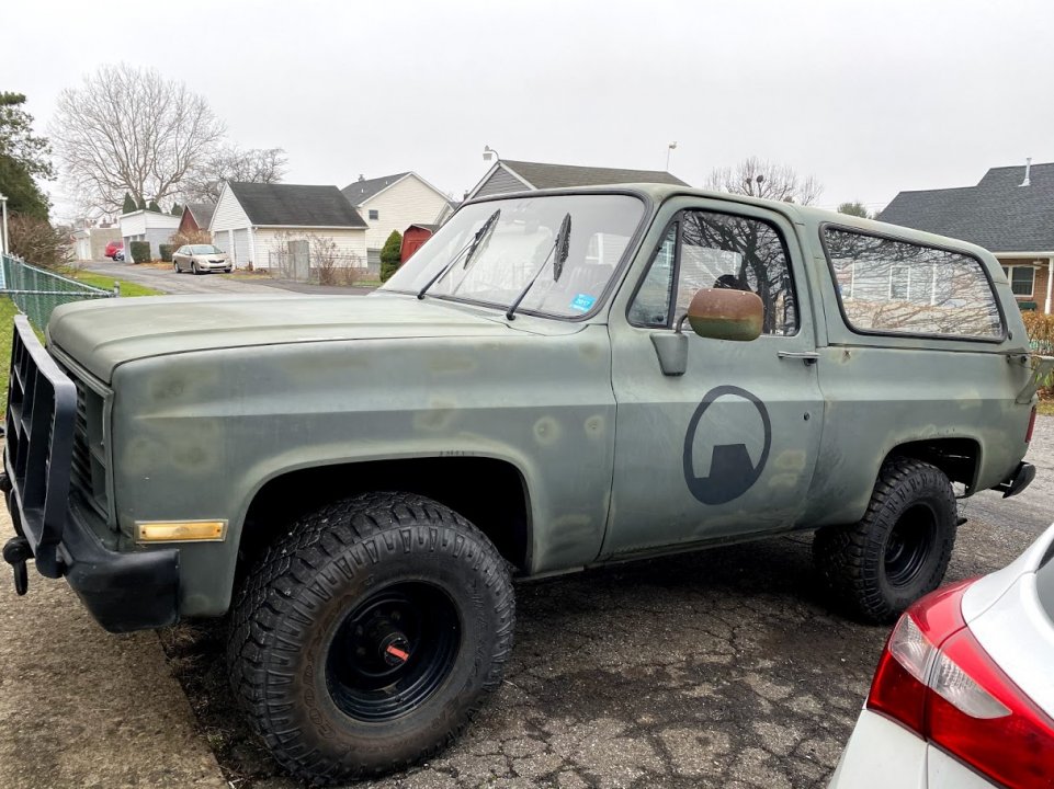

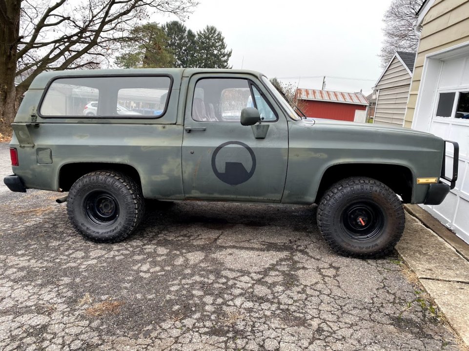

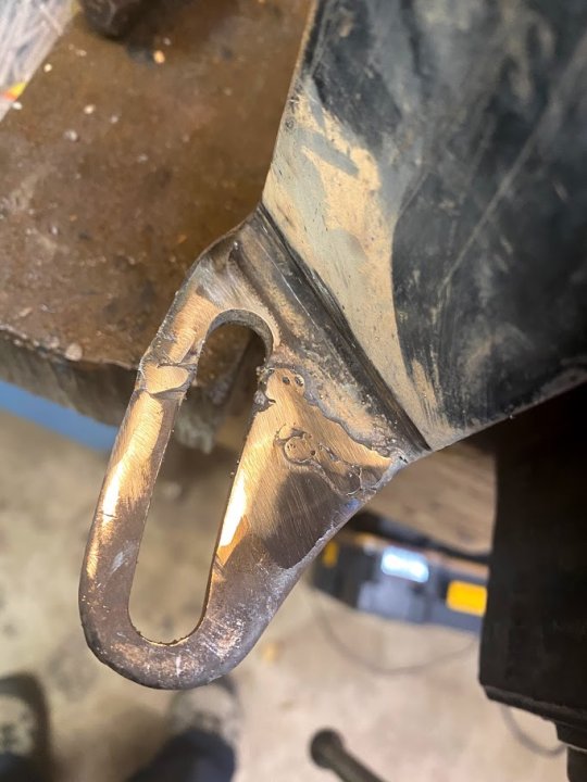

Hey guys I just picked up this pretty nice M1009. It needs a whole lot of little things addressed but runs really nice and has very little rust for my area. It seems to already have had an electric fuel pump, fuel filter, glow plug resistors and starter relay mods done. It came to me with a broken power steering bracket, dead batteries, non working wipers. a hand full of electrical issues, a replacement tailgate, and possibly a coolant leak. So far I have welded up the power steering bracket, charged the batteries (they seem to be holding but I doubt their capability for really cold starting), and gone over the gauge cluster which 75% of the bulbs were not lighting and its ground.

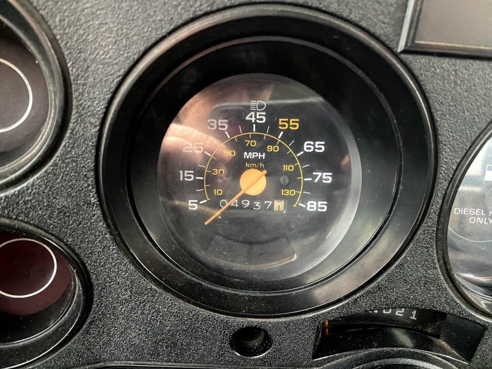

Looks like a great project. I wonder if that could be the true mileage on the odometer. The photo of the fuel and brake pedals show very little wear so you may have an original underused low mileage gem. The antenna bracket mount in the rear tells me it's a 83 or 84 truck.
To bad that the PO did those mods, 'but you can always reverse them'. Is it still a 24V starter?
Also, you may want to double up the metal on that PS bracket. It most likely will break in the same place as it did before.

The odometer has rolled over so its got 104k. Its still a 24v starter. I double it up next time it breaks!

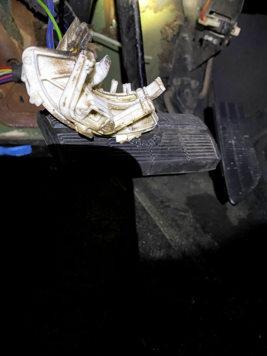

Not sure but why it was done but the reverse switch was stuffed in the back pretty good. My horn is not working I need to take a look into the diode, filter and fuse. It came with the tires! I also found out its got new brake master cyl and booster, brake lines, rotors, pads, and a complete nos rear axle (locker destructed itself).

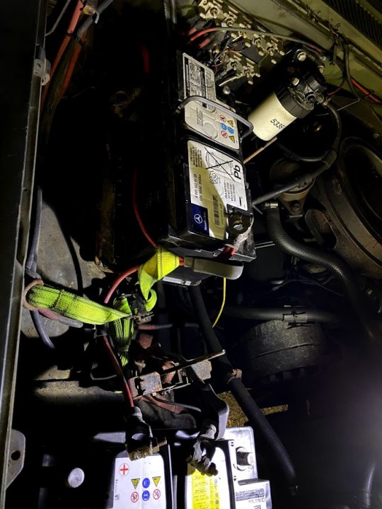

  • Newer batteries.

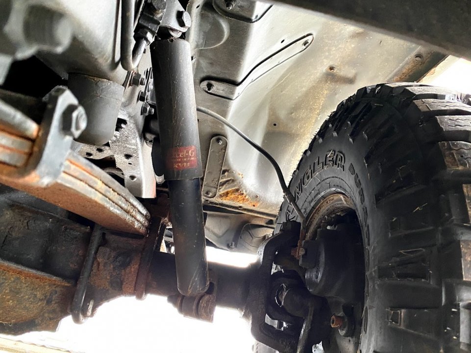

I was able to drive it around today for a bit. The trans shifts later than I expect and the rear brakes need adjustment and I think I have some slipping belts as the gen 1 and 2 lights independently and randomly flicker on for a second here and there. I still have to look into the horn but I see there is no fuse installed for it. 4x4 works great!

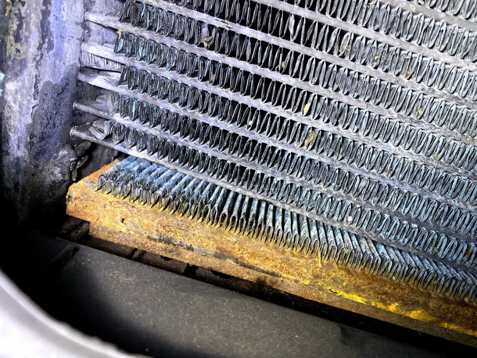

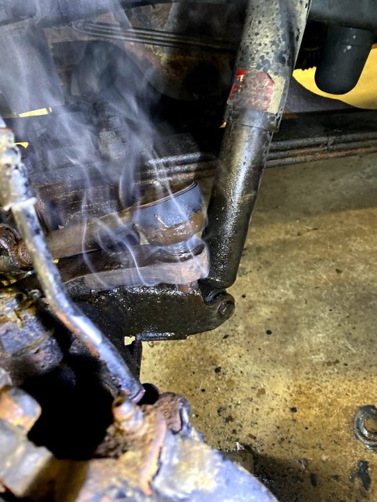

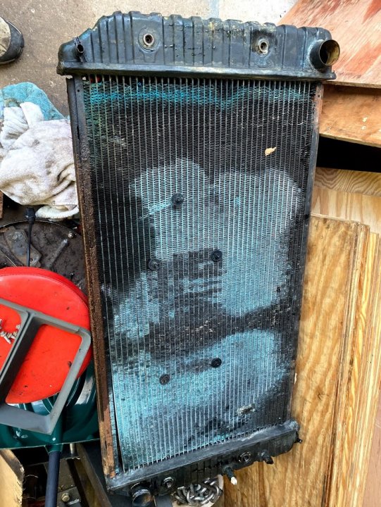

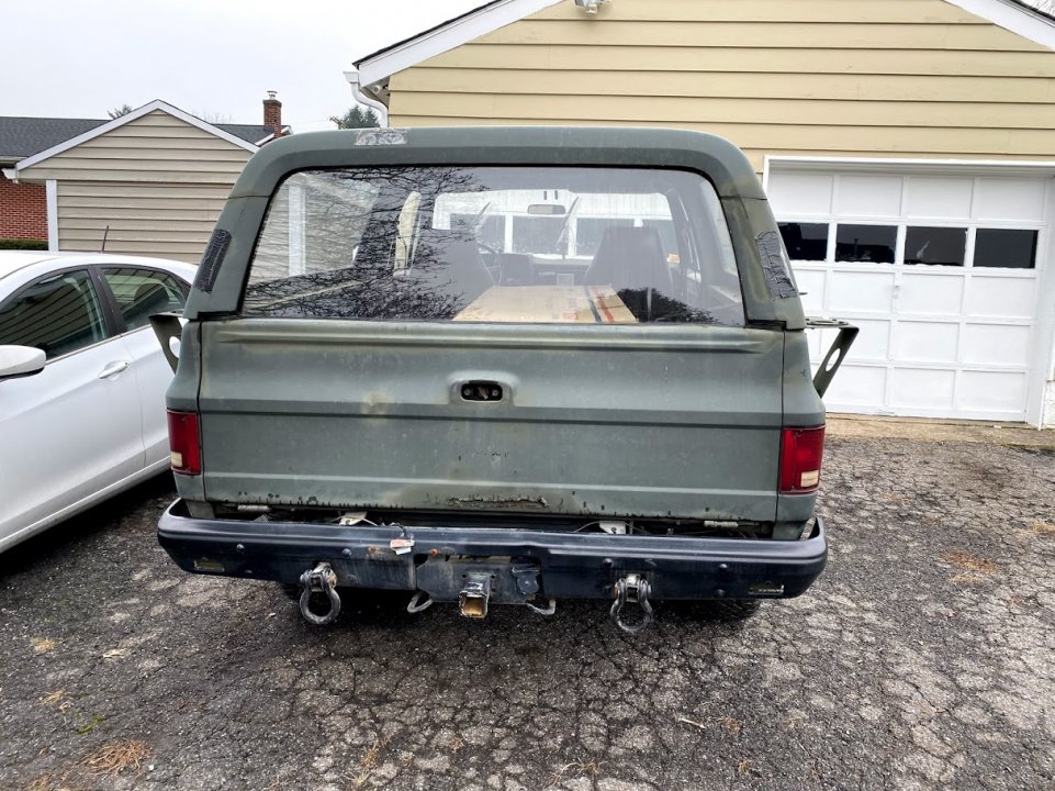

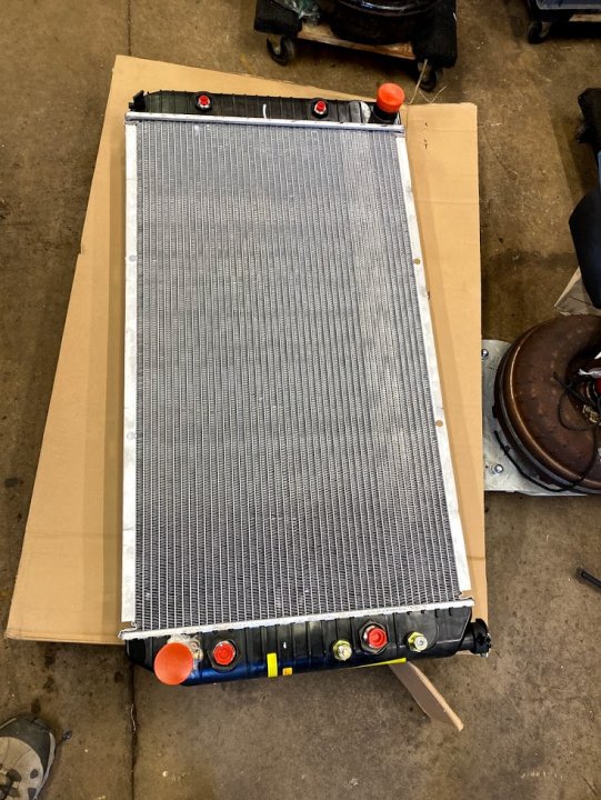

So this thing has been kicking and screaming but I keep forging ahead. The aftermarket external trans cooler started leaking and upon removing that I found that the radiator was a ticking time bomb so I replaced that and ended up twisting the lower oil cooler line off so I had to get one of those from hillbilly wizard. Removing the grill guard/bumper was an adventure in itself!
I fixed a bunch of little things.
  • Changed all locks and ignition keyed to something other than the standard CUCV key.
  • Lubed the window crank workings.
  • Installed new rear window crank and tailgate latch.
  • Fixed the horn by installing the fuse for it. (go figure!)
  • Mounted the spare tire in its carrier.
  • Replaced the center link to fix the sloppy steering.

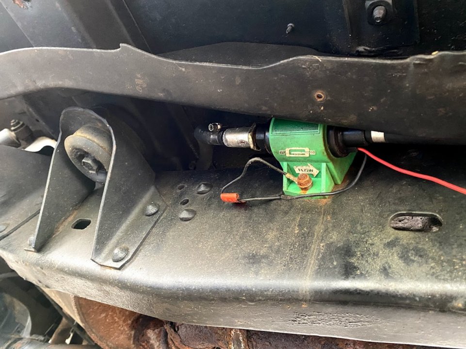

I thought it was road worthy so I took it to work only to have it loose all power as I was pulling into the parking lot. I was able to limp it home 10 miles at a time. I kept finding that air was building up in the fuel filter and opening the water drain and letting it out would buy me a couple more miles. I found a loose hose clamp on the inlet of the electric fuel pump, I am hoping that was the issue. I let it idle for 30 mintues and there was no air in the water drain only fuel. Lets hope its fixed.

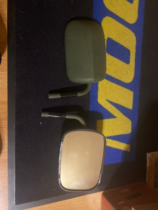

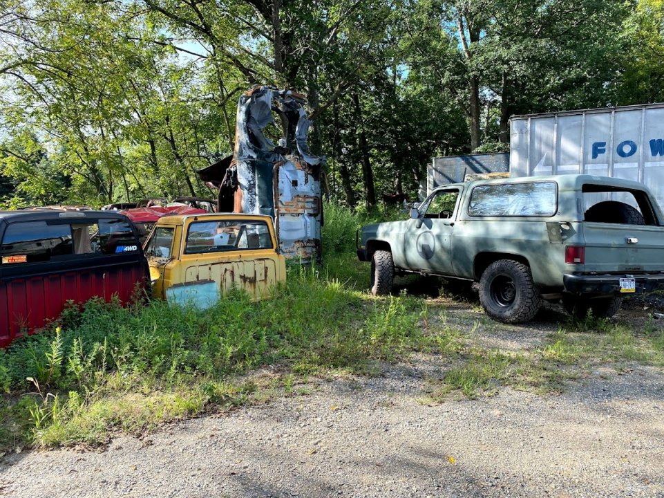

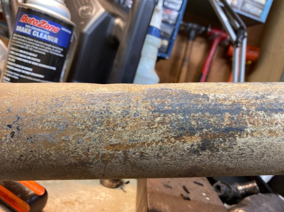

Ive been slowly working on this truck. New mirrors (originals were loosing the reflective bits), tail light lenses (rockauto had a clearance for $12 for a set!), and I had a new rear driveshaft made after noticing it was slightly tweaked while doing the ujoints. Bonus junk yard photo!

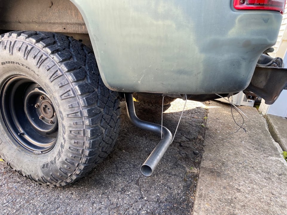

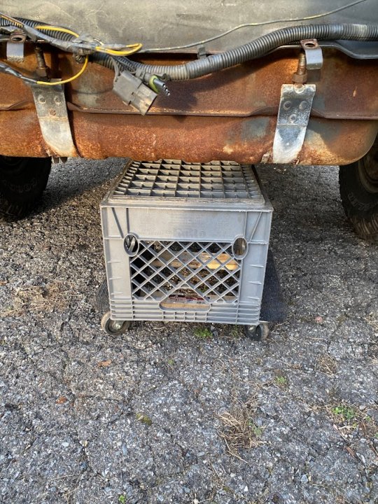

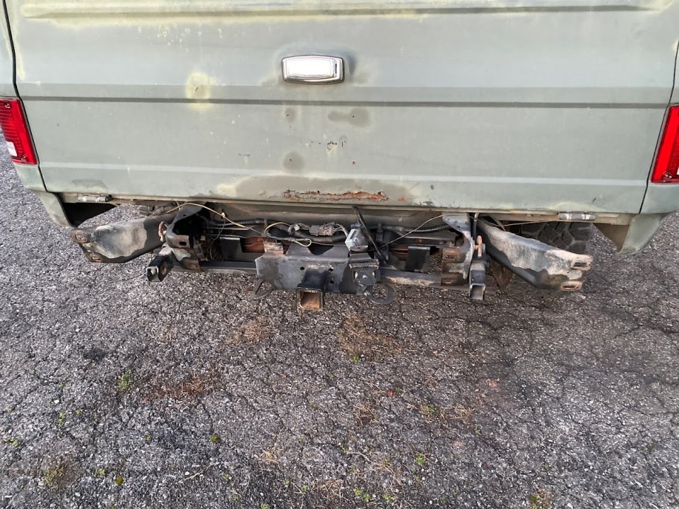

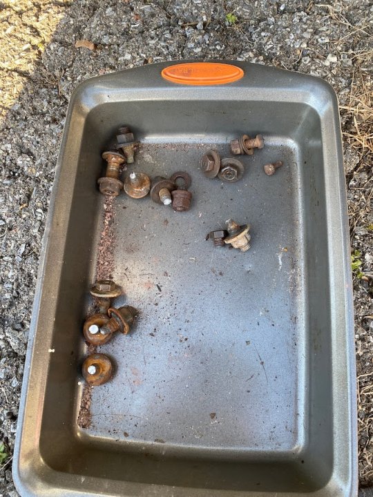

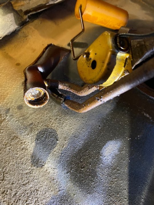

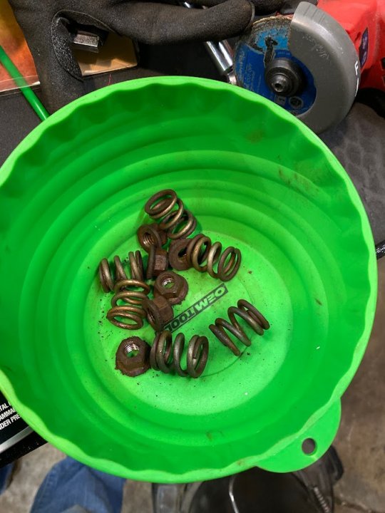

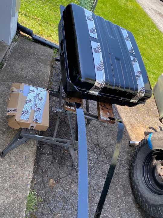

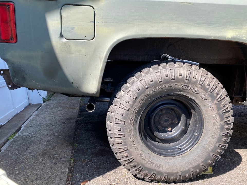

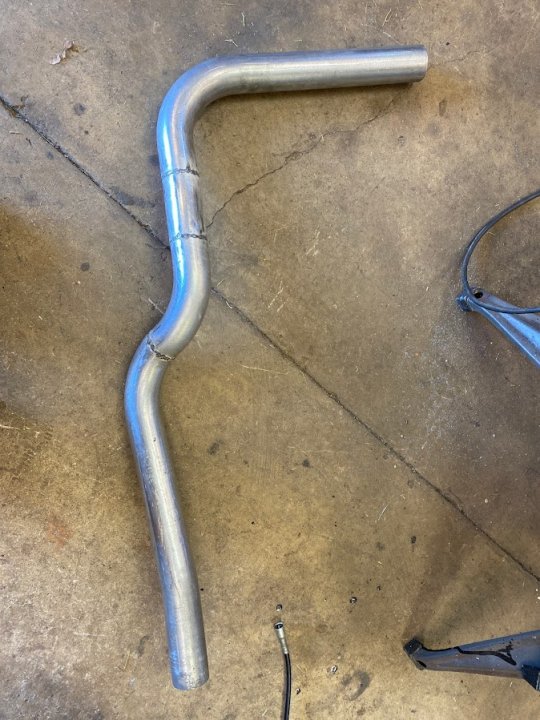

I got tired of the fuel gauge not working and the exhaust leaks. The manifold collector bolts came right off, I was pumped thinking I was in the clear. I had to remove the rear bumper as the fuel tank shield was welded to the trailer hitch by the po, those bolts fought me for a couple hours. The fuel sender was pretty crusty and tested bad. I also cleaned the little fuel wire disconnect connection. I painted the fuel tank with por15 while it was out, tested the fuel gauge and its now working great. The exhaust kit I got was for a v8 blazer from LMC which fit perfect using the original exhaust hangers (except the little muffler brackets that I deamed unessesary) until I got to the tailpipes which ended up way to low, I got them all tucked up with a bit of fab work.
