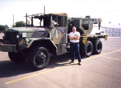

I can tell you about it Clinto, the oil tank and tool boxes are missing. I have that pic in my file but never contacted the owner.
