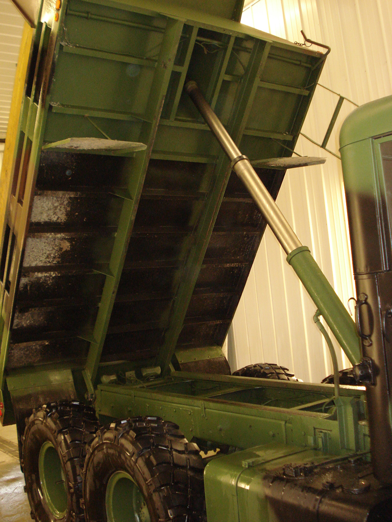

I have a 1972 M35a2 with a Cargo bed and need to convert if to a dump truck but want a hydraulic dump because I know I will frequently be overloading it and it may be a bit much for a electric hoist and the cargo box.. Any suggestions?? the current box is in near perfect condition with a full canvas and seats, it would be hard to destroy that and make a dump.. it may be wise to sell the box with all the goodies and buy a new hoist and box .. one like this, does anyone know what is needed to hook one up? anyone have parts to do? thanks

Welcome , do a advanced search for dump conversion , there are several good threads on doing this . A belt driven pump off the motor with a electric clutch is a good option to the PTO set up.

Dump Kit......
http://www.ebay.com/sch/i.html?_from=R40&_trksid=p3984.m570.l1313&_nkw=M35+Dump+Kit&_sacat=See-All-Categories
Fellow Member is selling these nice kits at a reasonable price......

If you have any big truck salvage yards in your area you can probably get everything you need off a old state plow truck with a rusted out box pretty reasonable .
