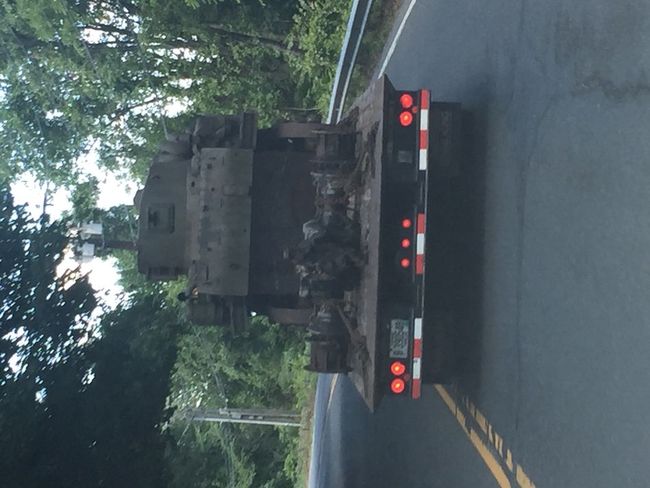

Stuart M3A1 SN 10189 was built at ACF-Berwick in December 1942 as part of Purchase Order T-3345-1 and was assigned Registration Number 3025398. Still has the original data plate. Long ways to go but it's a start! Would appreciate any and all advice as well as any help locating needed parts. Thank you!

Nice!!! So you bought the one the musuem in Danbury had? I was wondering where it went. When it is done, you should bring it to the Battle for the Airfield reenactment at the Collings Foundation.
The CF might even be able to hook you up with parts. Are you on the G503 board? You will probably get more help there. Good luck with your project!! :tank:

Yes, that's the one. I posted on the G503 also thank you. Here's a list of parts I'm looking for if anybody has anything please let me know.

Steve Greenberg may have some of that stuff. He is on G503 and has a M3A1 also.
NDT
10,432
6,476
Camp Wood/LC, TX
Advice? I will echo what I'm sure you have already been told: You will need to fabricate much of what is on your list. Find an extremely competent sheet metal fabricator/weld shop near you and make friends with them. You will need to travel to someone with a similar tank and make detail drawings of everything you need. Parts like "turret basket" are just not on the loose anywhere.
