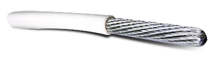

There is a wide array of types of Mil spec wire. I've purchased this style from Aircraft Spruce before
The last digits are gauge and color
