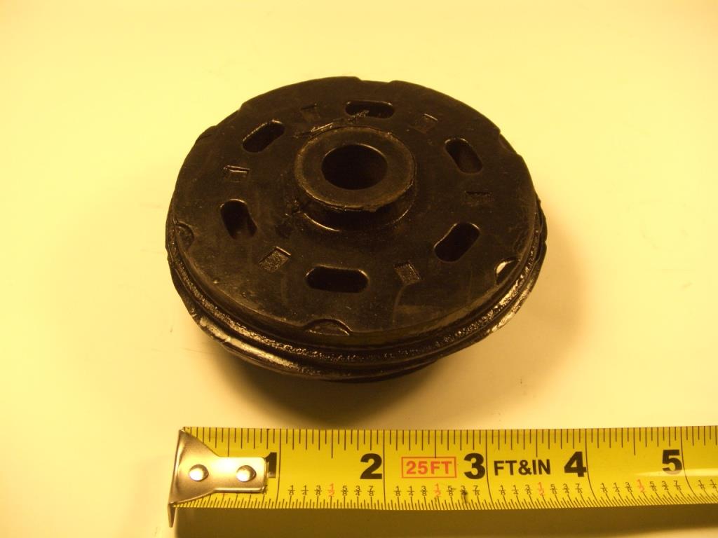

Ready to start engine removal. What to do about the old-age senile isolation mounts? I see left ones on an auction site (right and left are different sizes...) and they do not feature prominently on any vendor's list. Are there generic replacements that will work as well?
12,596
1,127
They are different for the M44A1 and M44A2 crossmembers in the front. Rears are the same for A1 and A2.
Go into the TM and find the NSN's for what you have and do an internet search. They are available pretty inexpensively. I would never reuse them if they show any cracking or dry rot.
A1:
A2:
EDIT:

TM 9-2320-209-34P Lists the following
In Figure #2 Page 6 Engine Mounts - Multifuel (This is for LDS427-2 Only)
4 pcs 7538640 Mount, Resilient, Front & Rear For LDS & LDT Engines
2 pcs 7538641 Mount, Resilient, Upper Rear 4 pcs needed for LDT Engines
2 pcs 10872097 Mount, Resilient, Used on LDS427-2 Only
Figure #5 shows the requirements for LDT465 engines.
Hope this might clarify the use or need for P/N 10872097
