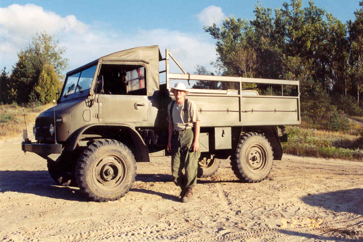

Hi John nice 404 rig you have there.
I am also a newbie around here but I love all millitary rigs wit a special soft spot for all the Unimogs.

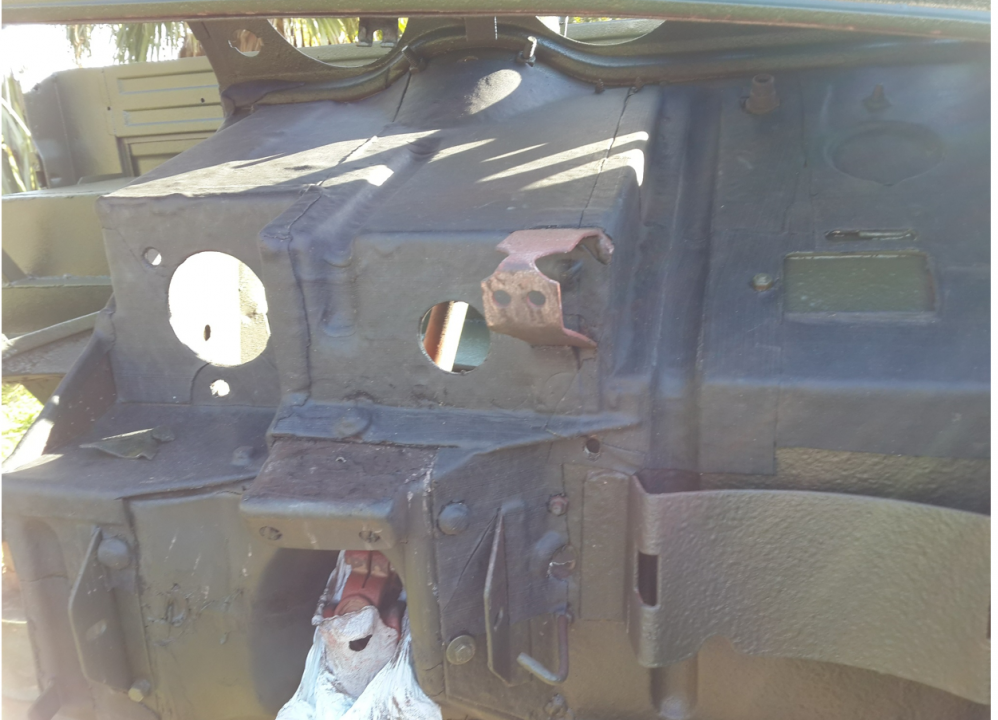

The unimog was the base vehicle our military used to create the Buffel Apc.
I just used the standard unimog cab (had to refurbish and fix used cab) and spares to return vehicle to its original state.
I have made some changes to cab however to suit my needs.
I have posted some pics of the vehicles military condition as well as some of the current state it is in.

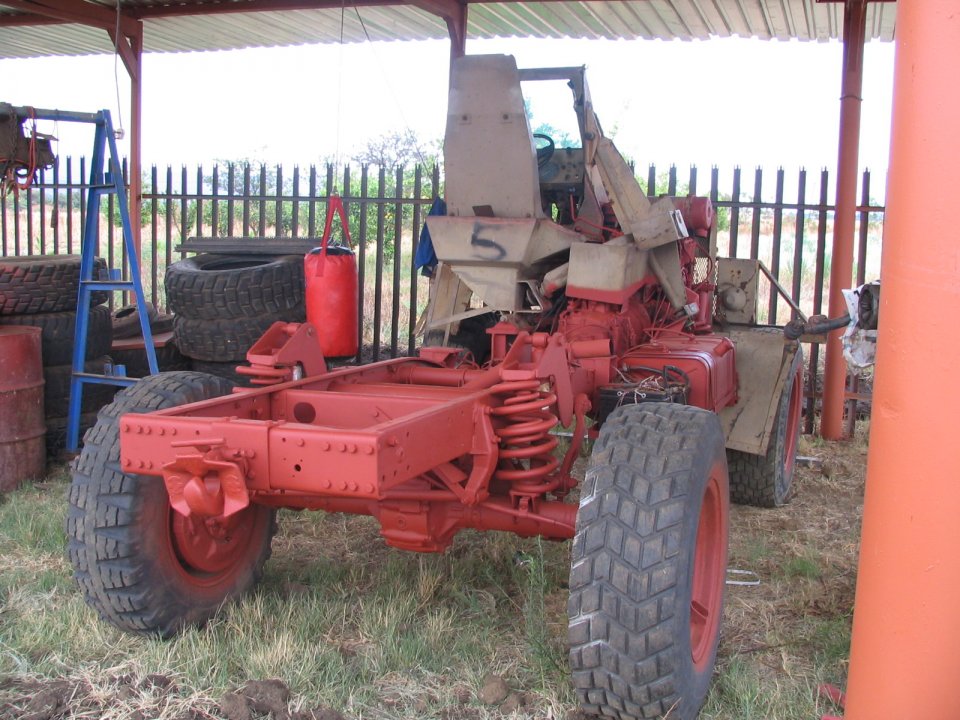

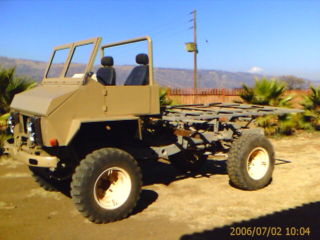

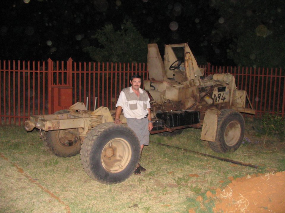

Hi There sorry I havent been very active . I will post some pics to show what I have been doing since I bought the old Buffel from the SADF at auction .I bought the Buffel in November 2005
3SAIInfantry
47
13
Pretoria South Africa

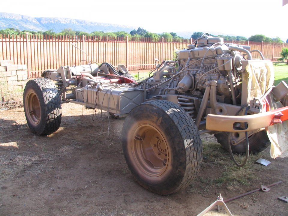

at first there wasnt time nor much money to work on the Mog/Buffel so I did the next best thing and drove to every hole and obstacle in my area and played as much as I could .
I did start on fixing rust spots and just covering it temporaily with undercoat and later some paint I had in my Garage

In 2007 I had to replace the clutch pressure plate and release bearing and also did a better job of respraying the Chassis at the same time .

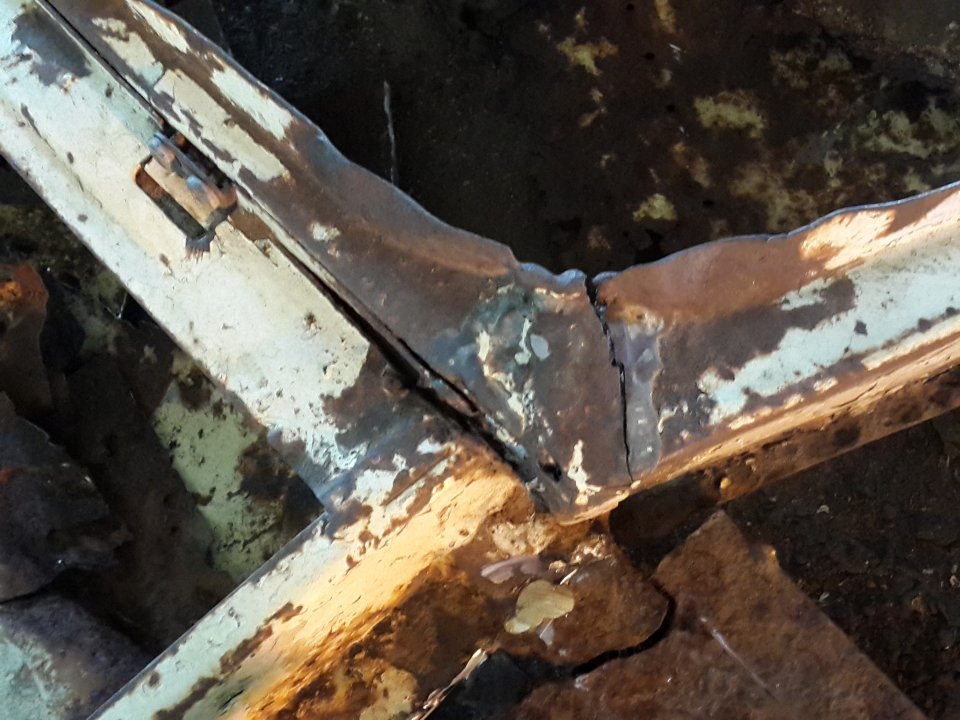

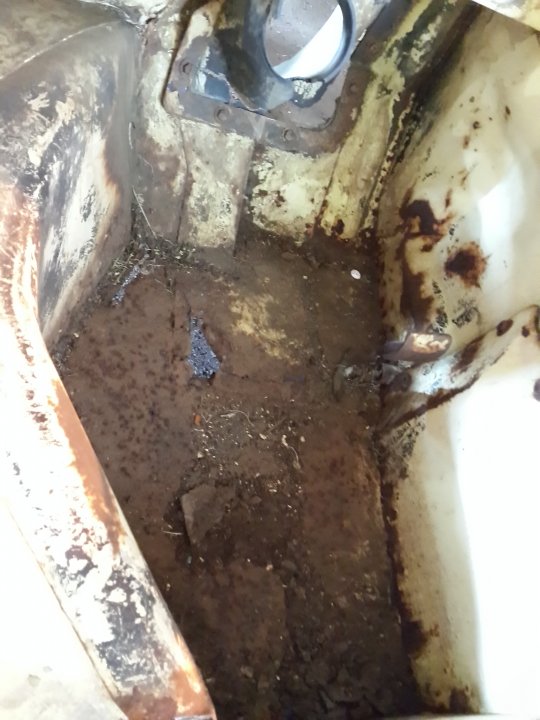

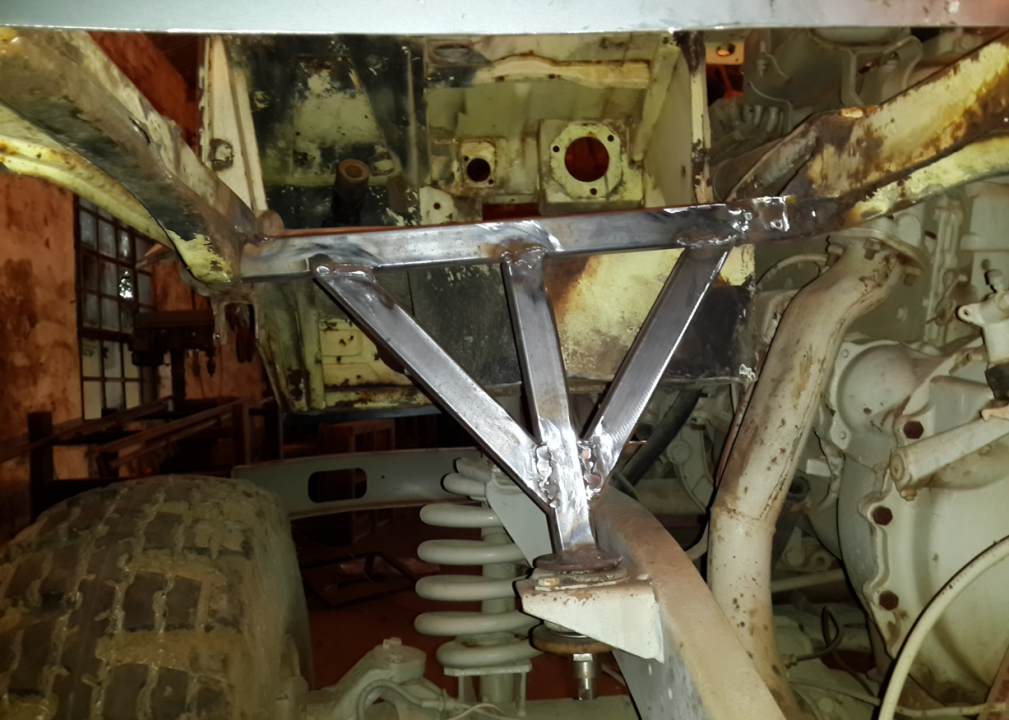

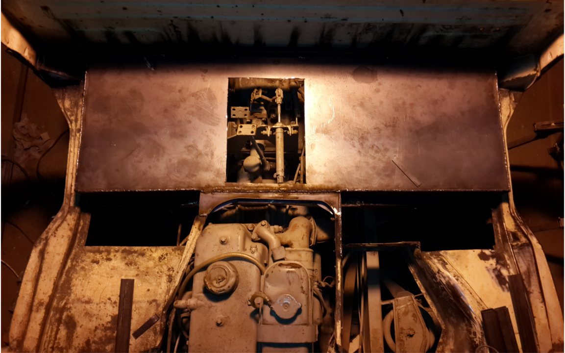

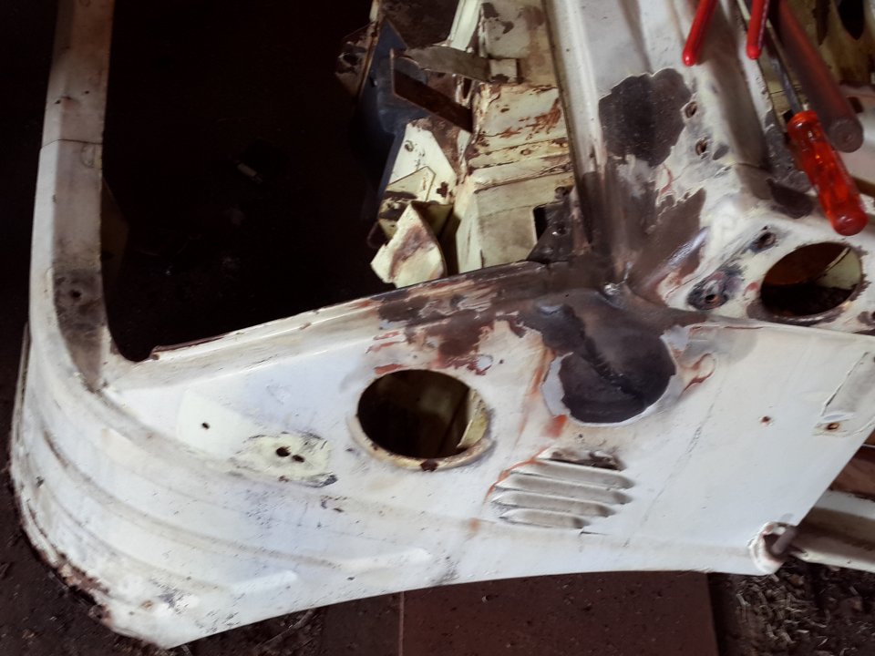

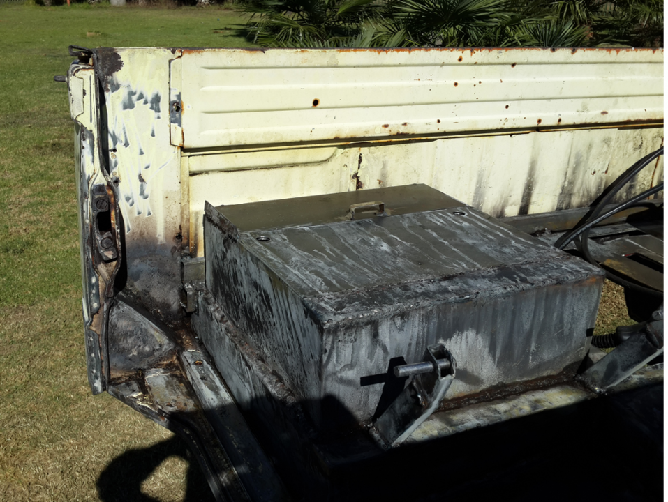

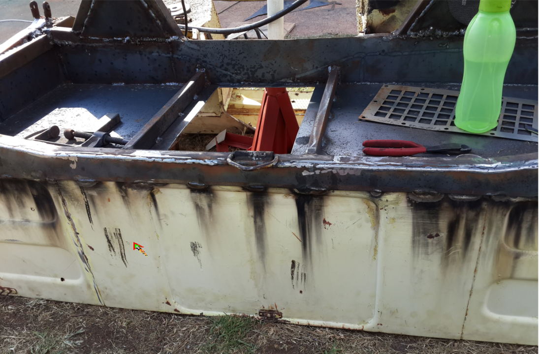

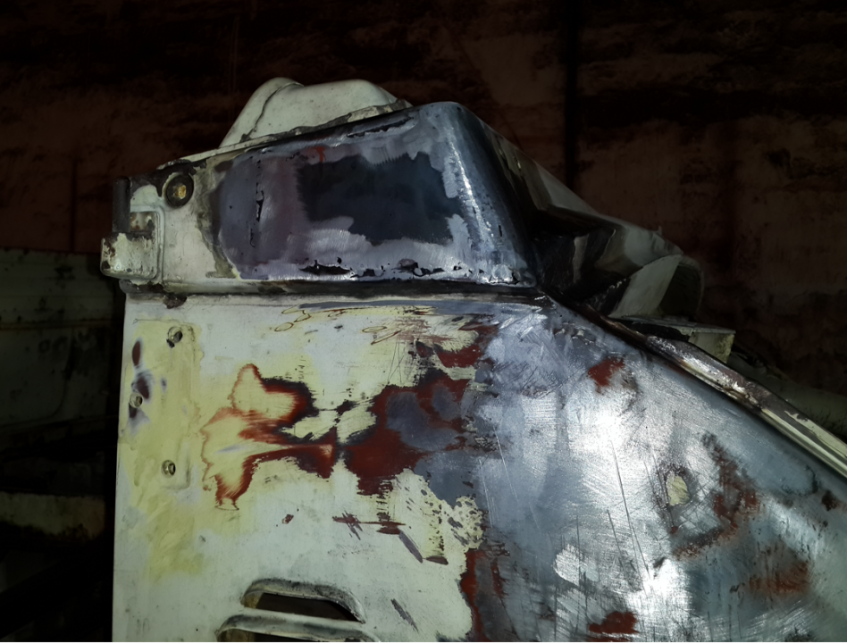

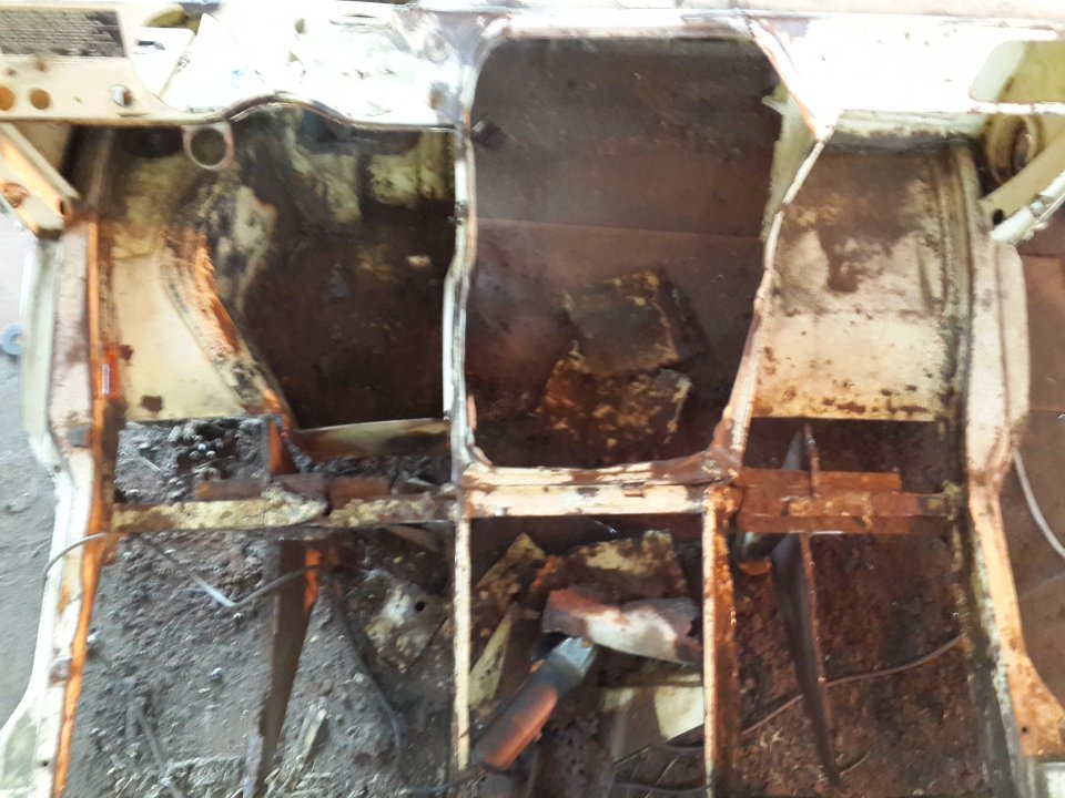

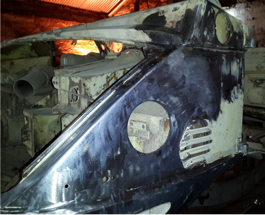

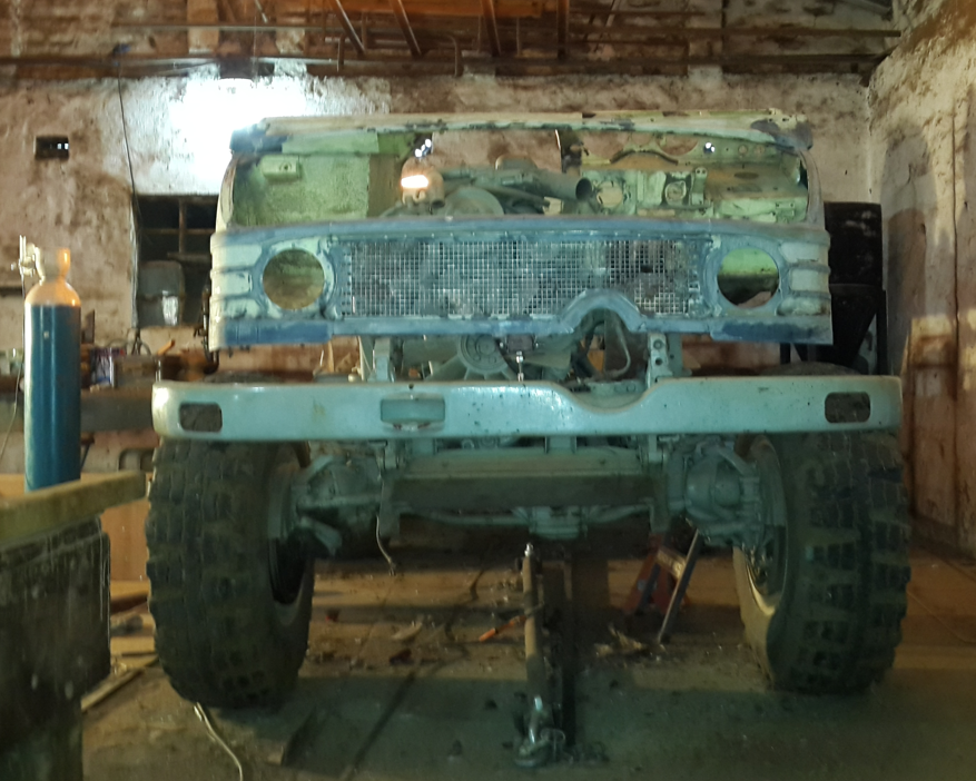

for a long time I saved money and bought spares to later rebuild the complete Unimog. only in 2014 I was lucky enough to get a Unimog cab that was discarded by a millitary unit of our Spes forces , our Recces . the cab was so damaged no one wanted to even try to refurbish /fix it. the complete subframe was bent broken in 7 places . I removed it completely and built a brand new subframe as wel as used 2 sheets of sheetmetal to build a new floorpan as well. it took me and my son in law 3 weeks of work 12 hours a day to fix the cab to be in a usable state for my unimog. firstly some pics of my starting point with my (sic) new cab

new cab mounts and subframe built
I also lifted the cab mounts with 70mm as I knew I will at later stage upgrade my wheels from 12.5 by 20 to 14.5 by 20 .

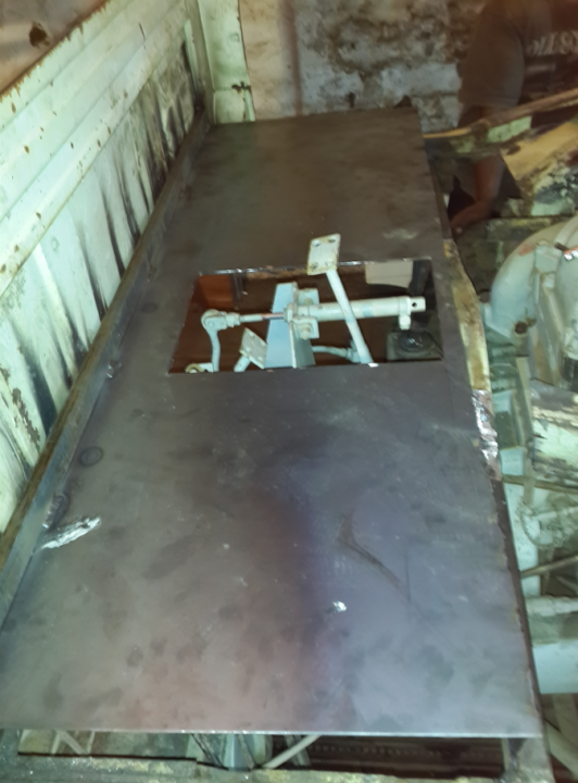

test fit of lifted cab on chassis before we started to rebuild the floor completely .

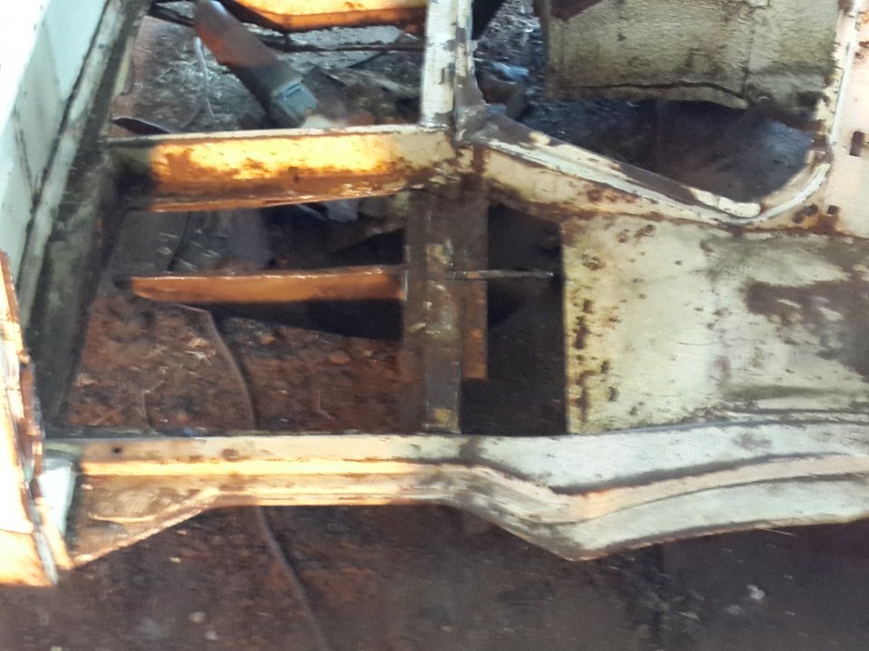

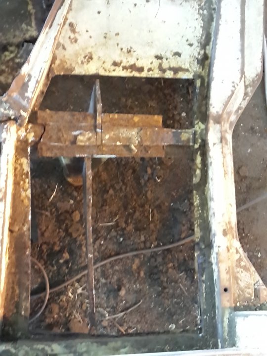

before starting on new floor and seatboxes

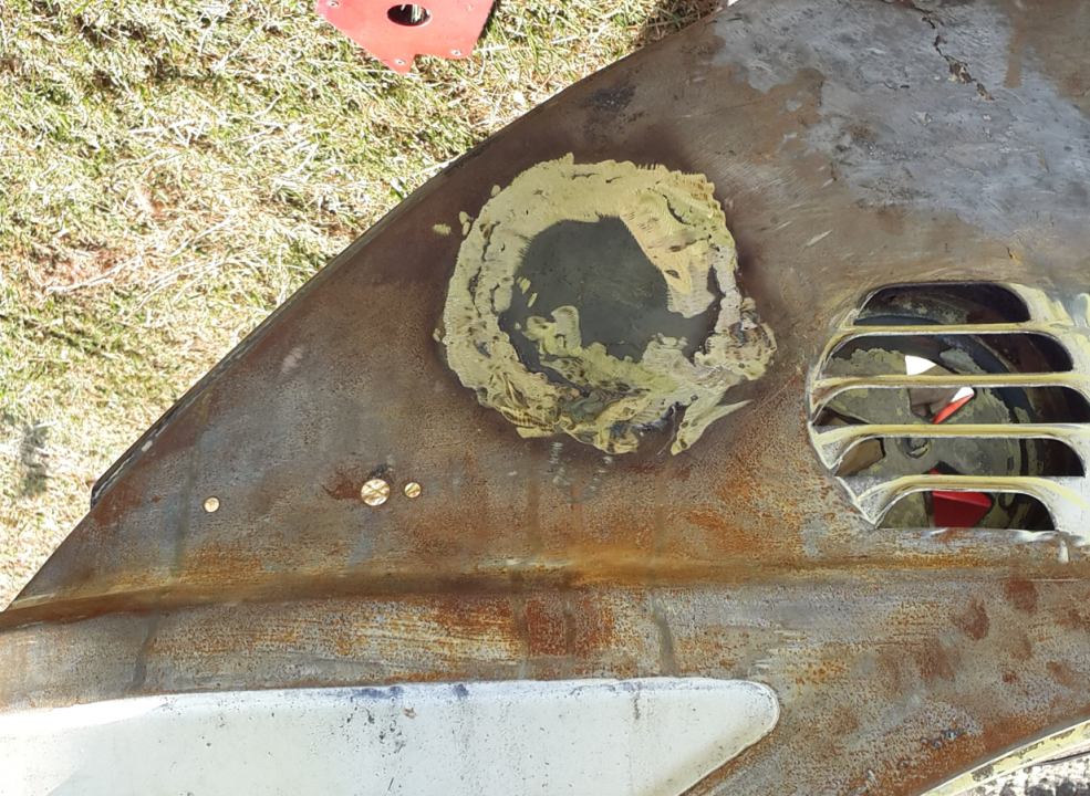

filling that pesky hole
welding and strenghthening the floorarea

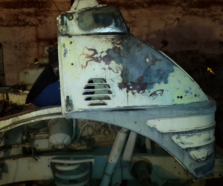

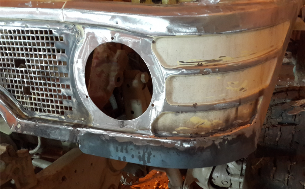

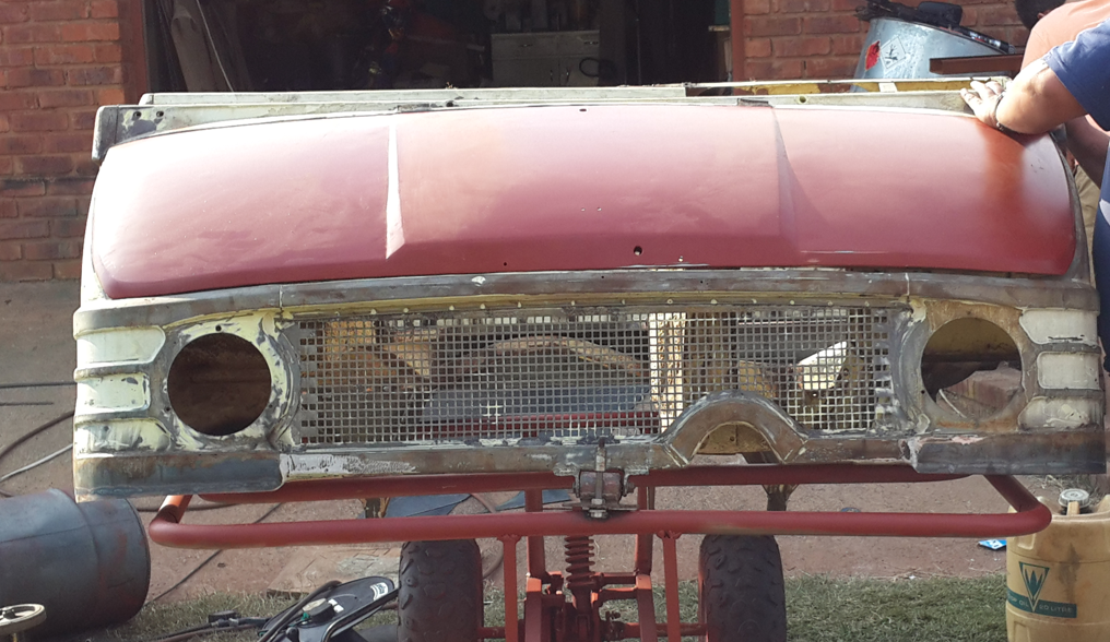

test fitting refurbished bonnet

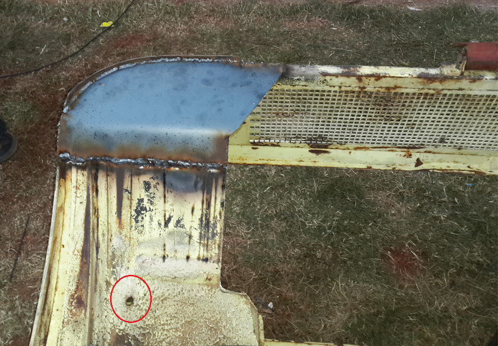

more new material added to underside of cab in front corners . note in red circle one of the 9 bullet holes that was in the cab in different places . this cab truly belongs on my Buffels chassis .both cab and chassis has seen their share of ambushes and war excursions in the Bushwar just like their owner .
the only piece of the old subframe that I could reuse circled here

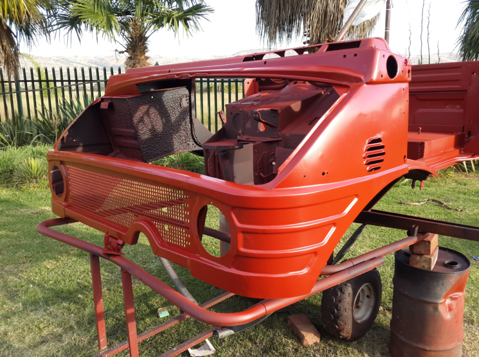

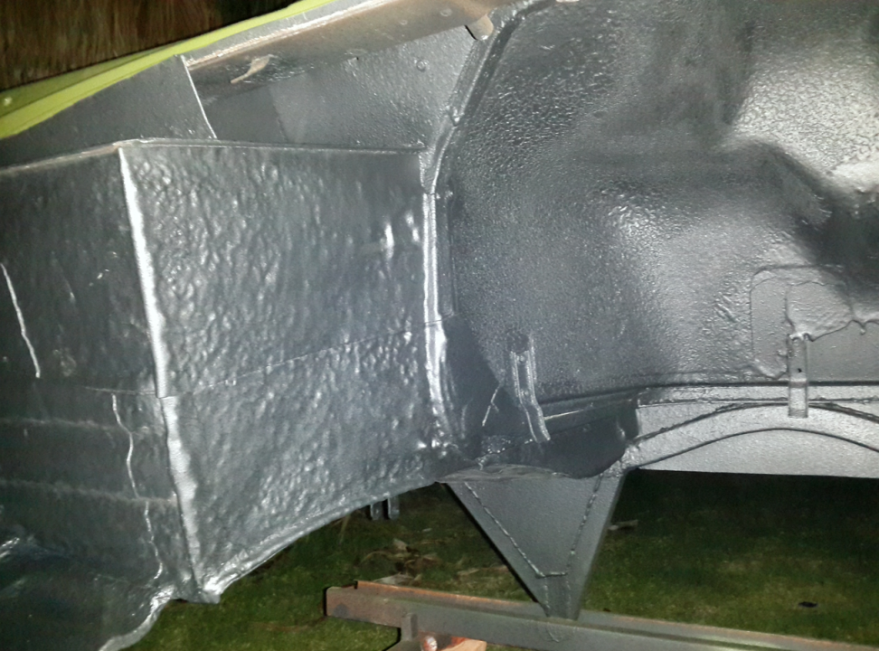

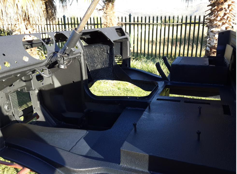

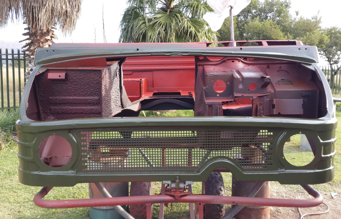

in pic below you can see the Deoxidene rust coating after aplication on the righthandside seatbox.
Inside 4 coats of rubberizing applied
undercoat applied
I asked paintshop to mix this old Bedford army green for me as I deem this to be the only collour that would do my Mog Justice when you know the history behind all the parts that was used to build it.

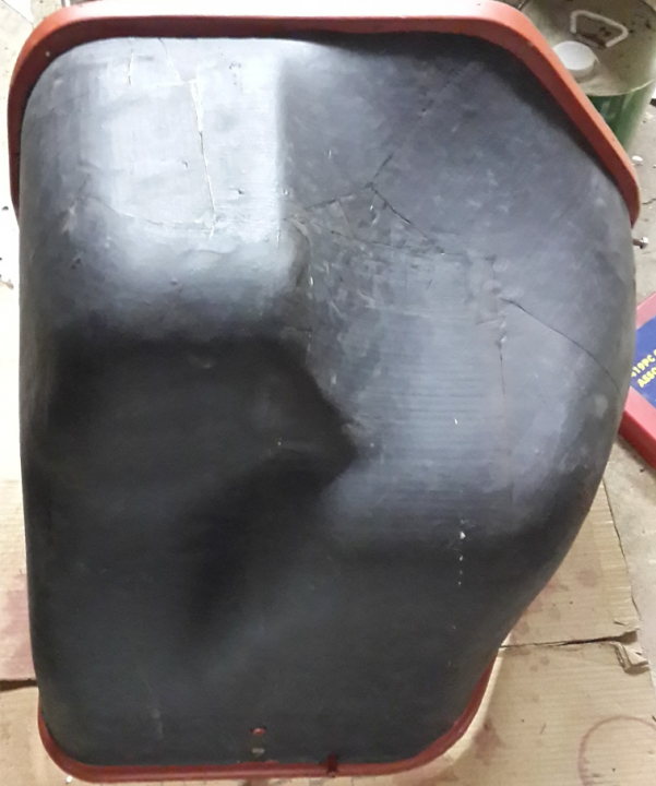

covering Doghouse and firewall with dynamat sound and heat barrier material
followed by 2 more coats of rubberizing

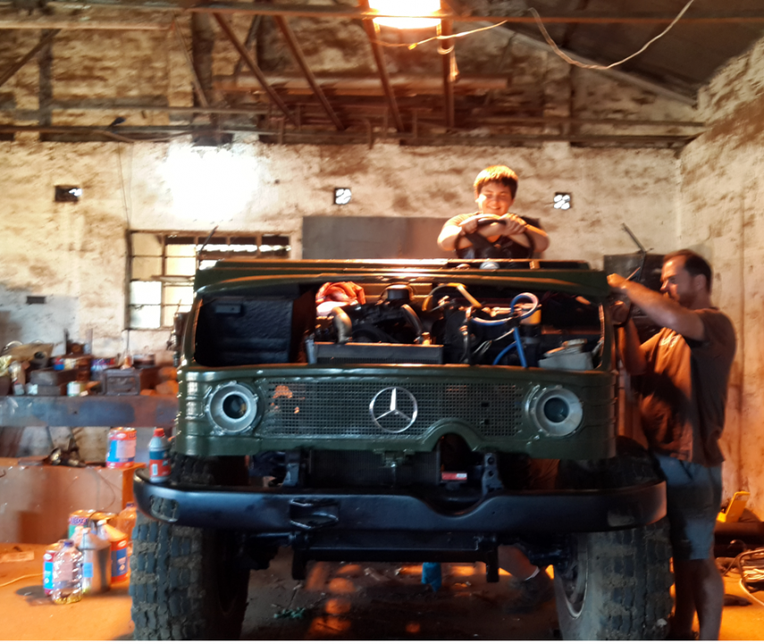

Cab fitted and first drive with new Cab

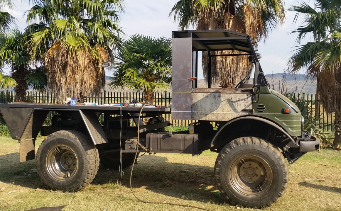

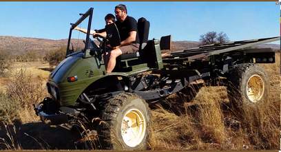

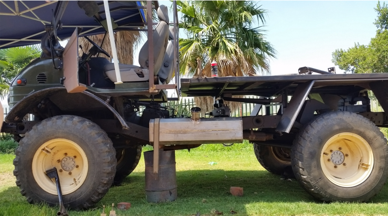

in 2015 we built the roof structure for the cab as well as added some room in the back of cab to accommodate the VolvoS40 seats I mounted for easy long distance traveling with Mog
Fitting 2 by 132 liter stainless steel dieseltanks one on each side of mog. also note added space behind the Volvo seats and newly made steel doors.

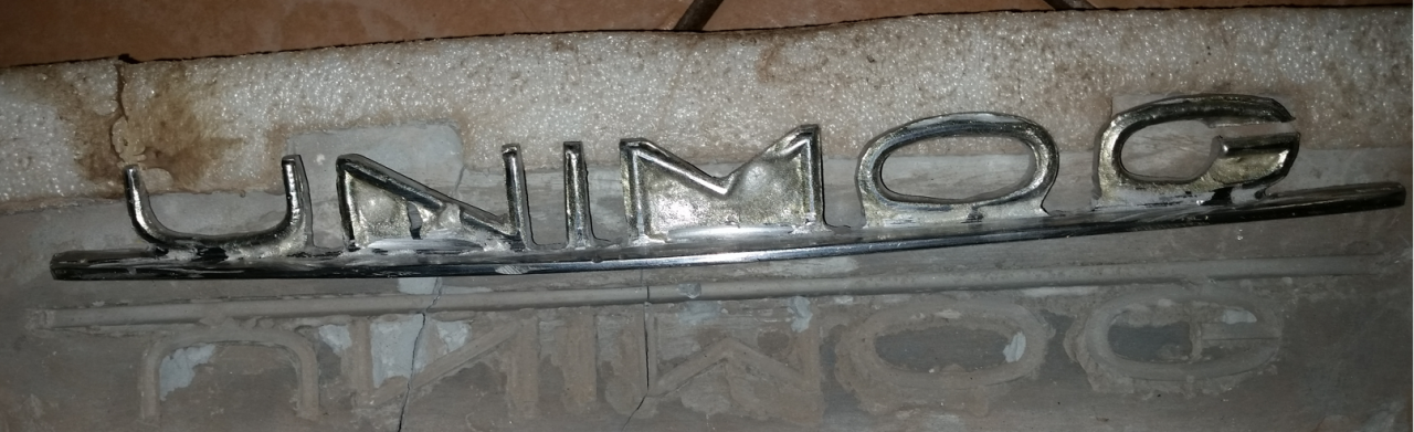

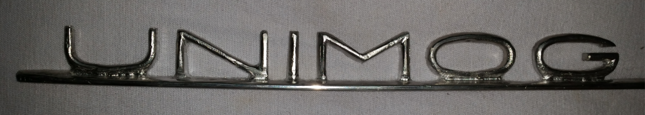

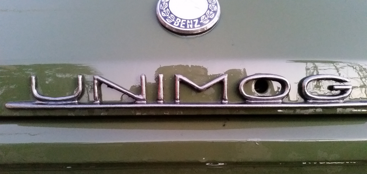

Making my own unimog badge by using leadcasting .first try below
if at first you fail try try and try again
Closing cab
custom made bonnet badge in 2015
custom made centre console built and installed in the roof
3SAIInfantry
47
13

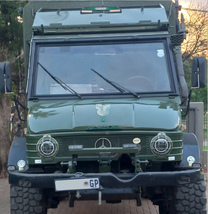

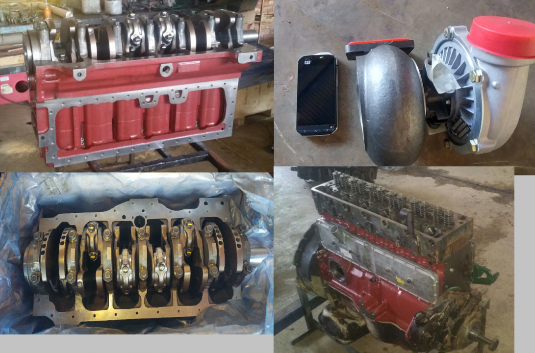

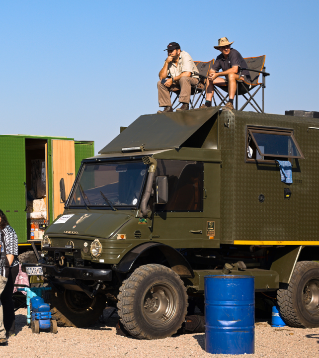

in 2017 the original OM352 motor was due for rebuild or replace. after carefully doing some investigation it was just 2000 rand more expensive to buy new OM366 turbo assembly and new turbo and reuse my old 352 head after rebuilding it completely. so out with the old and install new engine with turbo .

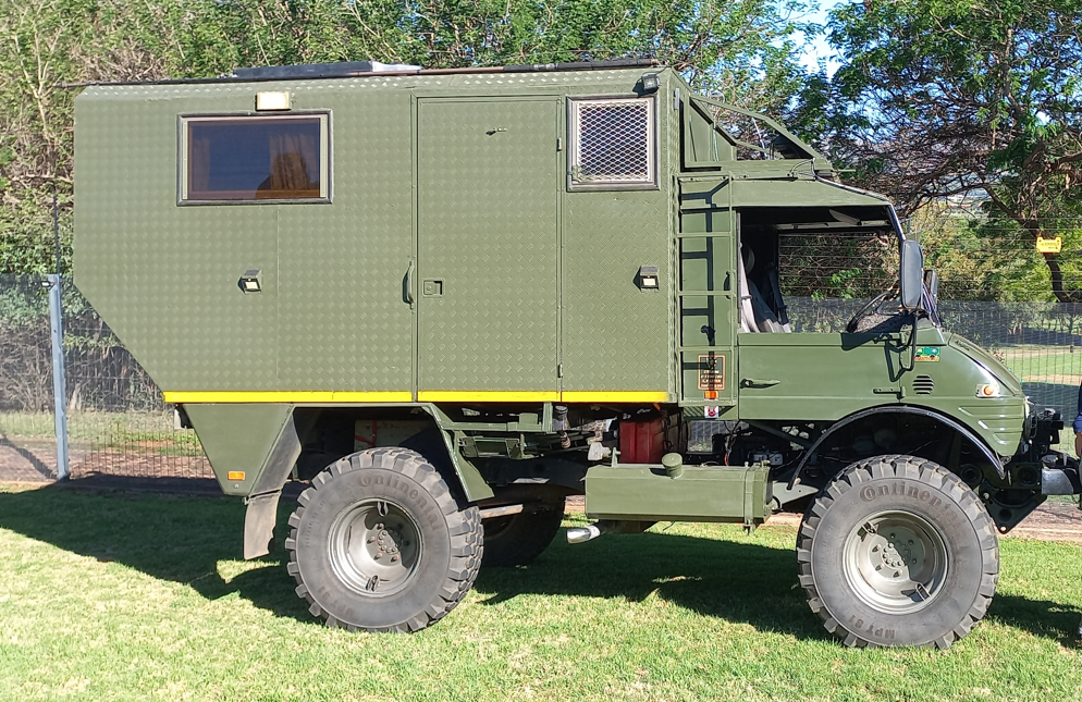

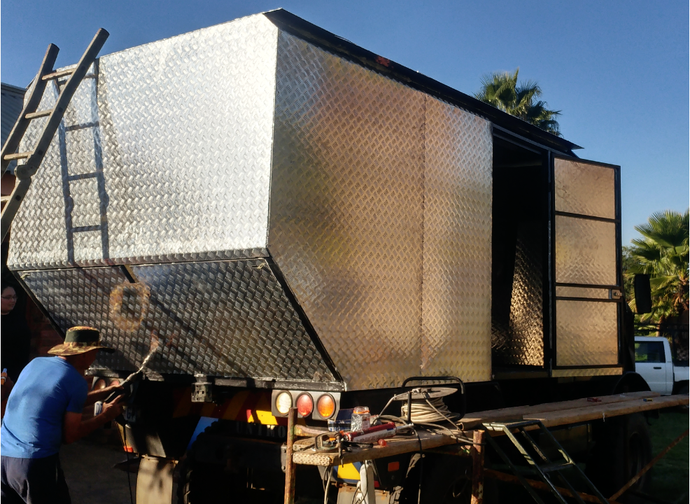

in 2018 we started building the steelframe aluminium skinned Camper on the deck.

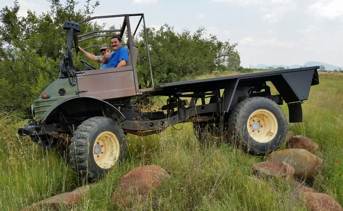

finished camper in use at Cars in the park event at Swartkops raceway . sitting on the roof myself and my friend who helped me build the Camper .
my Moggie at Unimog 75th celebration event in SA at Brauhaus am damme near Rustenburg
most recent pic of my Unimog after replacing 12.5 by 20 wheels to 14.5 by 20 continentals to accomodate the 366T engine a bit better .
