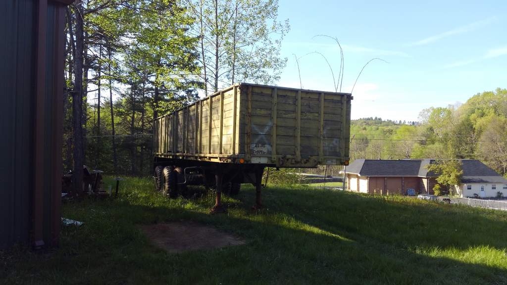

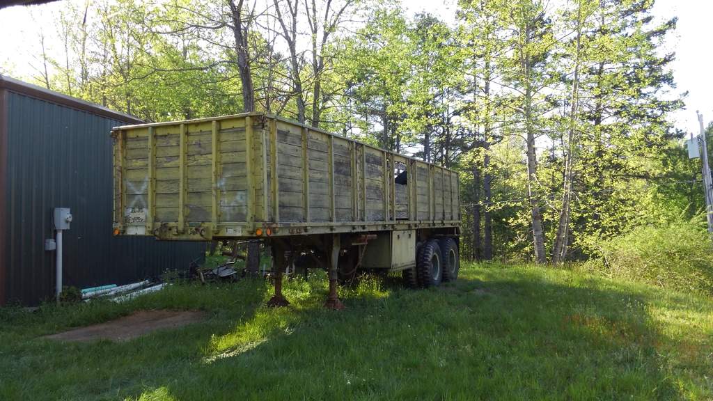

Scored an awesome M127A2 trailer:D, needs some love then it will go perfect with the museum's M52 tractor. When I got it home the wife said, and she doesn't use bad language, "what the he77 is that" and before I thought the dumbest thing I ever said came out of my mouth "I bought it for $ worse case I can scrap it for $$$$" to which she replied "that's a d@mn good idea".

1972 model, all the wood needs replaced and the two back panels are missing so if anyone knows where some are in any condition that can be purchased or someone willing to take some good photos and measurements I can make something to replace them that looks close to what was original. Thanks in advance.
P.s. recovery I'll need help with that move.:whistle:

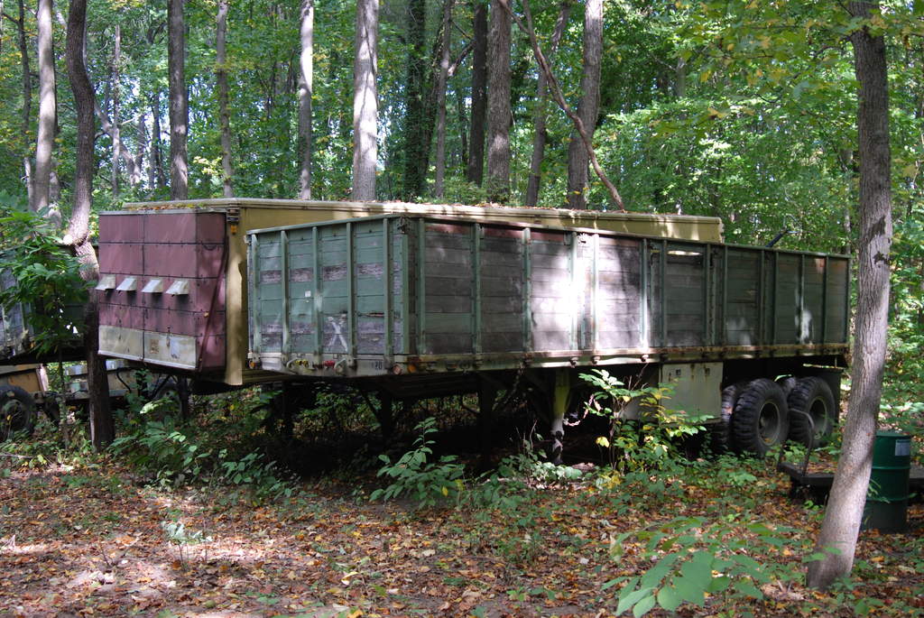

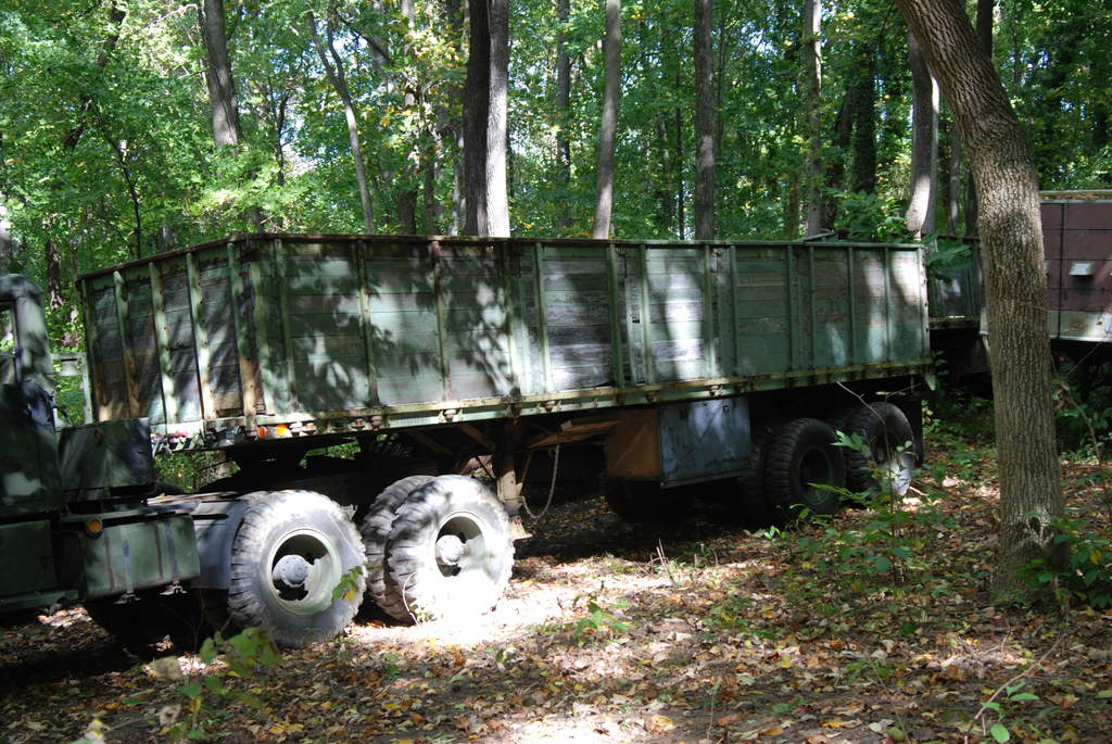

The back panels are specific to the trailer. All the left ones I have seen have wooden boards. Of the right panels I have seen two kinds. One has wood like the left panel, and some are made with a fiberglass covering over filler. All the right panels have medal rungs so one can climb into the trailer.
The decision is how do you plan on fixing it. White oak works well in place of mahogany. The question will be to cut the new boards as it came and secure them with the metal strips or install the new wood with self-tapping fasteners. The sides use a lap joint with a single bolt into a T-nut on every upright. That makes for a flush inside surface. Replacement panels made in later years used nuts and bolts that snags cargo when loading, ask me how I know.
When this immoderate weather abates, I will try and take some picture of some rear panels.

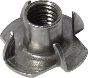

The side panels use a T-nut. They may be able to be reused. I would spray them with Kroil a couple of times over several days. Then use an impact gun to remove them. If the wood doesn’t hold, vice grips will come in handy. T-nut are easy to come by.

Thanks for all the info scrounger, just got it pulled home and had to leave for work for a couple weeks, didn't get the check it out real well. So much of the wood is gone it would be best replace it all to look uniform not patched. The tool box seems to be in pretty good condition, I will have to patch a small hole in the bottom and the hinge is not operational, soaked it down with some penetrating oil. Maybe I can put some heat to it and get it working. One of the wooden landing pads is still intact enough to copy and make new ones and the hardware is there for the second one. Civi lights all work perfectly on the way home but when I hooked it to the deuce to test the 24v side no park lights, right signal fine, left signal flashed the park lights. Tires are shot to-the-point tread came off of one dragging it home, so I will be bumming tires, don't see it seeing much service so we'll be looking for tires about 25% tread I think it's 11-20's on 5 ton wheels? Got a couple projects ahead of this one but I'm sure to piddle with it along the way.
