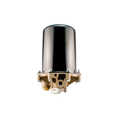

Re the noise coming from the dryer- I am assuming it shouldn't be groaning- its the older style that looks like a big round heatsink, thinking about this... good idea?

there is nothing wrong with the old style dryer, it has a lot if very good design features, and it can be serviced by you without any special tools or parts, unless y0u need orings(i did a video on this)… the new style uses a cartridge so it is easier to service, which is the only thing going for it… A cartridge that you must purchase and change every year… in the interest of making it smaller, they sacrificed desiccant volume and cooling surface area… i have not seen an old style unit fail, even with a bunch of oil being sent thru it, they still seem to blow out a lot of moisture… i have seen 2 cartridge types fail from neglect and deposit filter media into the air system when their cartridges ruptured… I had someone give me a pair of the old style units. I put them together in parallel on my shop air compressor to dry the air… they work great!
