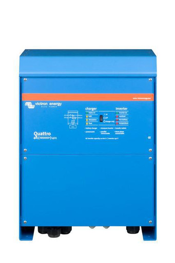

I run Victron. I think it does what you want.
2 shore powers in.
Can run transfer
Can pull from battery while charging
How much amps do you need for your battery and what voltage?
