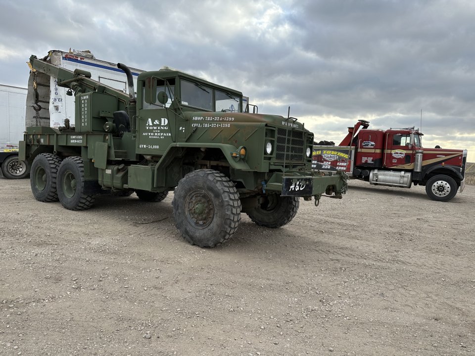

View attachment 895944Our M936A2 doing work, we use it for recovery,towing work along I-70 in Kansas.

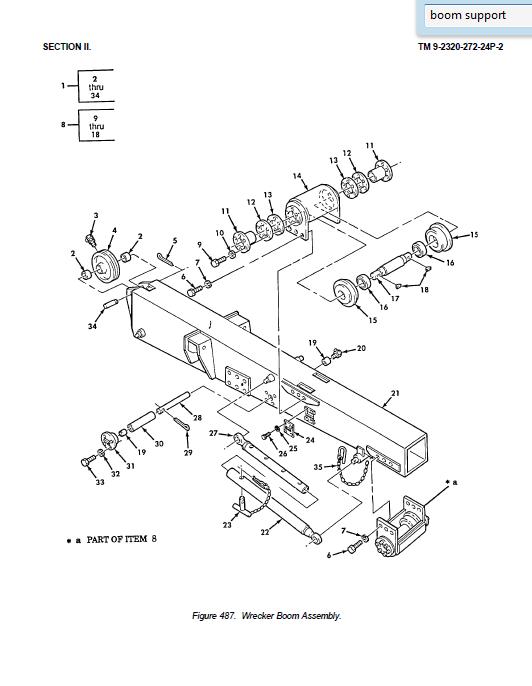

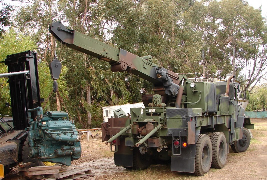

One "gotta ask" from me... Boom Support. The tubes on the left and right sides of the boom so that the hydraulics aren't supporting the boom. It's a heck of a neat looking picture but those supports keep things from going wrong. Taking a turn pulling something could cause the rotation manifold to "give up" and rotate your load out beside you.
(Those gizmos sticking out back in the picture below.)
#27 and #22 in the TM picture above
