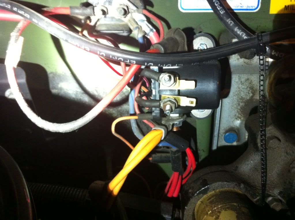

I'm going to replace my Glow Plug Relay tomorrow and I want to make sure that the one that is in there now is the correct one. Does everyone's GP relay look like this?
My vehicle has been taking longer and longer to start and finally bit the dust. Once it started it ran like a champ so I don't think it's a fuel issue. Thanks in advance for the help!:p
See this pic: http://i149.photobucket.com/albums/s62/raf32/Glowplugrelay.jpg?t=1296968295
DokWatson
359
Wasilla, Alaska
That isn't the original relay, its been upgraded to a regular relay so not every one will look the same. Your starting issue doesn't sound like its the relay, more like bad glow plugs or controller if it gradually got worse. But anyways, a good replacement is napa part number ST85 for your relay. I have the same thing.

The relay in your picture should work fine. I agree that you problem is just as likely to be glow plug card. If the glow plug card went, the glow plugs are probably fried as well.
