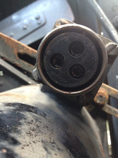

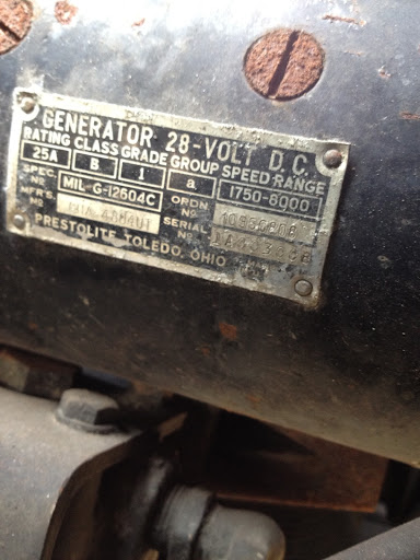

Hi
I have searched the forum before posting this. I know that it has been discussed several times. But I'm looking into how to polarize this specific generator...
https://picasaweb.google.com/102485965599153388520/Deuce#5733154942027588114
It has this plug:
https://picasaweb.google.com/102485965599153388520/Deuce#5733155081356924274
The short question is: Which terminal should have 24V+ for a short amount of time?
The terminal with most resistance to ground is the bottom left one. It's over 20ohm.
The two others have a resistance of roughly 6 ohms.
The two with low resistance generates only +1V DC when the engine is running. The bottom left one I can't measure any DC current on.
The car has been standing without batteries for an extended amount of time. This is why I think it only needs to be polarized.
Im not familure with the prestolite but my car sat for a while and i had to polarize my alt to get it workin. On that its the skiny wire that clips on that needs to be jumped it is the only input everything else is an output so i would start with checking the voltage of the terminals on the wire that plugs into that connection
