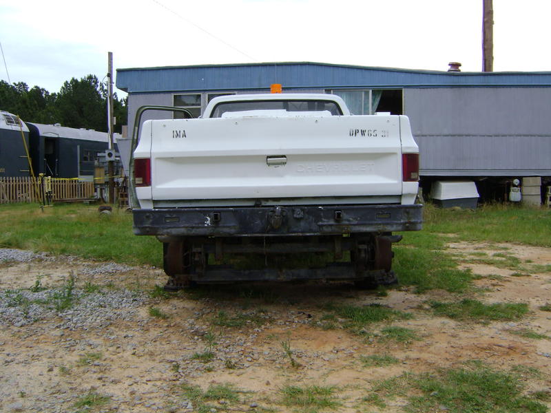

Hey guys,

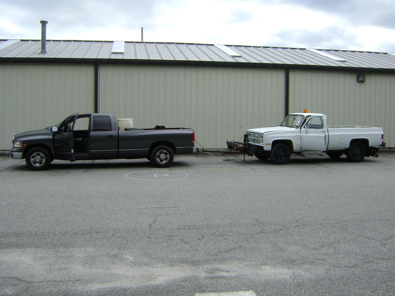

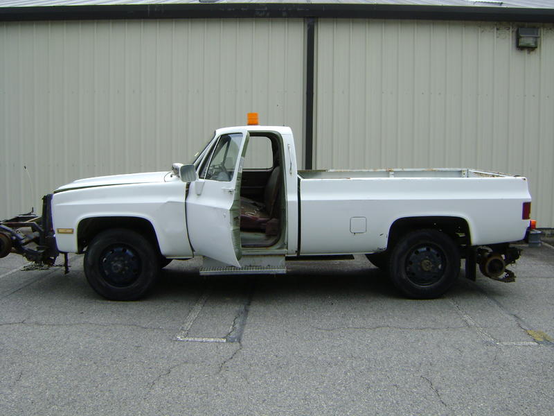

I picked up a M1008 from Ft Stewart yesterday. Blt 5/85. Ran, drove, has one belt squiling. Even had a full tank of fuel. :grin:

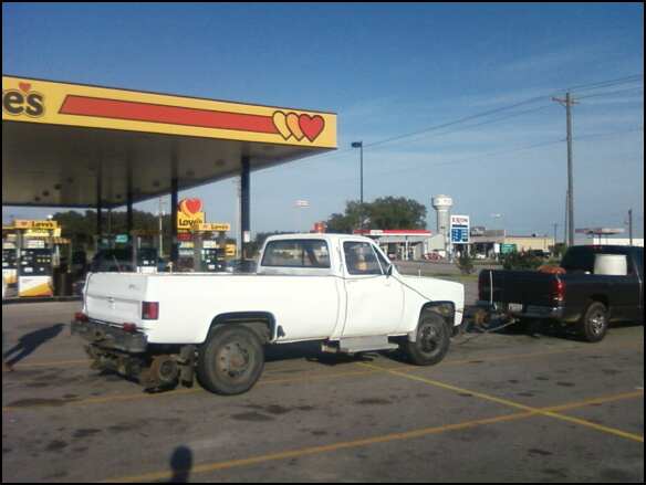

Flat towed her to the Air Force Base where I work. Figure I will fix her up and test here out on the bases rail system.

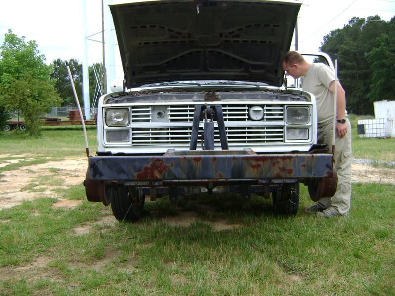

It has hyrail gear mounted on the truck, the rear is tucked away under the bed, but the front is this massive deal that removed the grill guard, bumper, and clevis mounts. So I used my chain clamps for the tow.
It has the offset wheels on it, so they ride the tracks better. They are 8 X 19.5. I bet they will be hard to find... :roll:

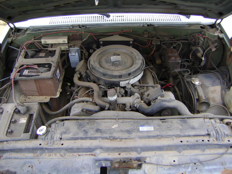

The only issue I have is the glow plugs are ka-put, I know there are several threads on the subject, so I will do some searching.
Also, this morning I had the parking lights and 4-ways on, but by the time I got to work they quit working- now I have no lights. Will be reading the manual on that too.
I know, I know, 'where are the pics?' I couldn't find the cable for my camera last night, or this morning. You really want pics, you can come over and help me look for it... :wink:
I'll find that dang cable and will post pics soon.

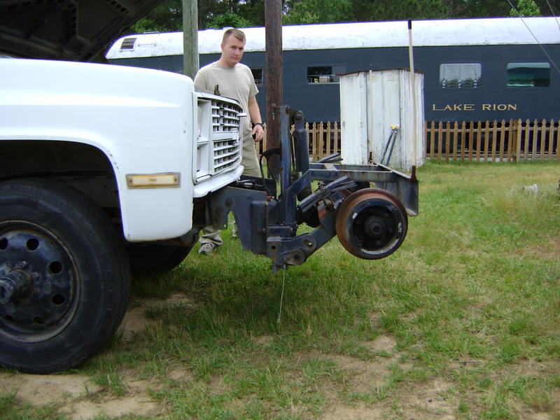

Kenny, I just had the front railgear down on the rails! :-D
The front works perfectly, although it could use a little bit more hydro fluid.

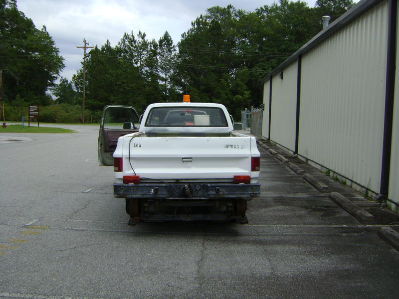

The wires to the rear pump were cut. Not sure why they did that... I'll have to figure it all out and wire it back together again before it is rail bound. Of course, the colors are different than the ones on the pump, and also different from the front pump. Can't make my life easy, can they?
Figured out the lights, there was a 20amp fuse in the headlight spot, Doghead told me it should be a 30. changed it, and am back in business.
It will start if you crank it several times for about 3 min total.
Also, the public works department put on duel exhaust. I don't think they came with that, did they?

I finally got my cable for the camera, here are some photos of the pickup at Ft Stewart. I passed this loader on the way there. It had bumper numbers and blackout lights. More to follow, including video of the truck on the rails!

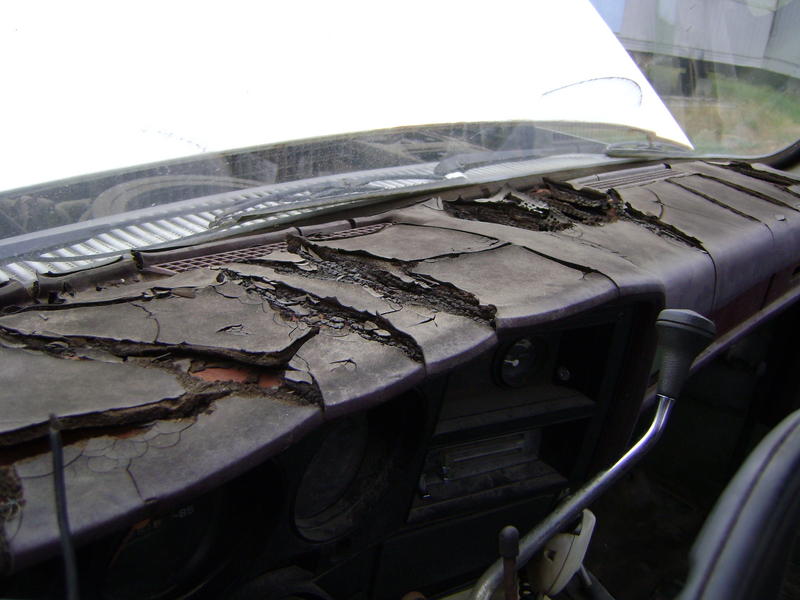

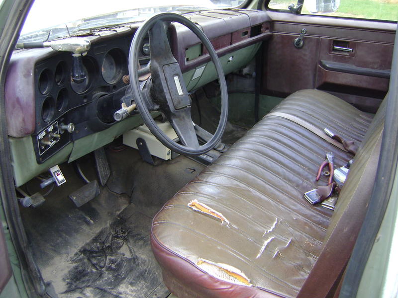

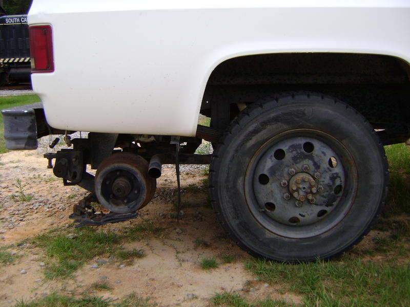

Heres some before the maiden voyage on the rails. Had all new fluids and filters, and the alts are almost new. Dash sucks. My buddy kept sneaking into the pics.

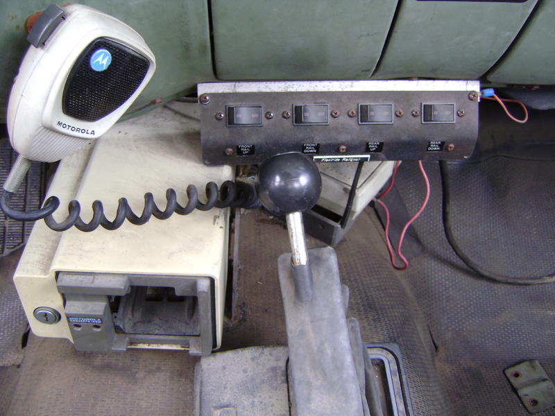

The rail-gear is hydraulic, with a separate pump for each end. The wiring plug was removed for some reason from the rear pump, I had to rewire it temporarily.

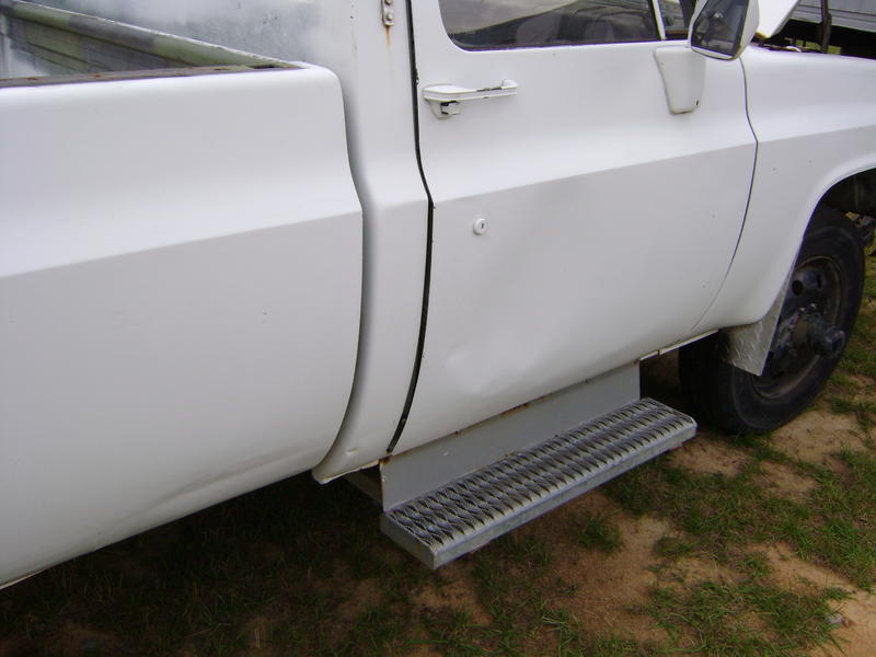

totally have seen hi-rail gear get fracked in impromtu recovery also the cab steps get beat to **** off road and sometimes come apart just by them selves.happened to a track inspector out here, non-reportable injury but we sure still laugh about it
