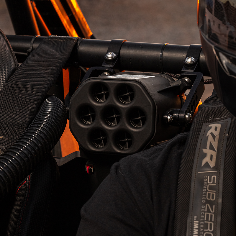

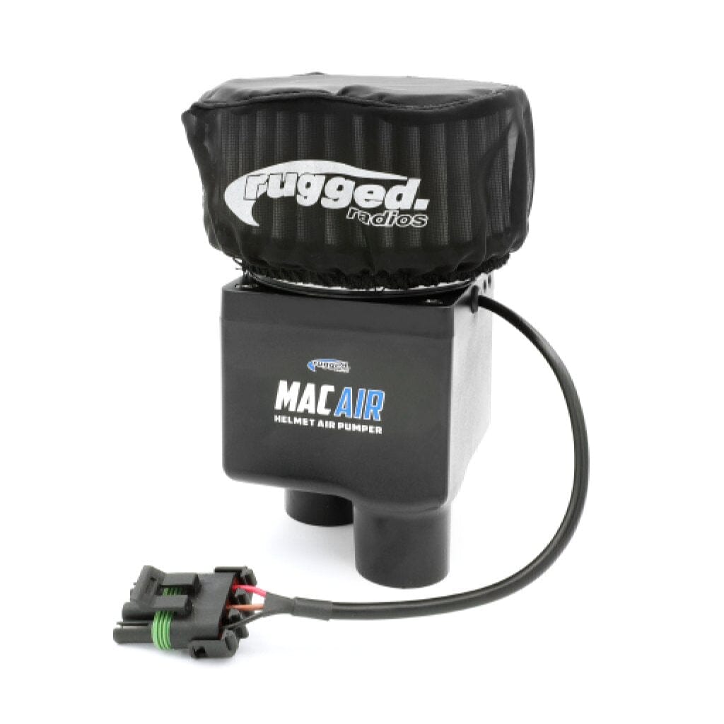

For your cab positive displacement system, check these out. As for the systems, I know people that own all of the ones listed below, I do not have a system, you don't need it when you are in front! I DO have the SB particle separator system on my cars intake and I can tell you that it works. On a trip lasting 6 days, I used to have to clean the air filter daily, replaced it after 3 days. The filters are $50. a pop. Since installing this 6 years ago, have not needed to change the filter once. the air box is almost dust free and if removed for cleaning, it is hard to see any dust/dirt. I couldn't believe it at first, I went as far as getting black poster board and tapped the filter on the board. The only thing that came out after a week of running 8000 RPM and 500 miles were small bits of sand, and not too much of that!
I already have gas masks, filters,, etc that will do much better than just a simple dust filter.
The positive pressure system add-ons for them are like $50. Thanks to Israel handing them out to their citizens like candy in the event of a chemical attack, they're readily available.
The particle separator looks interesting but dust/debris is a lot different than smoke from a wildfire, as an example.
