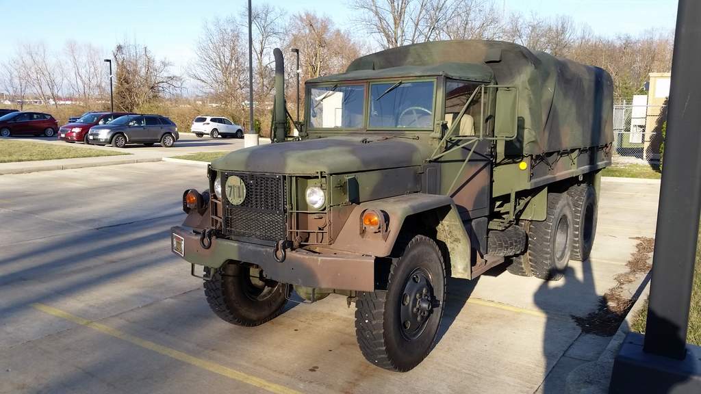

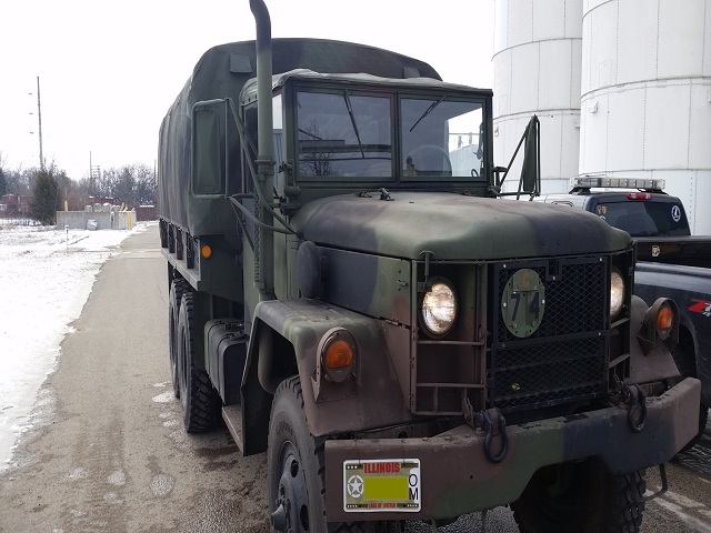

Going on 2 years as a deuce owner and realized I haven't started a thread yet. Actually purchased from another SS member. From my research and convo with the previous owner I am the 3rd or 4th owner of this machine after DRMO.
First things first, details....
1971 Kaiser Jeep M35A2. Basic truck, mutli-fuel engine, manual, no winch, troop seats, soft bed/cab tops, 2 spare Michelin tires/wheels. Runs great. Previous owner(s) added a 1 ton bed crane, spin on filter adapters under the hood (very awesome), 2 inch rear hitch receiver, 11 x 20.00 tires (GY 177s and 188s).
No big plans other than regular maintenance and some little mods. Bucket seat swap out, cargo lighting (red/white), backup lighting, add in a different horn trumpet, warning/caution stencils, and maybe a cab/bed roof tie in.

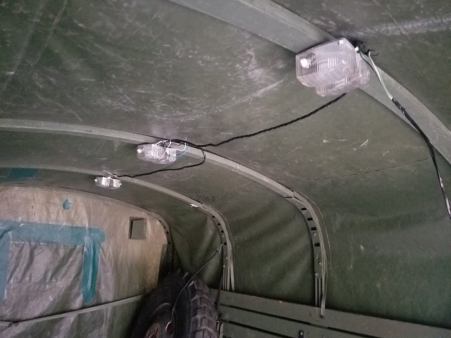

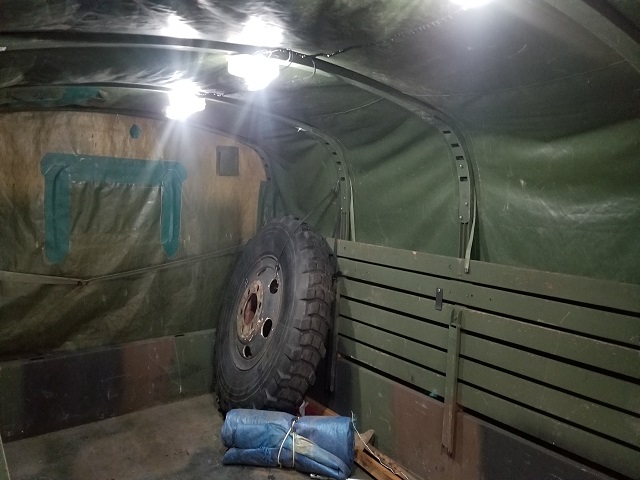

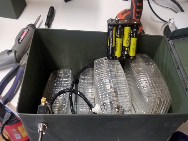

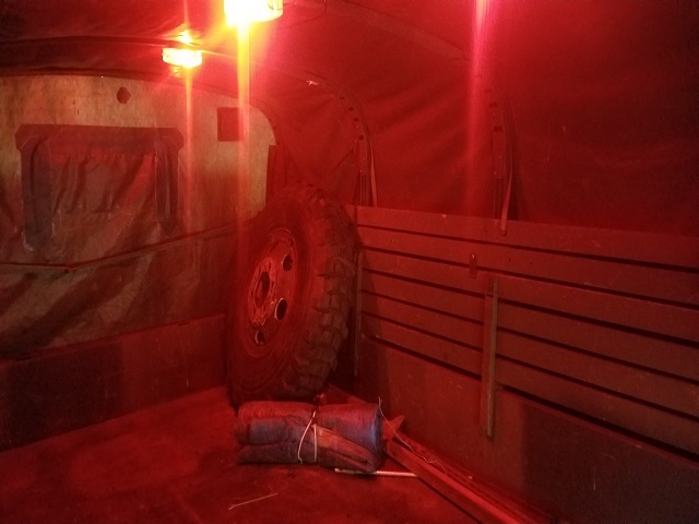

So many projects, so little time....installed some removable cargo lights this weekend. My dad found a 6 pack of 12v compartment lights while cleaning out his garage a while back. In order to make 'em work for 24v I swapped out the 12v bulbs for omnivolt LEDs (3red, 3white), a trio of round magnets, some wire, a .50cal can and boom. The heads are held in place to the bows with magnets and the whole she bang fits in the ammo can so I can take it all down and store it. They run on 10-30vdc so for now I use an 8AA battery holder (8aa=12v) to run them, but also have the option to direct wire it in to the truck if I want. It's not mil-spec or anything but makes a big difference even in the day time.

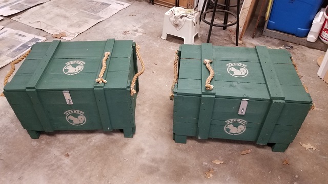

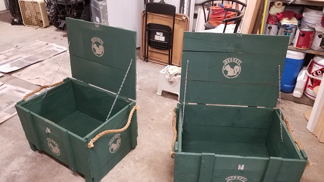

I've had a couple of medium sized shipping crates in the garage for a while. Just got around to staining/painting them up. Nothing fancy, just boxes holding extra parts, bungees, rope, tarps, chain, 2x4s, blankets, etc.

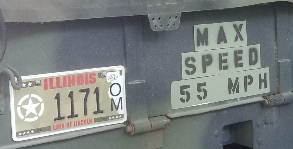

Another small update. I posted a poll in the body section about painting the safety stencils and the colors. For now I have painted up some sheet magnet in rattlecan green and dark brown.
