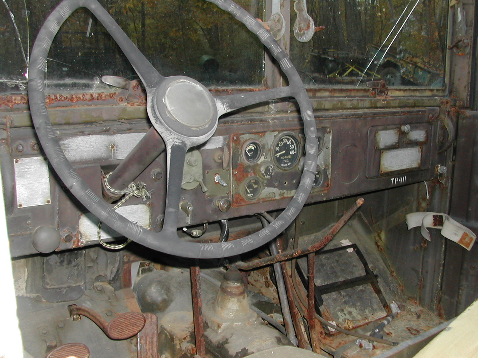

Hey, I have a 51 M37 and I was talking to a guy who has two m37. He swares that the M37 was made to only travel 35 MPH... He said he was trying to drive his 40-45 and blew the motor. Is this true? Also, I really need closeups of the dash of a correct M37. I think mine has been modified a great bit and I would like a guide to know how to correct it. Thanks!

A couple of shots of my friend Steve's restored M37's dash:
http://www.garbee.net/~cabell/Otherfollks/stevem37/112-1251_IMG.JPG
http://www.garbee.net/~cabell/Otherfollks/stevem37/113-1334_IMG.JPG
Dash on one of my unrestored trucks that is correct except for having the fording cable replaced with a toggle switch... (you can see the shadow in the paint where the dataplate for the fording cable t-handle was, plate was rectangular and fit around the hole that the handle went through).
http://www.garbee.net/~cabell/bluem37/bluem37 027.jpg
A really good explanation of what goes where on the dash are the views (photos with lables) in the Operator's Manual... (and I think it is copied in the Power Train, Body, and Frame TM as well).
