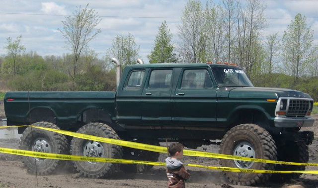

I need to put in another t-case to get some more gears. when I got in the thick deep mud I couldn't get enough wheel speed to clean the wheels. Other than that it went through everyting else pretty good.

do you know what tires and wheels this guy is running? It looks like stock duece rims and huge militart tires. am I missing something? Is this possible safely?

that truck is a LWB deuce chasis. He moved the middle axle forward so that he could fit the 16.00-20 michelin tires [(on stock deuce rims)useing 11.00-20 tubes] on with no rub. He has a 460 ford with auto trans and t-case hooked up to the stock deuce t-case. He has a locker in the front, but having problems with the sprag t-case. only reverse works.
if he has it reverse and drives around in forward. what happens?
oh safety. this truck is an off road vehicle. It gets trailered everywhere. It is safe to drive offroad at low speeds. I don't know how safe it would be on the road.
